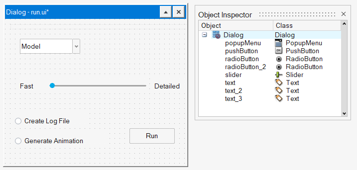

Review the objects in your design.
Note: The object names are not
to be confused with text that can be used as a label such as "Fast" and
"Detailed" that you see in the example Dialog. Text is an object itself and
is listed in the Object Inspector.

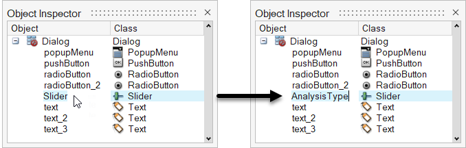

Change an object name with the following options:
Double-click an object in the Object Inspector and type in the desired
name.
Right-click an object in the Dialog or Object Inspector and select
changeObjectname from the context menu, then type
in the desired name in the microdialog.
Note: Spaces and special characters are not allowed in
object names.
The example shows the name change for the Slider object from
Slider to AnalysisType.
Name changes are
also reflected in the code when the design is saved as file.
