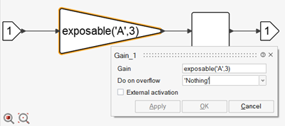

Selection using the exposable function
Using the exposable function explicitly is one way to define a parameter as
exposable. This is a simple way to define a parameter as exposable, anywhere
in the Super Block. For example, in the following Super Block, the Gain
parameter of the Gain block is defined as an
exposable parameter named A with the default value 3.
The parameter can also be defined in the Context of the diagram, as
follows:
A=exposable(‘A’,3)
and used to
define the Gain parameter value of the block. In this case, when code is
generated for the Super Block, the parameter A (the
gain value) is exposed. The second argument of the
exposable function defines the default value of
the parameter.

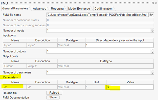

The exposing of the parameter A
and its default value is possible for example by using any of the code
generators to create a CCustomBlock or generate the
FMU of the Super Block:

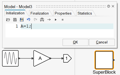

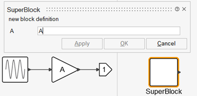

Consider the following model where the variable A is
defined in the Model Initialization script and is used inside the Super
Block (to define the parameter value of the Gain
block). If the Super Block is not masked, no parameter is exposed and
the generated code for the Super Block uses the numerical value of
A=1. It would be the same as if the value of the
parameter of the Gain block was set to 1.
The variable A in this case is not defined as an exposable parameter even
though it becomes a mask parameter if the Super Block is auto-masked
(the auto-masking operation identifies the variables used inside and
defined outside the Super Block, in this case A), as shown here:

Consider the model shown in the previous figure. The Super Block mask
parameter is A, and so is its value. In code
generation for this Super Block, A is considered
exposable, and its default value is taken to be 1. Note that A is
considered exposable because the value of the mask parameter is defined
as A and not because of the name of the mask
parameter, which also happens to be A and corresponds

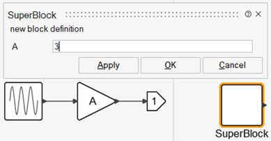

to a local variable of the Super Block. So, if the value of the mask
parameter A is defined numerically, as shown next,
prior to code generation:
then A is not exposed when the code is
generated for the Super Block.

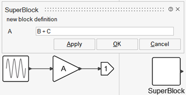

In the following example, on the other hand, where the parameter value of
A is defined as a function of other variables (B and
C in particular):

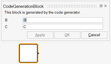

the exposed parameters are B and
C (these variables must be defined outside the
Super Block for the model to be correct). B and
C become the parameters of the new block obtained
by generating code for the Super Block:
Note that A is not exposable in this case; it is
simply a local variable of the Super Block.

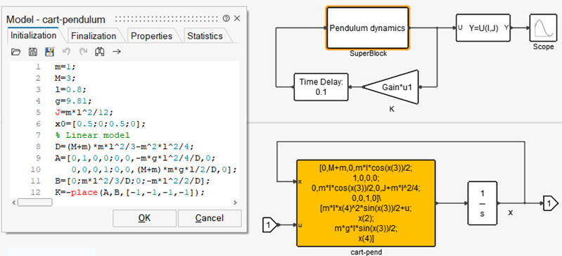

Classical Inverted Pendulum on a
Cart

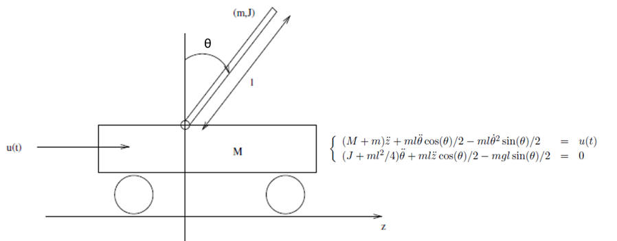

Consider the problem of the classical inverted pendulum on a cart.
The system state contains the position and speed of the cart, and the angle and
angular velocity of the pendulum. State feedback control is used to stabilize the
pendulum in the vertical upright position. The model contains a delay block for
studying the effect of control delay in the performance of the controller:
The model of the Pendulum dynamics is placed inside a Super Block. Here various
code generation methods are applied to this Super Block, illustrating how the
methods work and differ.
The Super Block has one input (force applied to the
cart) and one output (vector containing all four elements of the state). The parameters
used inside, and defined outside, are the cart and pendulum masses,
M, m, the pendulum length, l,
its moment of inertia, J, the initial state x0 (the
initial state of the Integrator block) and the gravity constant g.

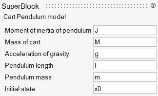

These parameters can be seen by auto-masking the Super Block:
The Super Block can now be used like a regular block, with the mask as the
parameter GUI. This GUI can be customized by editing the mask as follows:

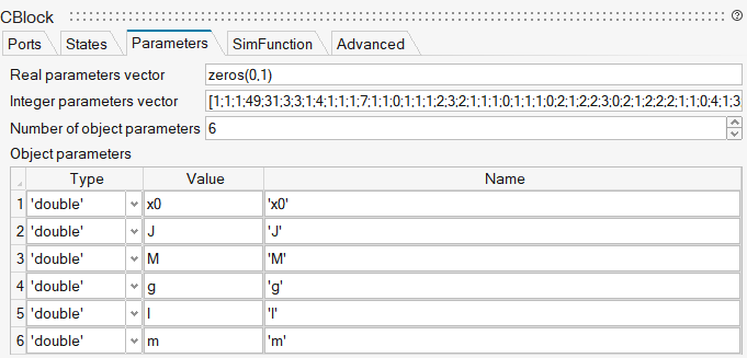

Code Generation
The application of code generation to this Super Block, as discussed
earlier, exposes all the mask parameters because their values are
defined as variables with the same names. The application of the code
generators produces a C Custom block with opar parameters
x0, J, M,
g, l and m,
as shown here in the case of the standard code generator:
The C Custom block is placed automatically in a masked Super Block with
the same parameters.

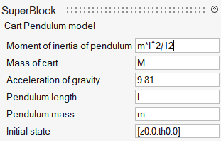

Selection of Exposable Parameters to Expose
Parameters that you would want to expose are not necessarily exactly the
parameters obtained by masking the Super Block. For example, in the
cart-pendulum system, the more natural set of parameters to expose are
m, M, l and
the initial positions. The moment of inertia is a function of the
pendulum mass and length (J=ml2/12) and g=9.81.
The full initial state is also often not required; only the initial
system positions (cart position and pendulum angles), z0 =
x0(1) and θ0 = x0
(3), are considered. To use these as exposed parameters, the
mask parameter values of the original system can be modified as
follows:
Note that the initial velocities are set to zero.

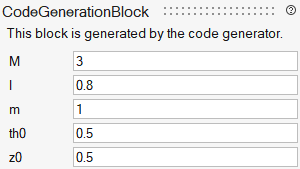

After defining initial values for z0 (z0) and
θ0(th0), for example in the Model
Initialization script, the application of code generation, as expected,
results in the following set of exposed parameters (the values of the
exposed parameters here are manually replaced by numerical values):

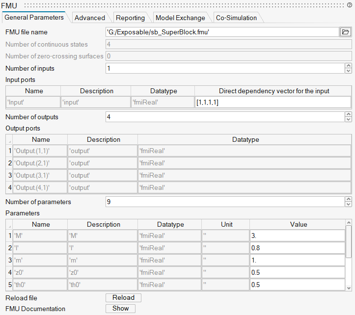

Similarly, if the Super Block is used to export an FMU, the exported FMU
will have the same parameters:
