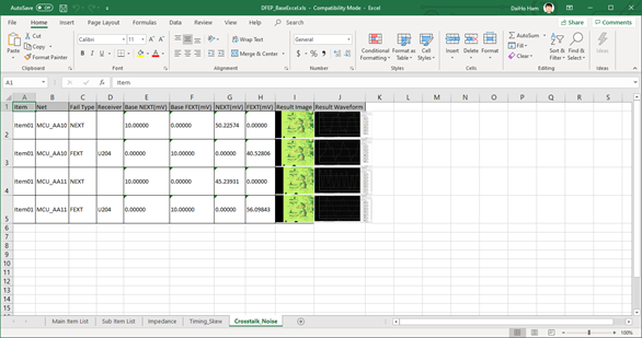

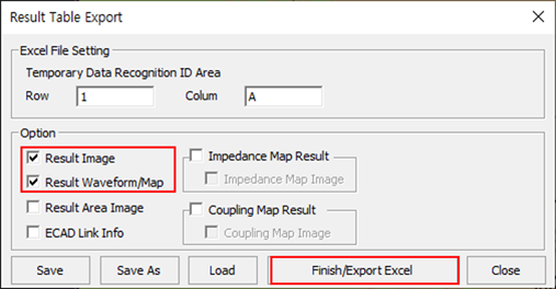

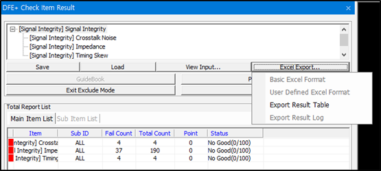

The PollEx DFE+ results can be outputted to a well-formatted MS/Excel spreadsheet.

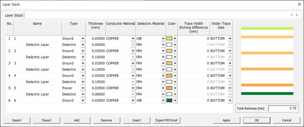

  1. From the menu bar, click Properties > Layer Stack.
    The Layer Stack Manager dialog opens.
  2. Click Import.
    The Explorer dialog opens.
  3. Find the directory path of your own stack-up files in the navigation tree section.
    You will use the training.udls file from C:\ProgramData\altair\PollEx\<version>\Examples\Verification\DFEP\Stackup. PollEx also provides a default stack-up, the path is: Install Directory\Data\Layer.
  4. Select training.udls for this 6-layer stack-up.
  5. Click OPEN to load and close the Explorer dialog.
    Your stack-up should now look as follows:
  6. Click OK to close the Layer Stack Manager dialog.

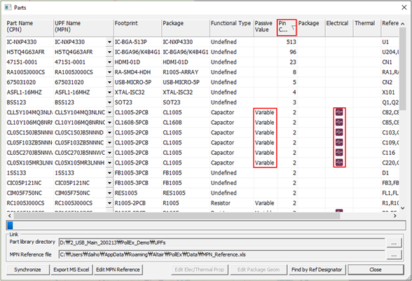

  1. From the menu bar, click Properties > Parts.
    The Parts dialog opens.
  2. Sort the result by double-clicking Pin Count.
    The passive component RLC values are automatically extracted from PDBB data, if the value property was correctly assigned in the PDBB database. The passive value types of the passive component are classified into variable and fixed.
    • Fixed: Use the passive value defined in UPE. You cannot change the value.
    • Variable: You can assign the passive component value using the Properties-Components menu.

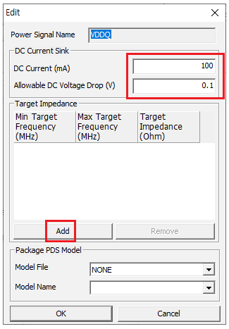

  4. Setup Power Information.
    1. Click Power Rails.
      The Power Rail dialog displays. All the power rails used for this component are displayed in the middle of this dialog.
    2. Click the VDDQ power rail.
      Figure 4.
      The Edit dialog opens.

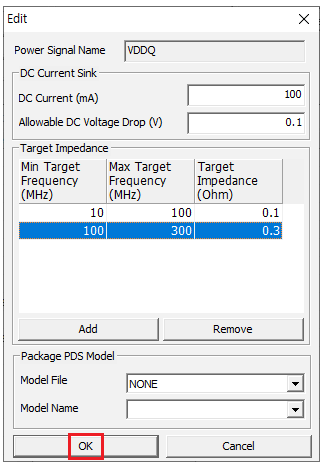

    3. Enter 100 for the DC Current.
    4. Enter 0.1 for the Allowable DC Voltage Drop.
      Your settings should now look as follows:
      Figure 5.
    5. Click Add to setup Target Impedance.
      The first row of the target impedance field is added.
    6. Enter 10 for the Min Target Frequency.
    7. Enter 100 for the Max Target Frequency.
    8. Enter 0.1 for the Target Impedance.
    9. Click Add.
      The second row of the target impedance field is added.
    10. Enter 100 for the Min Target Frequency.
    11. Enter 300 for the Max Target Frequency.
    12. Enter 0.3 for the Target Impedance.
      Figure 6.
    13. Click OK to close the Edit dialog.

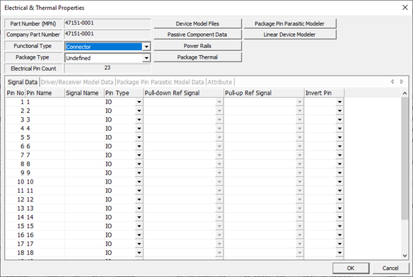

  1. Double-click the part 47151-0001 in the dialog invoked by clicking Properties > Parts.
    The Electrical & Thermal Properties dialog opens.
  2. Select Connector for the Functional Type.
    Figure 8.
  3. Click OK to close the Electrical & Thermal Properties dialog.
  4. Double-click the part 675031020 in the dialog.
  5. Select Connector for the Function Type.

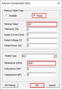

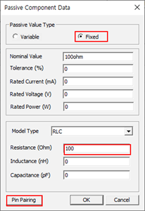

Assign Passive Component Data to R and C
  1. Double-click the part RC1005J101CS in the Parts dialog.
    The Electrical & Thermal Properties dialog displays.
  2. Click Passive Component Data in the Electrical & Thermal Properties dialog.
    The Passive Component Data dialog opens.
  3. For Passive Value Type, select Fixed.
  4. Enter 1K for Nominal Value.
  5. Enter 1000 for the Resistance (ohm).
    Figure 9.
  6. Click OK to close the Passive Component Data dialog.
  7. Click OK to close the Electrical & Thermal Properties dialog.

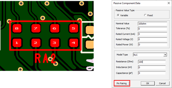

Assign Passive Component Data to Array R and C
When a passive is an array component, you need to define the pin pair configuration.
Figure 10.
  1. Double-click the RA1005J000CS part that has more than two pins in the Parts Dialog.
  2. Click for the Functional Type and select Resistor.
  3. Click Passive Component Data in the Electrical & Thermal Properties dialog.
  4. For Passive Value Type, select Fixed.
  5. Enter 100 ohm for the Resistance.
    Figure 11.

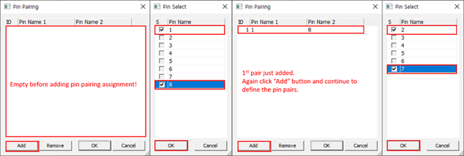

  6. Click Pin Pairing in the Passive Component Data dialog to open the Pin Pairing dialog.
  7. Click Add to define pin pairs.
    The specified passive component values are assigned separately to these paired pins.
    Figure 12.

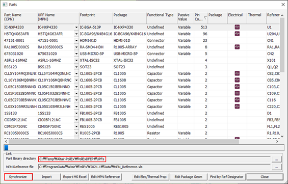

Link the unified parts.
    The Parts Manager dialog opens.
  2. Click in the Part library directory menu.
  3. To explore the library path for the unified parts, select the Part folder and then click OK.
    UPF path: C:\<working directory>\Part
  4. Click Synchronize to start assigning the part properties.
    Figure 13.
    Content names under the UPF Name column denotes that the UPF file exists under the local Parts folder for those parts.
    • The icon under the Package column denotes that 3D package geometry is linked with the unified part.
    • The icon under the Electrical column denotes that the electrical buffer model is called from the unified part.
    • The icon under the Thermal column denotes that thermal information is called from the unified parts.
  5. Click Close to close the Parts dialog.

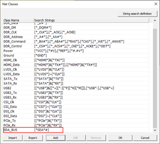

Add New Class Item
  1. From the menu bar, click Properties > Net Classes.
    The Net Classes dialog opens.
  2. Click Add.
    The ADD dialog opens.
  3. Enter the net class name SDA_BUS in the net Class Name field and type search string *SDA*# in the Search Strings field.
  4. Click Add String.
  5. Click OK to close the ADD dialog.
    The SDA_BUS net class is registered in the Net Classes dialog.
    Figure 14.
  6. Click OK to close the Net Classes dialog.
  7. From the menu bar, click Properties > Nets.
    The Nets dialog opens.
  8. Click Find Net Class to assign net class using the pre-defined net class file.
    Three nets are classified as SDA_BUS net class.

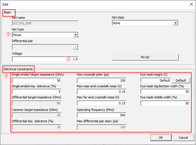

Assign Net Properties for Power
  1. From the menu bar, click Properties > Nets.
    The Nets dialog displays.
  2. Double-click VCC1P5_DDR.
    The Edit dialog displays.
  3. Select the Net Type as Power, enter 1.5 for the Voltage, and click OK.
    Figure 15.

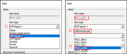

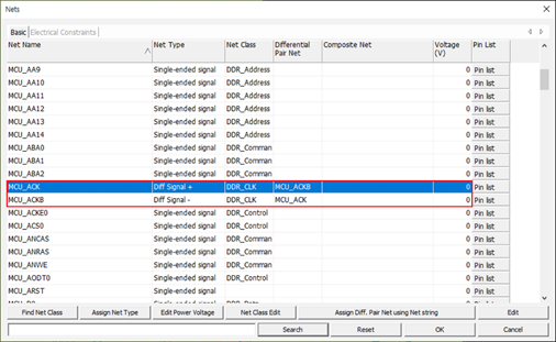

Assign Net Properties for Differential Pair
  1. Double-click MCU_ACK.
  2. Change the Net Type to Diff Signal +.
  3. Select the other pair net MCU_ACKB as Diff Signal using the scroll bar.
    Figure 16.
  4. Click OK to close the Edit dialog.
    You will find that the MCU_ACK net and MCU_ACKB net are combined as a differential pair net.

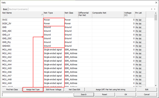

Assign Net Properties Automatically
  2. Click Assign Net Type.
    The PollEx DFE+ sets the properties for all nets automatically using net information described in IBIS files and property.
    Figure 18.
  3. Click OK to close the Nets dialog.

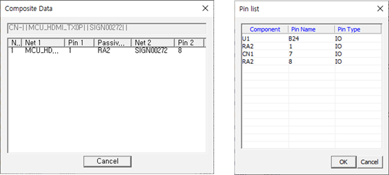

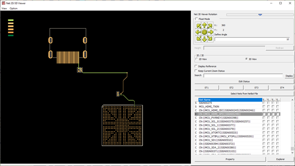

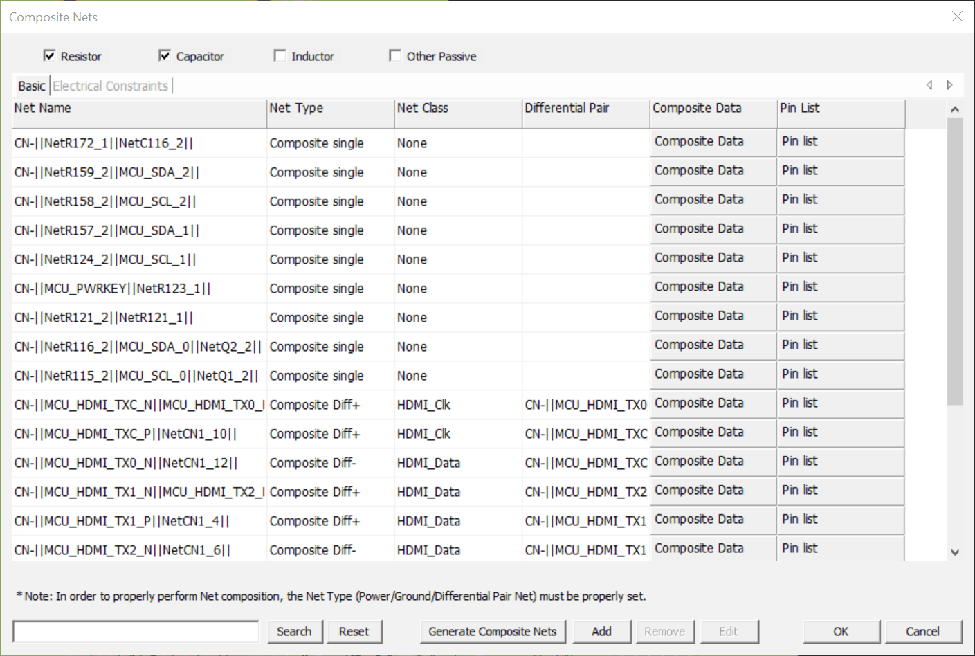

Create Composite Net
  1. From the menu bar, click Properties > Composite Nets.
  2. Activate the Resistor and Capacitor checkboxes.
  3. Click Generate Composite Net.
    You can specify nets that should not be composited with other nets such as Power and Ground nets.
    The Selects Nets to Exclude dialog opens.
  4. Click OK and check the listed composited nets.
    Figure 19.
    If you click Composite Data or Pin List, you can review composite net structure or pin list. If you want to check the total net composition status for the composited nets, use the Tools > Net 2D/3D Viewer menu.
    Figure 20.
  5. Select the composite net CN-||MCU_HDMI_HPD||NetCN1_19||.
    The secondly listed composited net above configured with MCU_HDMI_HPD and NetCN1_19 displays at the beginning of this composite net chapter having R85 resistor.
    Figure 21.
  6. Close the Net 2D/3D Viewer dialog.

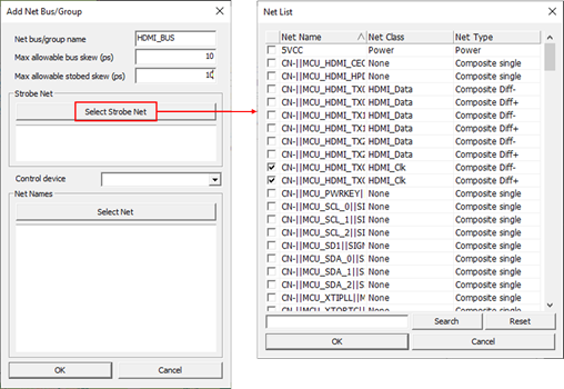

Create HDMI Bus Group
  1. From the menu bar, click Properties > Net Buses/Groups.
    The Net Buses/Groups dialog opens.
  2. Click Generate DDR Buses.
    The DDR Bus groups is automatically generated.
  3. Click Add to generate a new bus group.
    The Add Net Bus/Group dialog opens.
  4. Enter HDMI_BUS in the Net bus/group name field.
  5. Enter 10 in the Max allowable bus skew(ps) field.
  6. Enter 10 in the Max allowable strobed skew(ps) field.
  7. Click Selected Strobe Net to select strobe net.
    The Net List dialog opens.
  8. Select the CN-||MCU_HDMI_TXC_N|| and CN-||MCU_HDMI_TXC_P|| nets as a strobe net.
  9. Click OK to close this dialog.

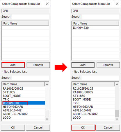

  2. Define CPU component group.
    1. In the Component Group Type section, click Component Group01 and change the group name to CPU by double-clicking the Name column.
    2. In the Type section, select PART from the drop-down menu.

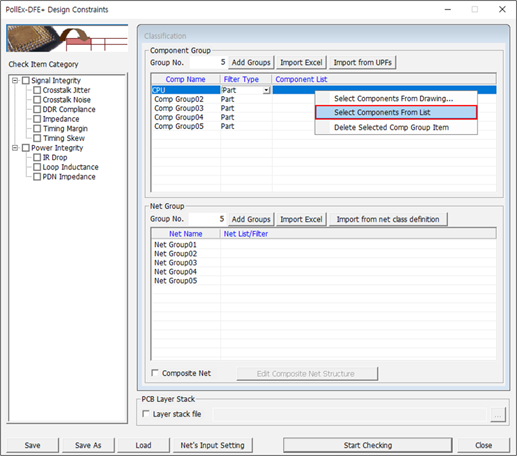

    3. Click the CPU component group that was created and select Select Components from List from the context menu.
      Figure 23.
      The Select Components from List dialog opens.
    4. Select the IC-NXP4330 component from the part name list in lower section.
    5. Click Add to add selected component to selected item.
      Figure 24.
    6. Click OK.

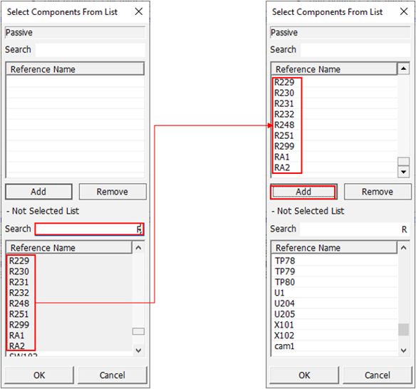

  3. Define Passive component group.
    1. In the Component Group Type section, click Component Group02 and change the group name to Passive by double-clicking the Name column.
    2. In the Type section, select Reference from the drop-down menu.
    3. Click the Passive component group that was created and select Select Component from List from the context menu.
      The Select Components from List dialog opens. This menu will show you the reference name list.
    4. Enter R in the search field, select the Resistor component, and click ADD.
      The highlighted items will be moved to Reference name field.
      Figure 25.

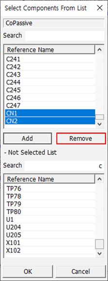

    5. Enter C in the search field, select the Capacitor component, and click ADD.
    6. In the Reference Name field, select CN1 and CN2 and click Remove.
      Figure 26.
    7. Enter FB in the search field, select the Inductor or bead component, and click ADD.
      The highlighted items are moved to the Reference name field.
    8. Enter TP in the search field, select the test-point component, and click ADD.
      The highlighted items are moved to Reference name field.
    9. Click OK to close Select Component From List dialog.

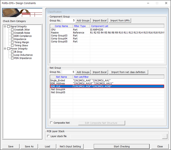

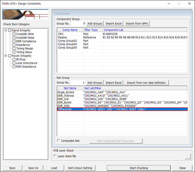

Define Net Group

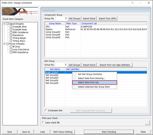

  1. Define Single-Ended net group.
    1. In the Net Group section, double-click Net Group01 and change the group name to Single_Ended by double-clicking the Name column.
    2. In the Type section, select Net from the drop-down menu.

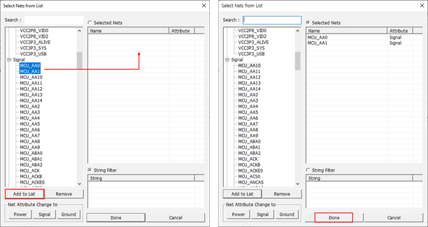

    3. Click the Single_Ended net group that was created and select Select Nets From List from the context menu.
      Figure 27.
      The Select Net from List dialog opens.
    4. Select the MCU_AA0 and MCU_AA1 nets from the signal net list.
    5. After net selection, click Add to List to add the selected net list to the selected item.
      Figure 28.
    6. Click Done to close this window.
  2. Define DDR_Address net group.
    1. In the Net Group section, double-click Net Group02 and change the group name to DDR_Address by double-clicking the Name column.
    2. Click the DDR_Address net group that was created and select Select Net List from the context menu.
    3. Select the MCU_AA10 and MCU_AA11 nets from the signal net list.
    4. Click Add to List to add the selected net list to the selected item.
    5. Click Done to close this window.
  3. Define DDR_CLK net group.
    1. In the Net Group section, double-click Net Group03, and change the group name to DDR_CLK by double-clicking the Name column.
    2. Click the DDR_CLK net group that was created and select Select Net From List from the context menu.
    3. Select the MCU_ACK and MCU_ACKB nets from the signal net list.
      In the Net Group section, your net group setting should now look as follows.
      Figure 29.

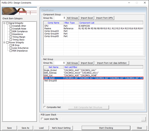

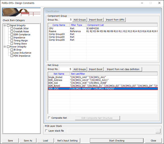

  4. Define DDR_Byte0 net group.
    1. In the Net Group section, double-click Net Group04, and change the group name to DDR_Byte0 by double-clicking the Name column.
    2. Click the DDR_Byte0 net group that was created and select Select Net From List from the context menu.
    3. Select MCU_D0 ~ MCU_D7 from signal net list.
      In the Net Group section, your net group setting should now look as follows:
      Figure 30.
  5. Define DDR_DQS net group.
    1. In the Net Group section, double-click Net Group05, and change the group name to DDR_DQS by double-clicking the Name column.
    2. Select the DDR_DQS net group that was created and select Select Net From List from the context menu.
    3. Select the MCU_NADQS0 and MCU_PADQS0 nets from the signal net list.
      Figure 31.
  6. Define Differential net group.
    1. To add a line to the Net Group table, enter 1 in the Group No. field, and click Add Groups.
      An additional line is added in the Net Group table.
    2. In the Net Group section, double-click the newly added line, and change the group name to Differential by double-clicking the Name column.
    3. Click the Differential net group that was created and select Select Net From List from the context menu.
    4. Select the MCU_HOST_USB- and MCU_HOST_USB+ nets from the signal net list.
    5. Click Add to List to add the selected net list to the selected item.
      Figure 32.

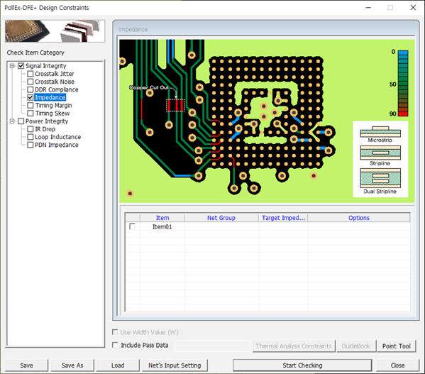

Check Impedance

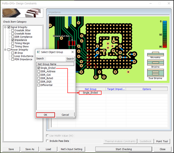

  1. Enable the Impedance checkbox.
    The PollEx-DFE+ Design Constraints dialog opens.
    Figure 33.
  2. Set Impedance test condition.
    1. Double-click the Net Group field of the first item.
      The Select Object Group dialog box opens.
    2. Select the Single_Ended net group and click OK.
      Figure 34.

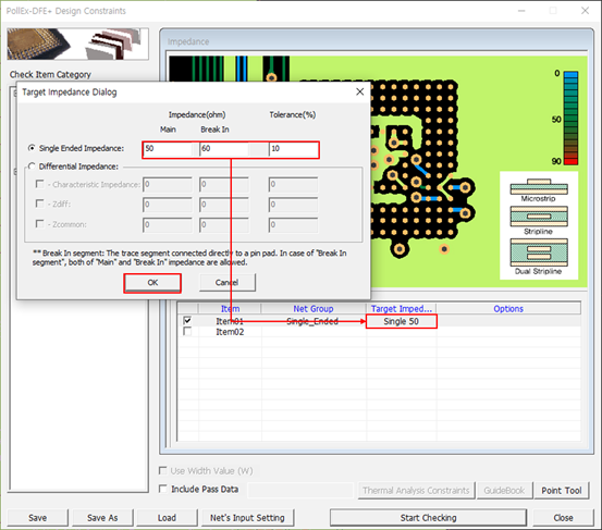

    3. Double-click the Target Impedance field of the first item.
      The Target Impedance dialog opens.
    4. Enter 50 for Main.
    5. Enter 60 in the Break In.
    6. Enter 10 in the Tolerance.
    7. Click OK.
      Figure 35.
    8. Double-click the Option field of first item.
      The Option dialog opens.
    9. For Plane Option, select Real.
      Figure 36.
    10. Click OK to close this dialog.
      With this setting, PollEx DFE+ will check if the impedance of MCU_AA0 and MCU_AA1 signal is within target impedance range.

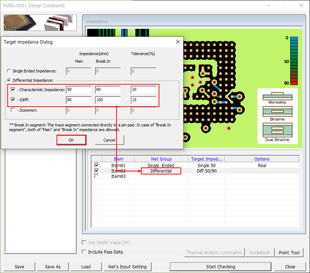

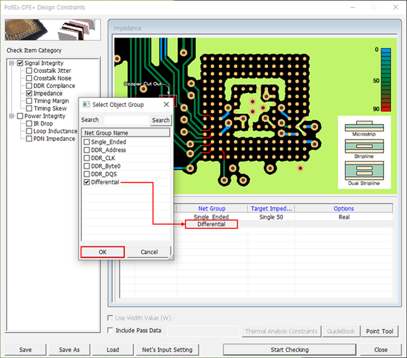

  3. Define differential net impedance check condition.
    1. Double-click the Net Group field of the second item.
      The Select Object Group dialog opens.
    2. Select the Differential net group and click OK.
      Figure 37.
      The Target Impedance dialog box opens.
  4. Setup Characteristic impedance of differential line.
    1. Enter 50 for Main.
    2. Enter 60 for Break In.
    3. Enter 10 for Tolerance.
  5. Setup Differential impedance of differential line.
    1. Enter 90 for Main.
    2. Enter 100 for Break In.
    3. Enter 15 for Tolerance.
    4. Click OK.
      Figure 38.

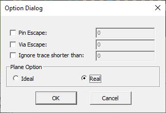

    5. Double-click the Option field of the first item.
    6. For Plane Option, select Real.
      Figure 39.
    7. Click OK.
      With this setting, PollEx DFE+ will check if the differential impedance of MCU_HOST_USB- and MCU_HOST_USB+ differential pair is within target impedance range.

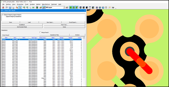

  6. Run Impedance Item and review Check Result.
    1. Click Save As and save the input file as training.DFEPI in the PollEx DFEP folder under the job folder.
      You can reload this input setup condition by clicking Load.
    2. Click Start Checking.
      PollEx DFE+ starts checking for selected checking items. PollEx DFE+ changes the window for results display.

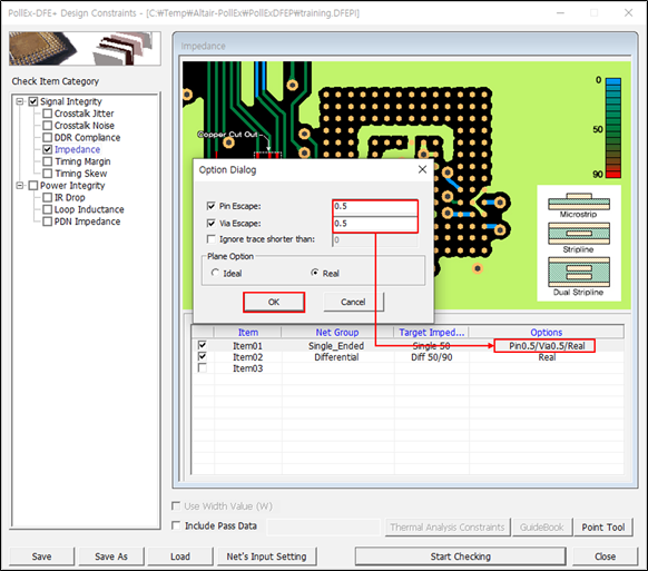

    3. In the Result tab, select [Signal Integrity] Impedance and choose the first error checking item.
      Figure 40.
      By reviewing the image window on the right, we can see that this kind of error can’t be fixed by modifying the design. This kind of error can be excluded from the error list by using check option.
    4. In the result tab window, click View Input.
      The PollEx DFE+ Design Constraints dialog opens.
    5. In the Check Item Category section, click the Impedance item to set the test condition.
      The Impedance item rule entry dialog opens.
    6. Double-click the Options field of the first item.
    7. Enable the Pin Escape checkbox and enter 0.5 in the value field.
    8. Enable the Via Escape checkbox and enter 0.5 in the value field.
      Figure 41.
    9. Click OK to close Option dialog.
    10. Click Start Checking.
      PollEx DFE+ prompts you to save current input file status or not.
    11. Click Save.
      PollEx DFE+ starts checking with new input condition.
    12. In the result tab, select Impedance and review the result item.
      The previous 1st case error is removed.
    13. Select other checked items and review the results.

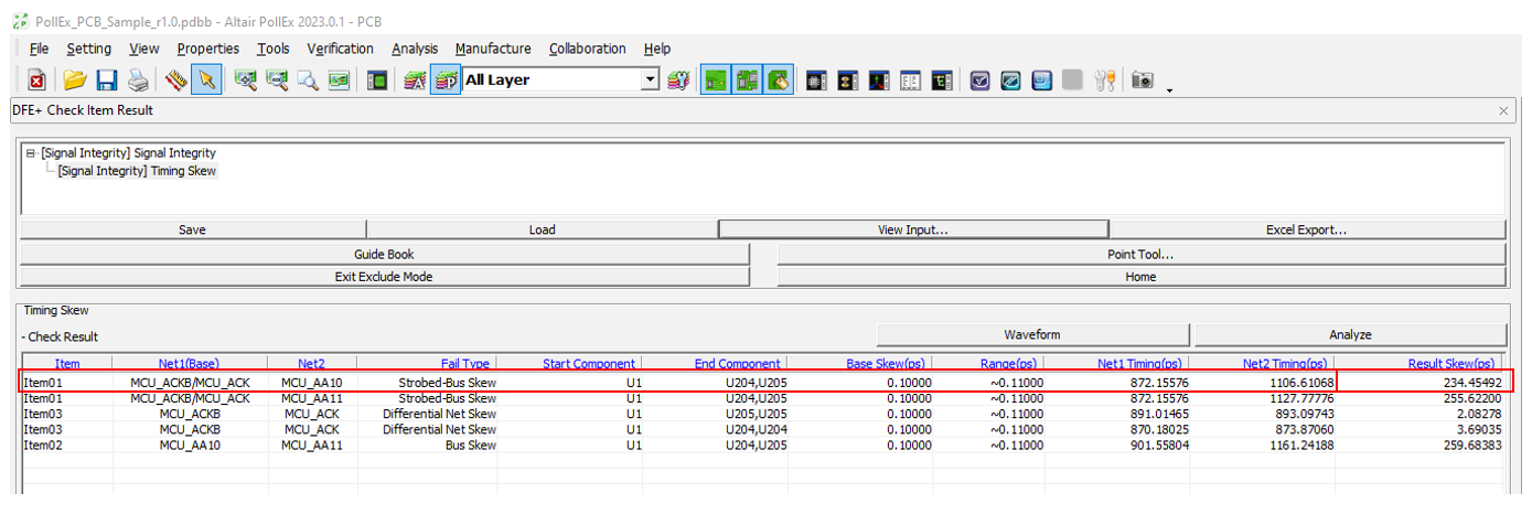

  1. Preview Timing Skew item.
  2. In the result tab window, click View Input.
  3. Enable the Timing Skew checkbox in the Check Item Category list.
    The Timing Skew Item Rule Entry dialog opens.
  4. Strobed BUS Skew check setup.
    1. In the Timing Skew Input Setup dialog, click the Check Type field of Item01 and select Strobed BUS Skew.
    2. In the Timing Skew Input Setup dialog, click the Net Group field to select the target net from the net group list.
    3. Select the DDR_Address net group as a target net group and click OK.

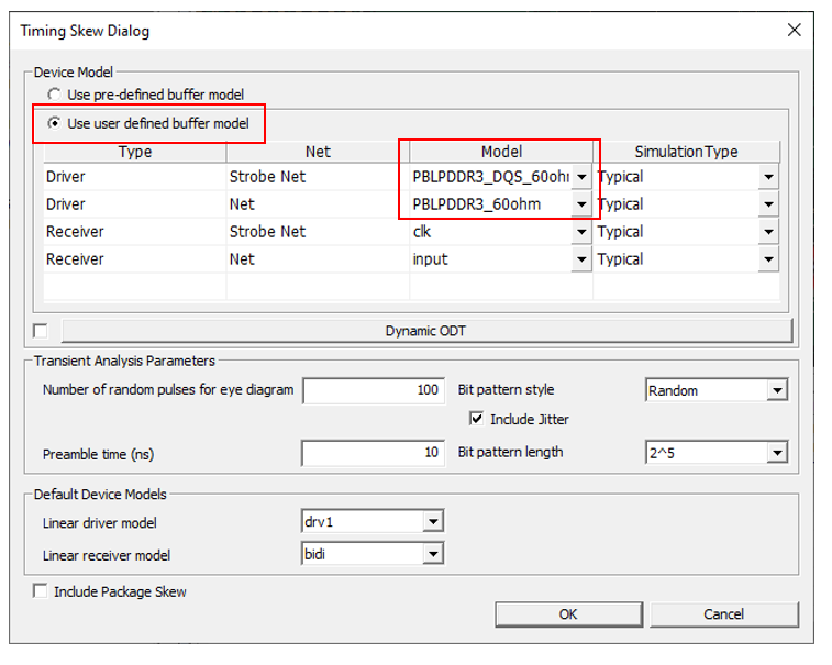

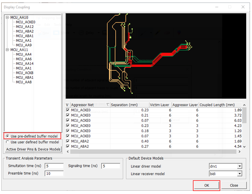

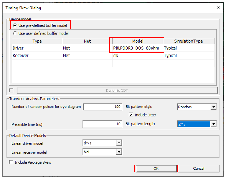

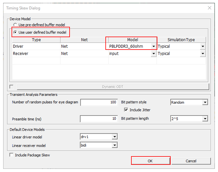

    15. Click the Analyze Option field in the Timing Skew Input Setup dialog to setup simulation environment.
      The Timing Skew dialog opens. You can change the actual driver pin model among selectable models.
      Figure 42.
    16. Select Use user defined buffer model.
      If you check Use pre-defined buffer model, default Driver and Receiver models from UPE will be used.
    17. In the Model field for Strobe Net, click and select PBLPDDR3_DQS_60ohm.
    18. In the Model field for Net, click and select PBLPDDR3_60ohm.
    19. In the Model field for Receiver Strobe Net, click and select clk.
    20. In the Model field for Receiver Net, click and select input.
    21. Click OK to close Timing Skew dialog.

    12. Click the Analyze Option field to setup the simulation environment.
      Figure 43.
    13. Select Use user defined buffer model.
      If you check the Use pre-defined buffer model, default Driver and Receiver models from UPE will be used.
    14. In the Model field for Driver Net, click and select LBLPDDR3_60ohm.
    15. In the Model field for Receiver Net, click and select input.
    16. Click OK to close the Timing Skew dialog.

    12. Click the Analyze Option field to setup a simulation environment.
      Figure 44.
    13. Click Use pre-defined buffer model.
      The default Driver and Receiver models from UPE will be used.
    14. Click OK to close Timing Skew dialog.

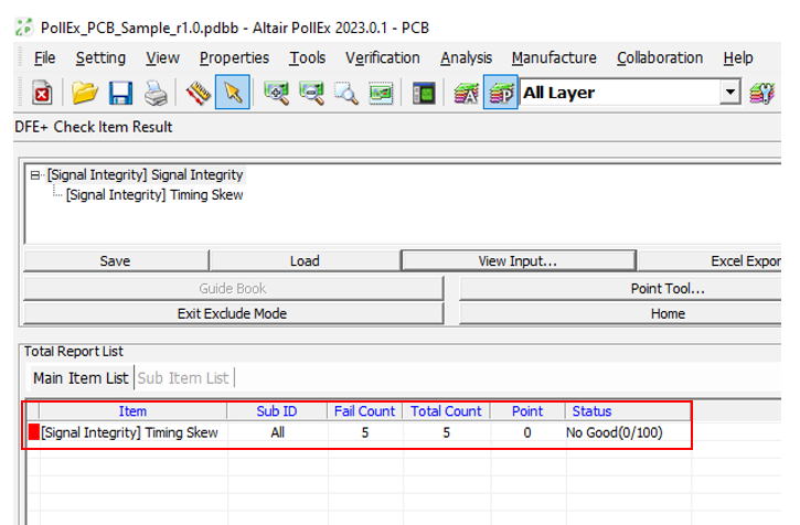

      PollEx DFE+ starts checking for selected checking items. After running, PollEx DFE+ changes the window for results display.
    5. In the result tab, click the [Signal Integrity] Signal Integrity item to see the detailed result.
      Figure 46.
  8. Review the Timing Skew Check Result.
    1. In the result tab, select [Signal Integrity] Timing Skew to see the detail result.
      Figure 47.
      In the left side of the window, you can see the error status. The strobed timing skew between MCU_AA10 and MCU_ACK strobe signal is bigger than our limit 0.1ps, so it fails. (The exact result values may vary slightly depending on the solver update.)
    2. Choose the first error checking item of this section.
      The MCU_AA10and MCU_ACK nets are highlighted in right side window. The Waveform Viewer dialog opens.
    3. Click Close.
    4. Select the first error item and click Analyze.
      The Network Analysis dialog opens. You can modify the simulation parameter or change the topology to resolve this problem. Refer to the SI or SI Tutorial for more details.
    5. Click Close.

  1. In the result tab window, click View Input.
  2. Enable the Crosstalk Noise checkbox in the Check Item Category list.
  3. Set Crosstalk Noise check condition.
    1. Click the Net Group field in the Crosstalk Noise Input Setup dialog to select a target net from net group list.
    2. Select the DDR_Address net group as a target net group and click OK.
    3. Click FEXT(mV).
    4. Click the FEXT(mV) field in the Crosstalk Noise Input Setup dialog and enter 10.
    5. Click NEXT(mV).
    6. Click the NEXT(mV) field and enter 10.
    7. Click the Analyze Option field to setup a simulation environment.
      The Display Coupling dialog opens.
    8. Select Use pre-defined buffer model.
    9. Click OK to close the Display Coupling dialog.
      Figure 48.

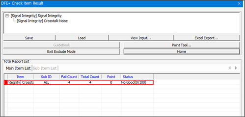

  4. Check Crosstalk Noise item.
    1. Disable the Impedance and Timing Skew checkboxes in the Check Item Category section.
    2. Enable the Crosstalk Noise checkbox.
      Figure 49.
    3. Click Start Checking.
    4. Click Save to save current setup.
      PollEx DFE+ starts checking for selected checking items. After running, PollEx DFE+ changes the window to results display.

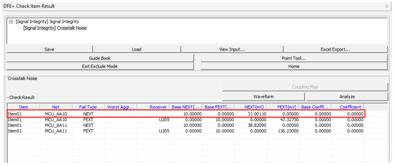

    5. In the result tab, click [Signal Integrity] Crosstalk Noise to see the detailed result.
      Figure 50.
  5. Review the Crosstalk Noise Check Result.
    1. In the result tab, select [Signal Integrity] Crosstalk Noise to see the detail result.
      Figure 51.
      In the left side of the window, you can see the error status. The amount of near-end crosstalk noise for the victim net MCU_AA10 is bigger than the 10mV limit, so it fails. (The exact result values may vary slightly depending on the solver update.)
    2. Click the first error checking item of this section.
      The victim net MCU_AA10 net is highlighted in right side window. The Waveform Viewer dialog opens.
    3. Click Close.
      The Crosstalk Analysis dialog opens. You can modify simulation parameters, topology, or driver strength to resolve this problem. Refer to SI or SI Tutorial for more details.
    5. Click Close.
Create Excel Report for Result
  1. In the result tab, click View Input.
  2. Enable the Impedance, Timing Skew, and Crosstalk Noise checkboxes.
    Figure 52.
  4. Click Save.
  5. Click Save.
    We can read this result file using the Option > DFE+ > Result menu.
  6. Click Excel Export and select Export Result Table from the context menu.
    Figure 53.
    The Result Table Export dialog opens.
  7. Enable the Result Image checkbox.
  8. Enable the Result Waveform checkbox.
  9. Click Finish/Export Excel to start Excel report creation.
    Figure 54.
    PollEx DFE+ begins generating an Excel report. After running, PollEx DFE+ shows the Excel report file.
    Figure 55.
  10. Save this Excel file.
    Keep a sample Excel format file for future use.
