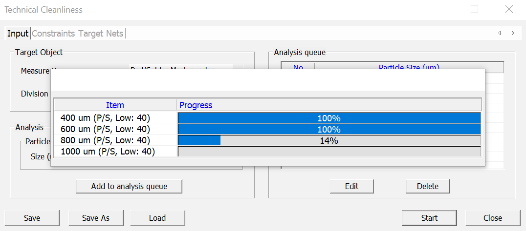

  3. Execute Technical Cleanliness Input.
    1. Click Verification > Technical Cleanliness > Input.
    2. Click Load and select the PollEx_Sample_r1.0.teci file located at C:\ ProgramData\altair\PollEx\<version>\Examples\Verification\TechnicalCleanliness.
    3. Click Start to run the Analysis.
      PollEx TC checks where the design’s data input rules and constraints apply.
      Figure 1. Technical Cleanliness Analysis

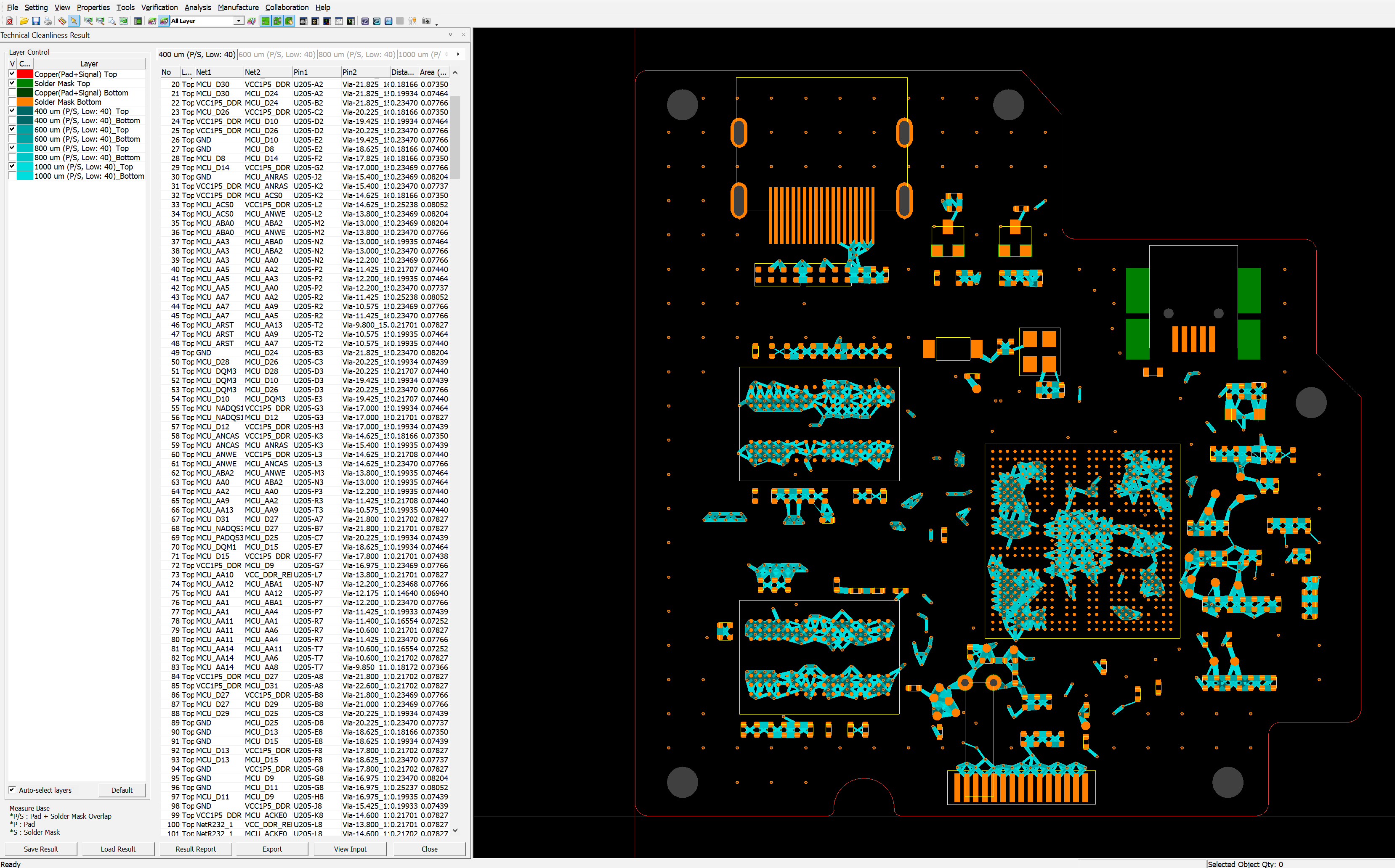

  4. Check the results.
    The test results are displayed on the screen (Particle size & locations) after analysis.
    Figure 2. Technical Cleanliness Result

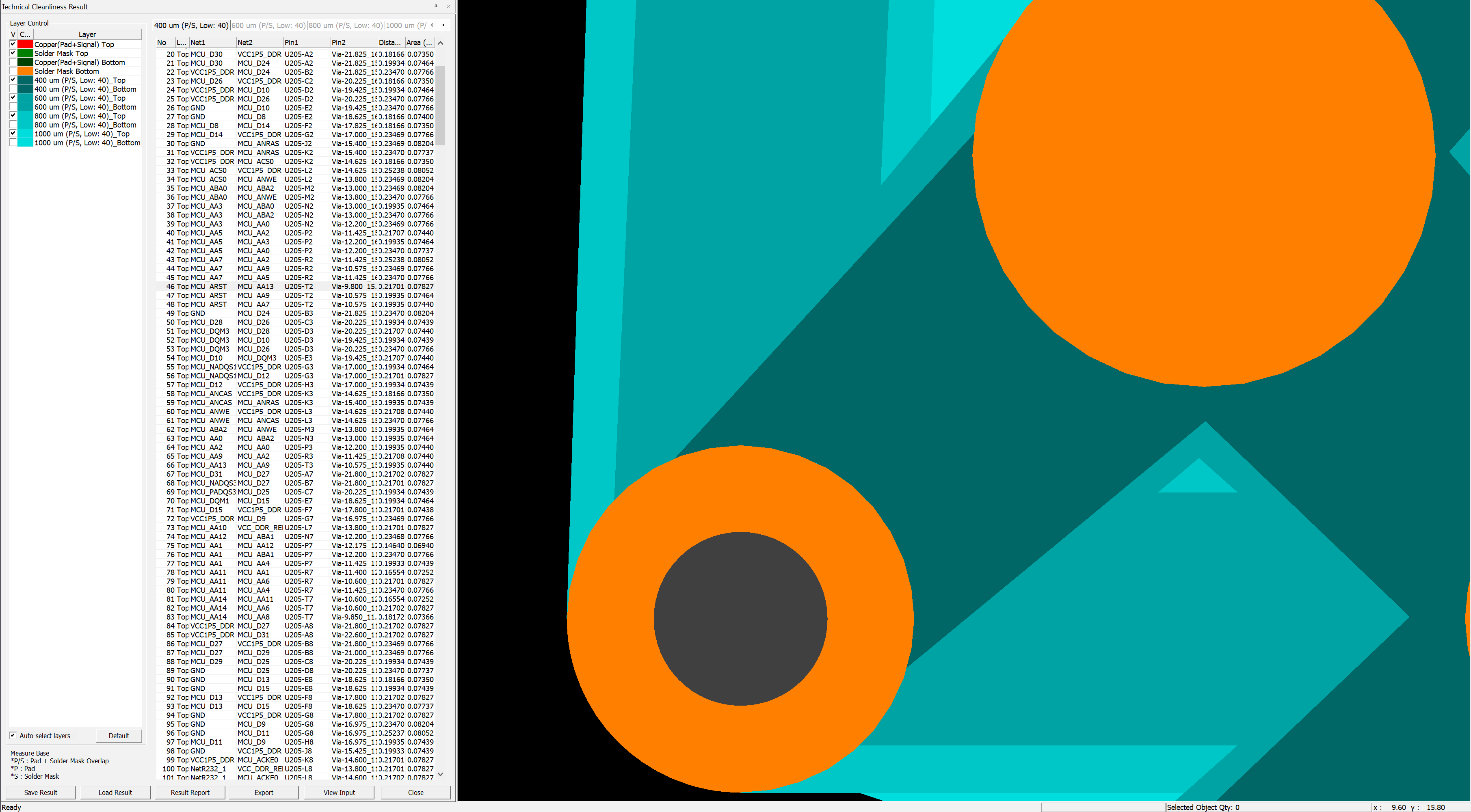

  5. Click the 400um(low) particle size.
    In the result dialog bar, you can check detailed list information of NETS and PINS, as well as its DISTANCE and AREA. When you click an item from the list, it displays the highlighted location with its associated layers.

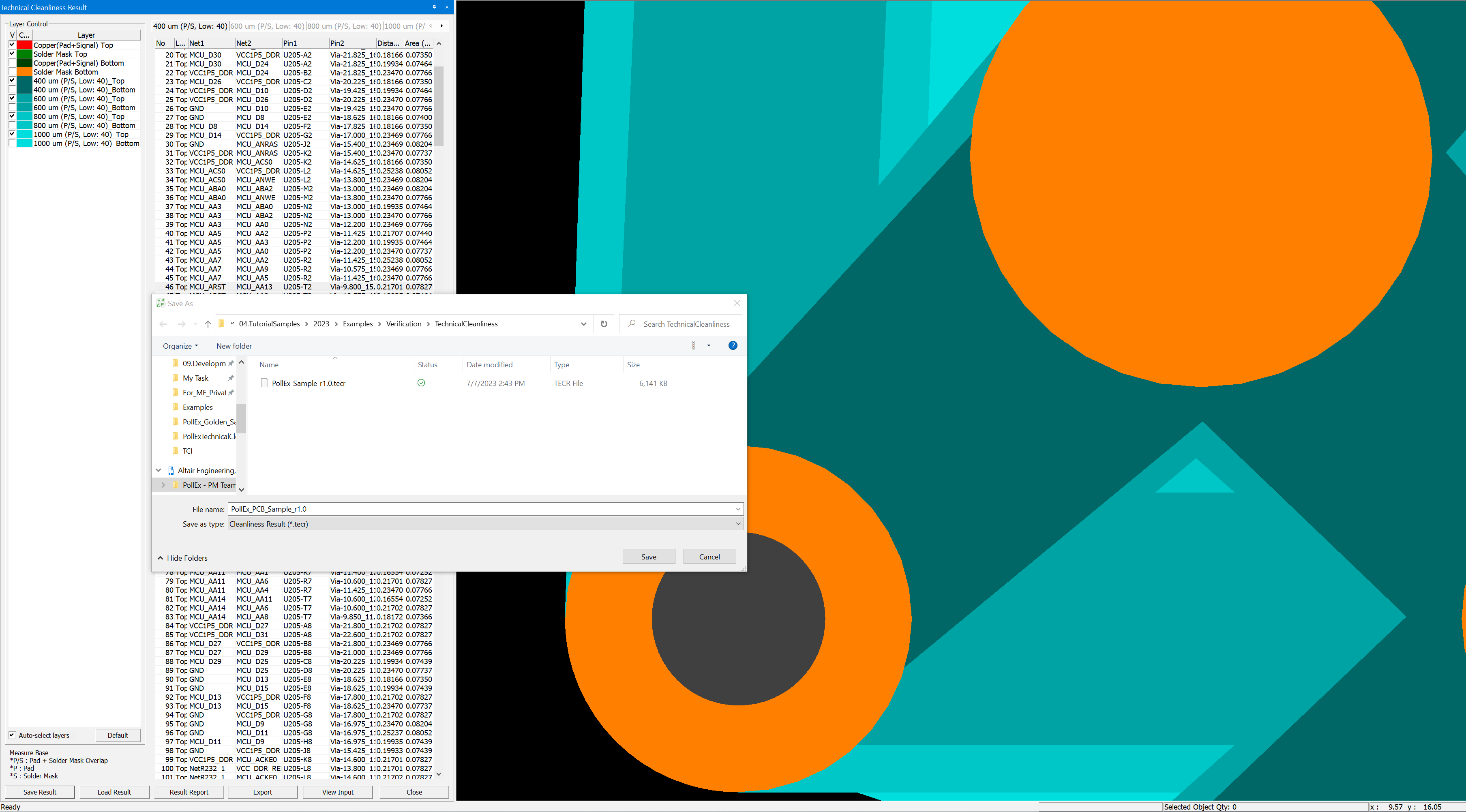

  6. Save Test result.
    1. Click Save Result > Pollex_PCB_Sample_r1.0 > Save.
    2. To view, click Load Result and open the Pollex_PCB_Sample_r1.0.tecr file located at: C:ProgramData\altair\PollEx\<version>\Examples\Verification\TechnicalCleanliness.

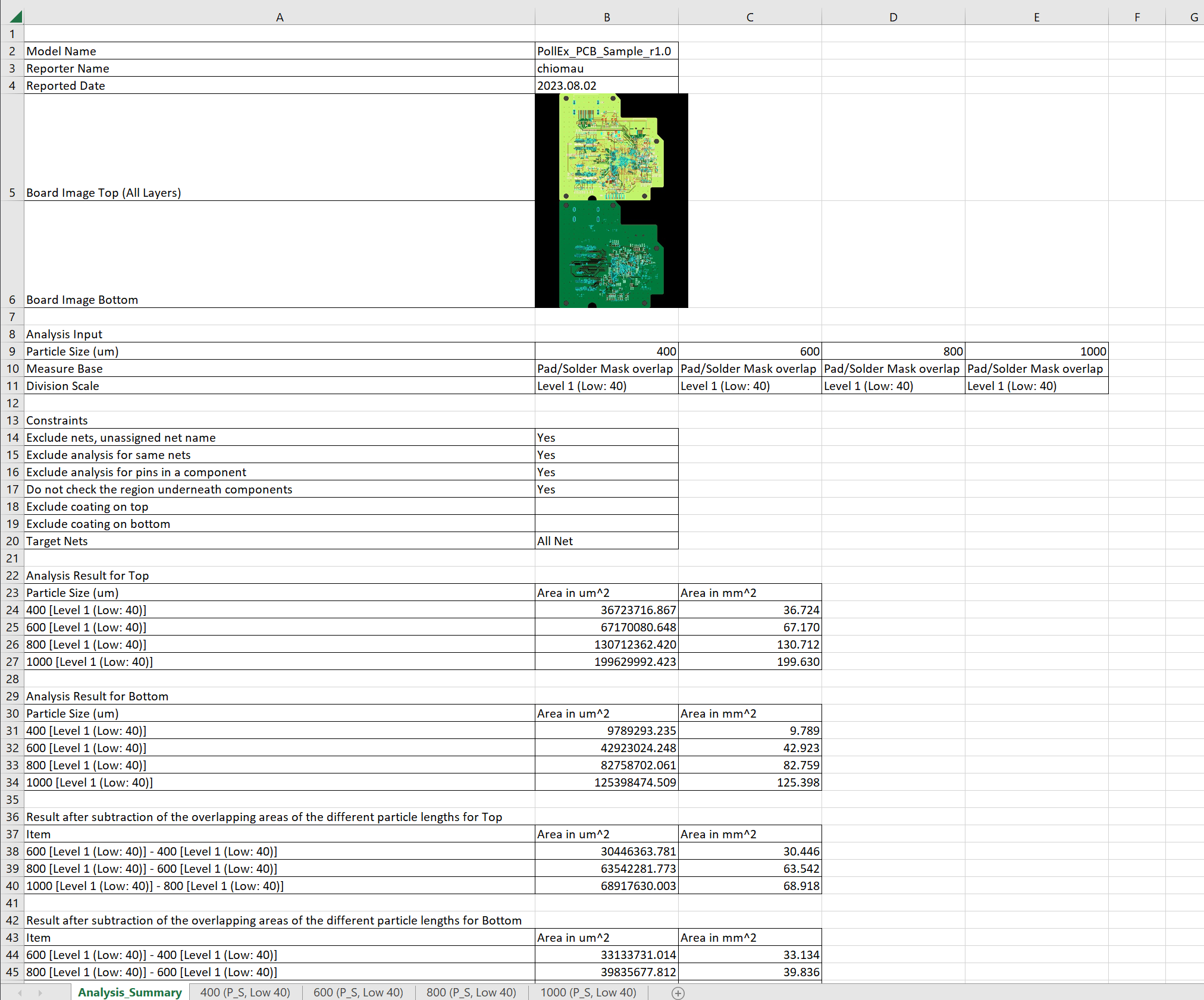

  7. Export the Result Report.
    1. Click Result report > File name (Pollex_PCB_Sample_r1.0) to export the result to Excel.
    2. To view, open the Pollex_PCB_Sample_r1.0.xlsx file located at: C:ProgramData\altair\PollEx\<version>\Examples\Verification\TechnicalCleanliness.
    Figure 5. Result Report

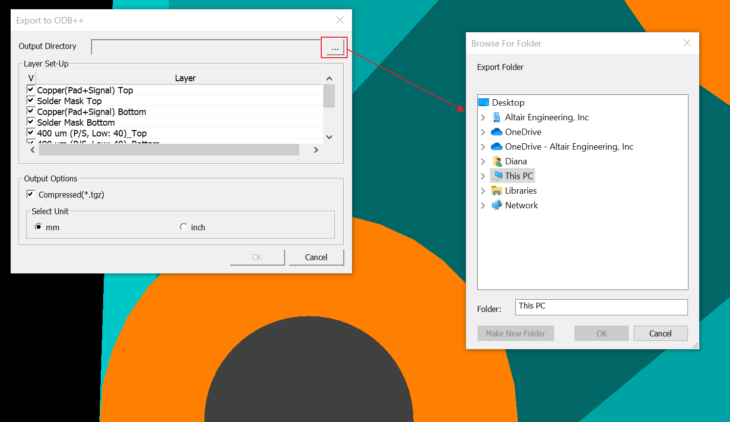

  8. Export to ODB++ Format
    1. Click Export
    2. Select the Output Directory, Set Layers to Export and Unit of the Design
      Figure 6.
    3. To view, open the Pollex_PCB_Sample_r1.0.tgz file located at the Selected Output Directory
