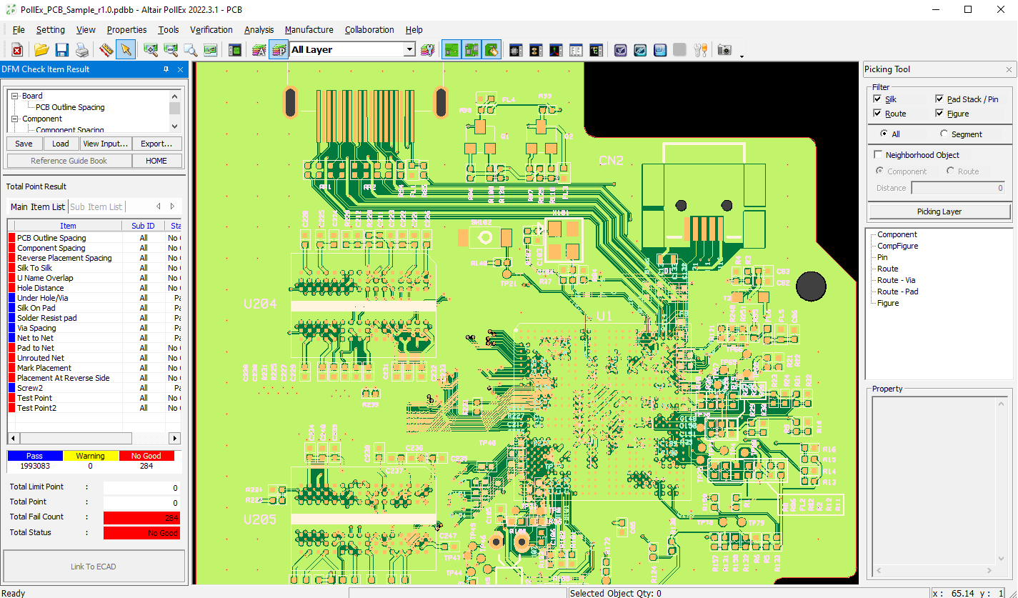

Check results.
The test results display on the screen (Pass or Fail).Figure 1.
Click Component Spacing.
You can check detailed information of the no good (fail) items from
the lists. When you click the failed item from the list, it displays the
highlighted location.
Click HOME to return to the result list.

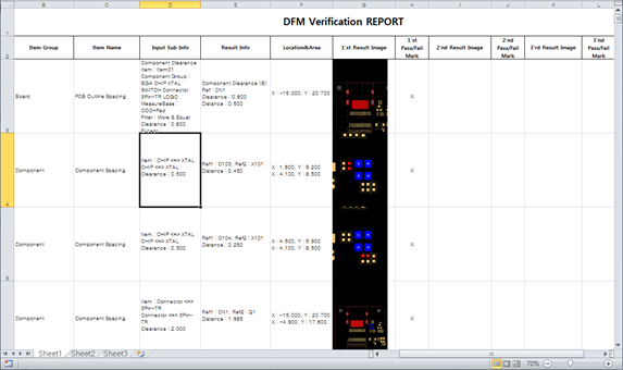

Export the test result.
From the menu bar, click Export > User Defined Excel Format to export the result to Excel.
Click Load and open the
UserDefinedExcelExport.DFME file from
C:\ProgramData\altair\PollEx\<version>\Examples\Verification\DFM\DFME.
Click Finish/Excel Export to export the
report.
Exported reports are not saved automatically. You need to save and
manage them in the designated location.
