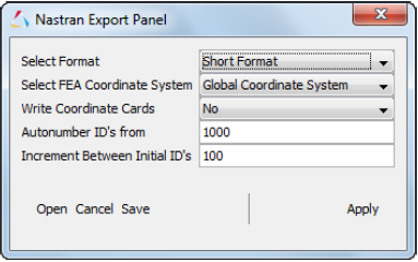

- Identifying and transferring all the forces and moments for one component at any given time step(s) to a Nastran input deck that contains GRID, CORD, FORCE, and MOMENT cards

Use Load Export Utility and Generate Nastran Input Deck
In this step you will use the Load Export Utility and generate a Nastran Input Deck.
