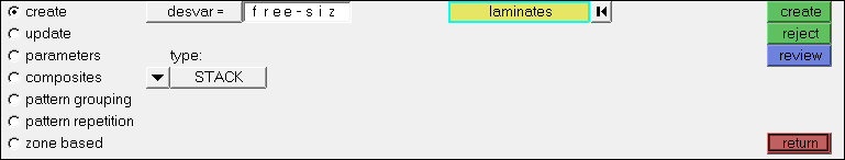

Create Free-size Optimization Design Variables

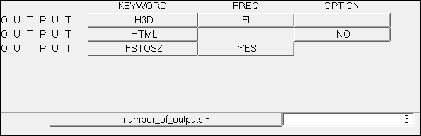

Create Output Requests

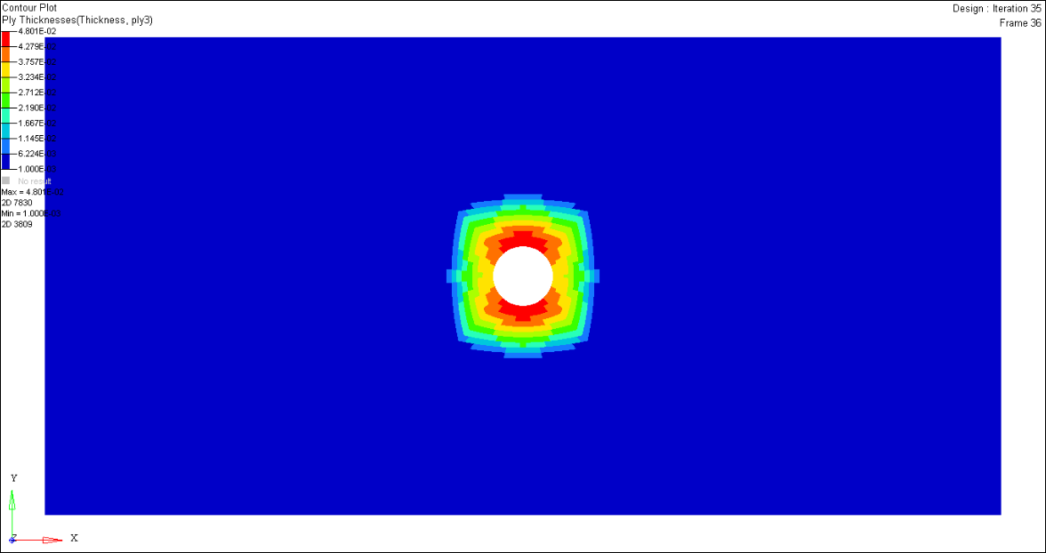

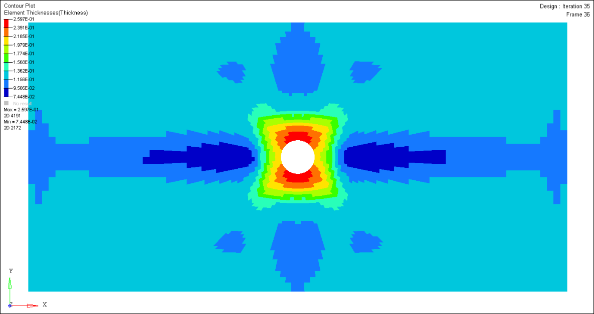

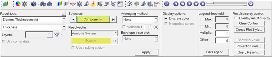

View the Element Thickness Results
Figure 8. Element Thicknesses Contour Plot After Free-size Optimization

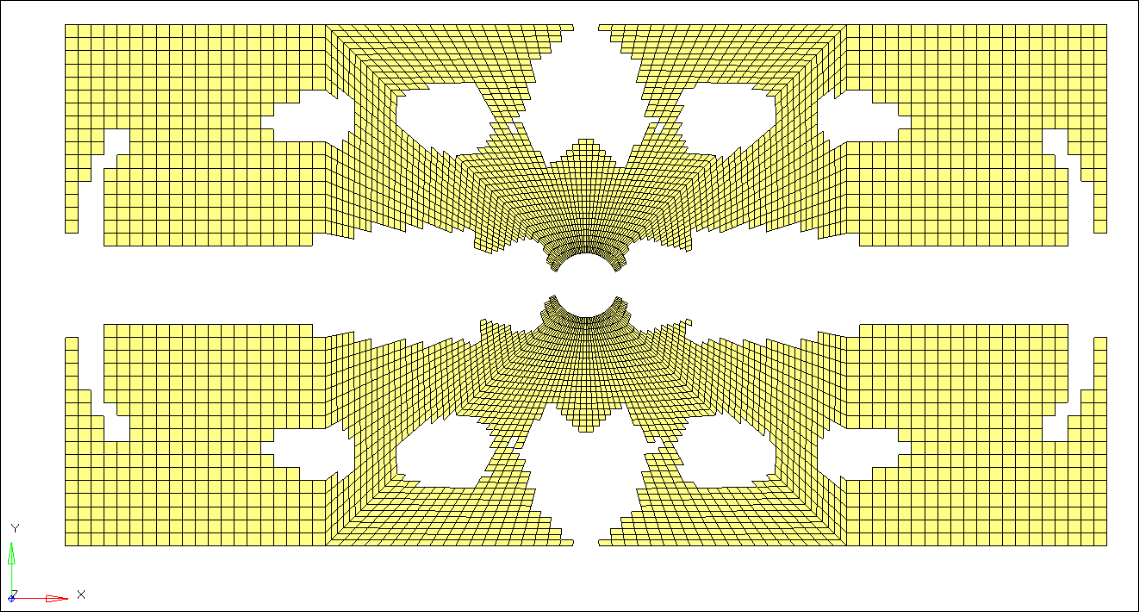

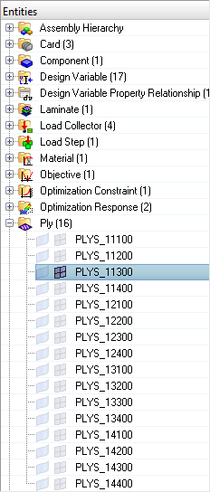

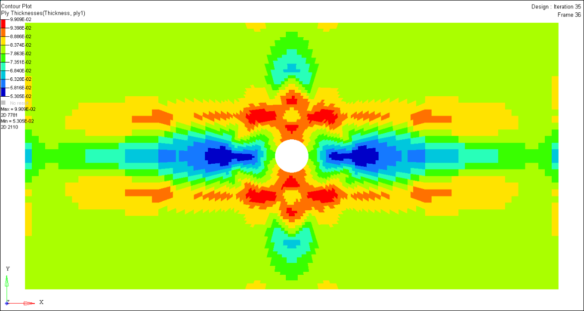

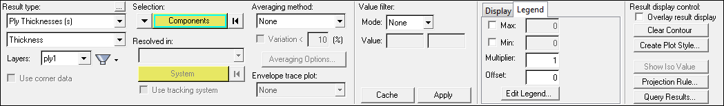

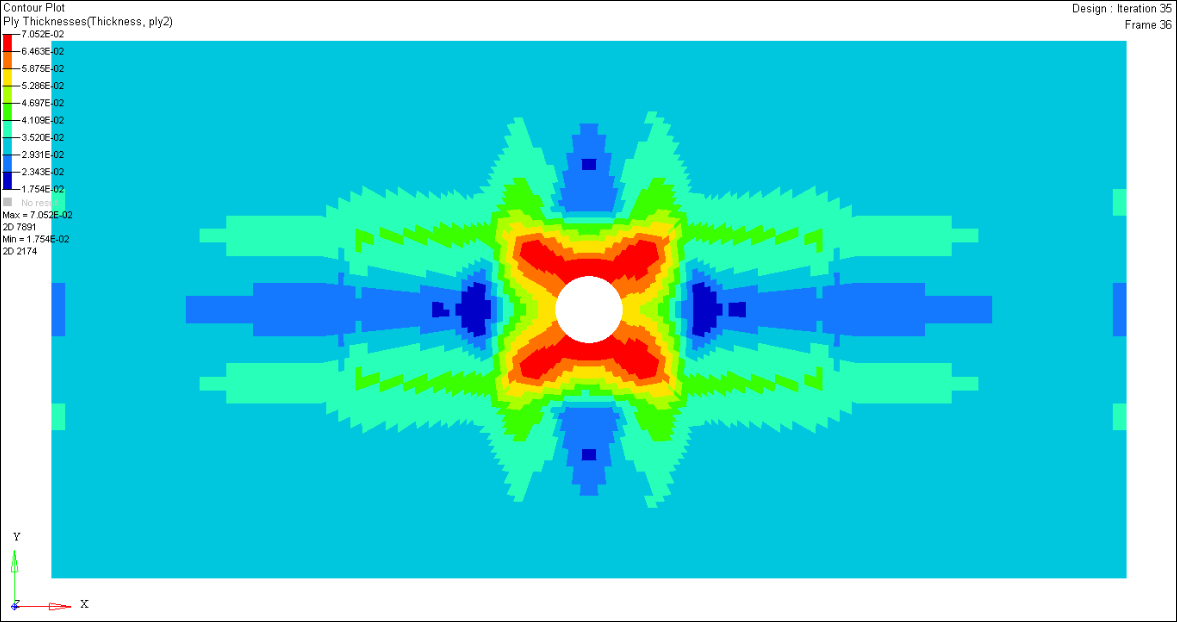

View the Ply Thickness Results
View the Ply Bundles

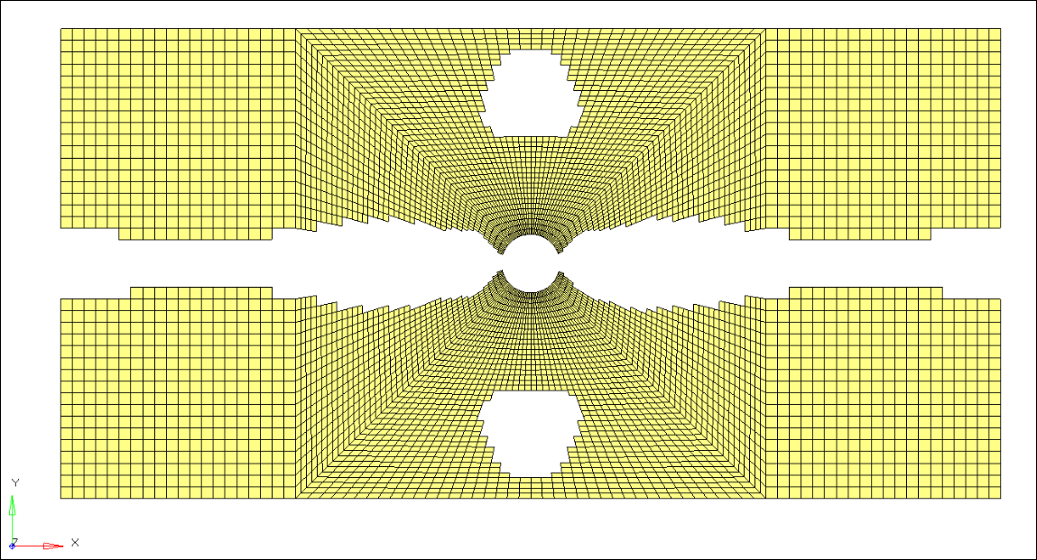

Apply Ply Smoothing using OSSmooth
- From the Post page, click the OSSmooth panel.
- In the Select model field, select oht_opti_ph1_sizing.35.fem.
- Change the mode from Geometry to PLY Shape.
- In the output file field, select the original location with the name of oht_opti_ph1_sizing.35.smoothed.fem.
- In the smooth iterations field, enter 20.
- Under small region, clear the split disconnected and create geometry checkboxes.
- In the area ratio field, enter 0.010.
- Click OSSmooth to run the analysis to smooth the model.
Figure 15. View of Ply 11300 after Smoothing Operations (Laminate 1, Ply 1, Shape 3)
