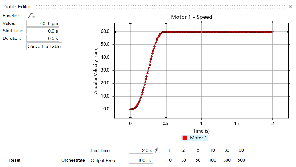

- Edit the Profile Function
- Open the Profile Editor, which allows you to edit profile data and view it in an interactive chart.

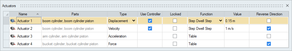

Actuators Table
The Actuators table lists all of the actuators in your model and allows you to edit various attributes.
Location: Actuators tool, satellite icon ![]()
Figure 2. Actuators Table
| To | Do this |
| Rename a actuator | Select the cell in the table and then click again to make the field editable. |
| Change the type | Select the cell in the table and then select a different option from the list. |
| Sort a column | Click the column header. Click repeatedly to toggle between ascending and descending order. |
| Add or remove columns | Right-click on a column header. |
