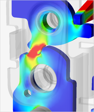

FlexContact+
When using flexible bodies in a motion contact, consider stress or strain at the contact interface by performing a more comprehensive and predictive analysis. You can model contacts between rigid/flexible and flexible/flexible parts.
FlexContact+ uses a unique process to also account for flex body deformation involving loads generated from general part-to-part contact. This method is useful for when there is at least one motion contact between a flexible part and another rigid or flexible part, and it is desired to capture a higher result accuracy of stress/strain at the contact interface. This process extends the traditional CMS (Component Mode Synthesis) process by also considering additional flex body mode shapes based on the contact region and behavior. In the end, an enhanced version of the CMS flex body is generated that is an aggregate consideration of all these modes.

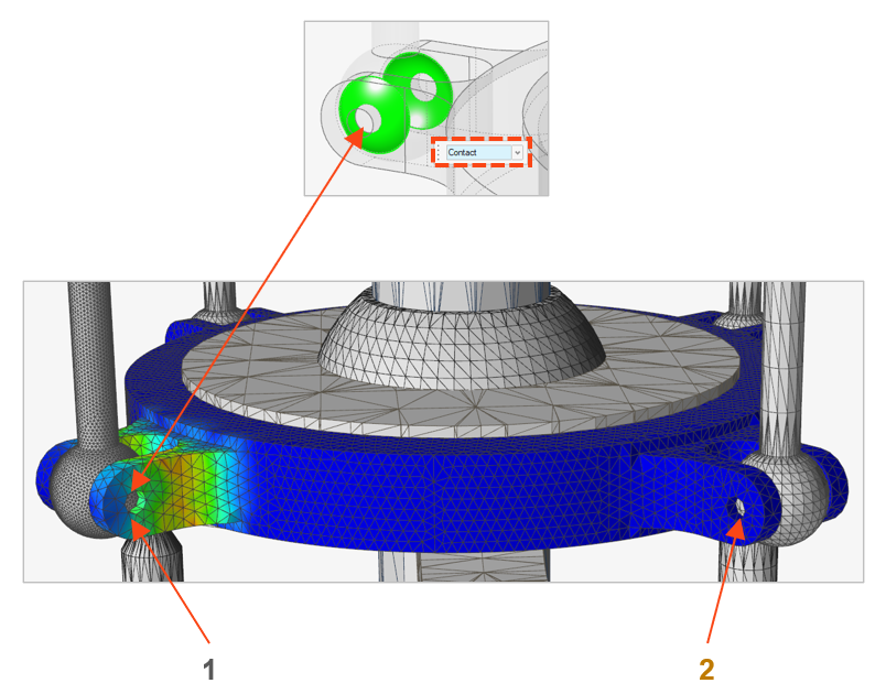

FlexContact+ for Joints
Account for flex body deformation involving loads occurring around the joint region. This method is useful for when there is a joint connected to the flex body that is defined by geometric features, and it is desired to capture a higher result accuracy of stress/strain at the part regions near the joint.
This process takes the same information that would be used in a traditional CMS (Component Mode Synthesis), but rather than use spider connections for joints between flexible parts and other parts, the spiders are removed, and additional flex body modes are calculated which account for the joint loading. The result is a flex body that accounts for realistic stress/strain due to deformation around the joint.
- The joint cannot be a Pin joint type.
- The geometry located at the joint must be representative of the true physical joint such that, if the joint was replaced with a part-to-part contact, the joint would behave with its intended degrees of freedom.
The Contact joint behaves like a regular motion contact. It is geometry contacting geometry. A Contact joint uses the same parameters for controlling the behavior of the contact (stiffness, damping, penetration and exponent). Avoid interfering and/or touching (coincident) geometry. Use the Inspire Geometry tools to modify geometry where and when possible.
Figure 1. 1=FlexContact+ for Joints, 2=Traditional Flex Contact
