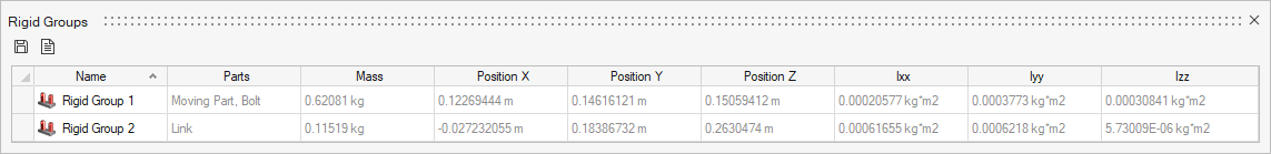

Rigid Groups Table
The Rigid Groups table allows you to review all of the rigid groups in your model and their properties.
You can also view properties for rigid groups in the Property Editor by pressing F3.
Location: Rigid Groups tool, satellite icon ![]()
Figure 1. Rigid Groups Table
| To | Do this |
| Display the group | Select the group name in the table. |
| Hide the group | Click the icon next to the group name in the table. Click again to show the group. Alternatively, right-click a group name in the table and select Hide selected from the context menu. |
| Rename the group | Right-click a group name in the table and select Rename from the context menu. |
| Show all groups | Right-click a group name in the table and select Show All Groups from the context menu. |
| Ungroup parts | Right-click a group name in the table and select Ungroup from the context menu. |
