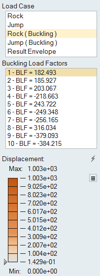

Select the run you want to view in the Analysis Explorer.
Select one of the (Buckling) load cases.
![](../../../images/figures/inspire/buckling_modes.png)
Select a Buckling Load Factor. The displacement for the
selected mode is displayed on the modeling window. If the value for that mode is
displayed in the modeling window. If the value for that mode is between 1 and 0,
the part is predicted to buckle. If the value is between 0 and -1, it will
buckle in the opposite direction.
