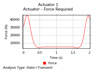

Tutorial: Actuators and Analysis Types
Add an actuator to a motion model, then run transient and static motion analyses.

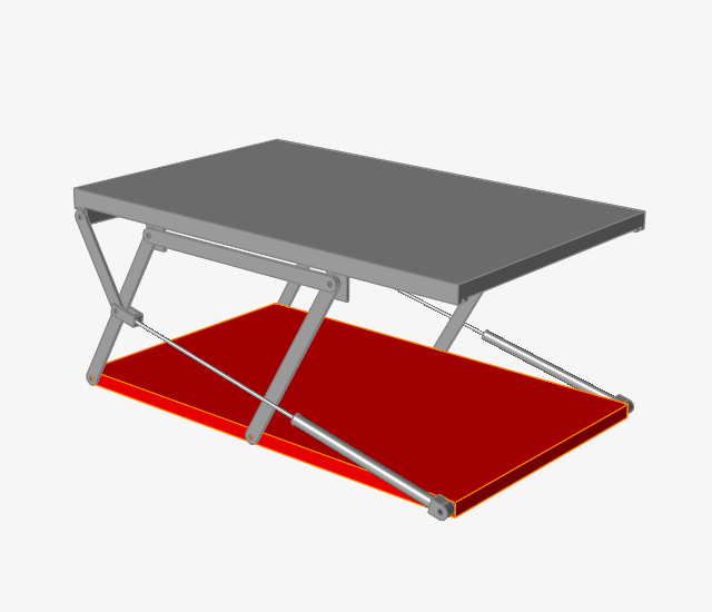

- Ground a part
- Connect parts with joints

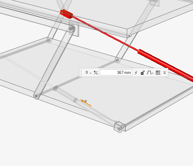

- Add an actuator to the model

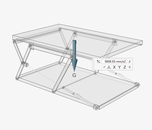

- Determine the direction of gravity

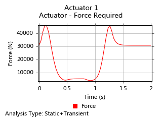

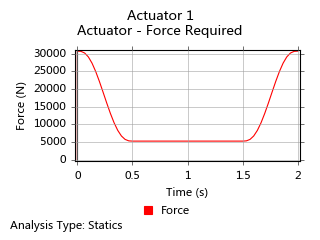

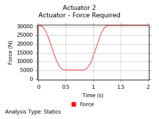

- Run transient and statics motion analyses
- View and plot the results
