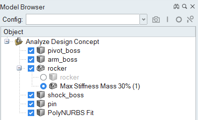

Press F2 to open the Model Browser. Verify that the
Max Stiffness Mass 30% result alternative is
selected.

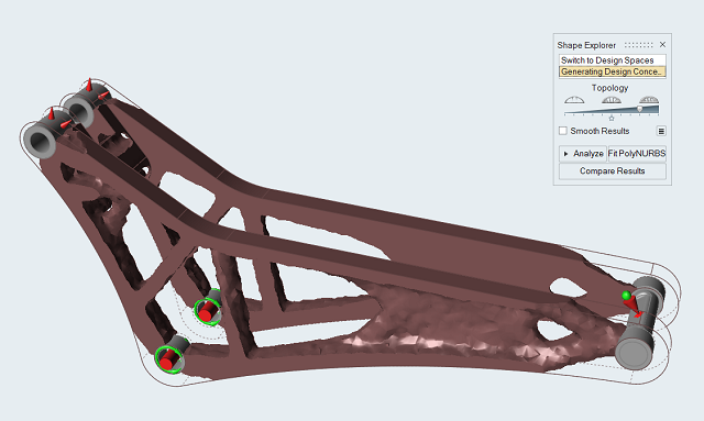

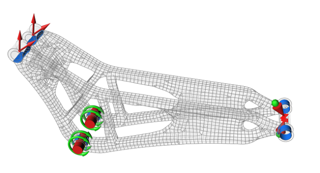

View and Refine the Optimization Results
Click the Structure tab on the ribbon.
An optimization was previously run and saved with the model. Click
Show Optimization Results on the Optimize icon to
view the Shape Explorer, or simply double-click the optimized part.
Position the topology slider on the Shape Explorer two ticks from the far
right. This is the point at which the generated shape is fully connected, which
is important when fitting PolyNURBS to the result. Your analysis results and CAD
conversion will vary depending on where you position the slider.

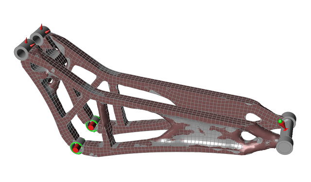

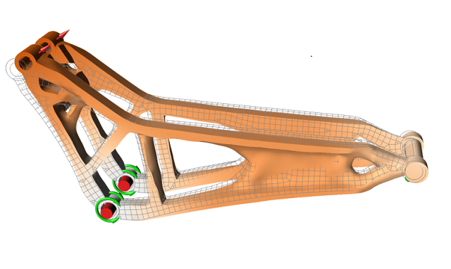

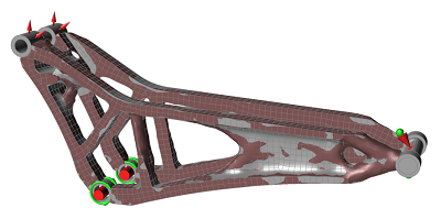

Click the Fit PolyNURBS button on the Shape Explorer.
This automatically generates a PolyNURBS and opens the PolyNURBS tool.
Double right-click to exit the PolyNURBS tool. This converts the PolyNURBS to a
CAD part, which appears as PolyNURBS Fit in the Model
Browser.

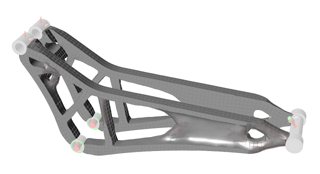

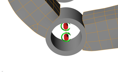

Eliminate Gaps Near Non-Design Spaces

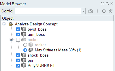

Press F5 to view the Model Configuration toolbar, which
appears at the top of the Model Browser.
Deselect the rocker check box to configure off the
initial part. This will exclude it from any calculations.
Double-right-click in the modeling window to close the Model Configuration
toolbar.

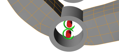

Use the scroll wheel to zoom in on the areas where the PolyNURBS contacts the
three boss parts. Notice that the PolyNURBS part has gaps near these non-design
spaces.
Use the Contacts tool on the Structure ribbon to locate
and review these gaps.
Fix these gaps using the various PolyNURBS tools on the Geometry ribbon so that
high stress concentration areas are not found in the subsequent analysis.

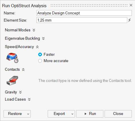

Analyze the Modified Shape
Click on the Analyze icon on the
Structure ribbon to analyze the modified shape.
Set the Speed/Accuracy setting to
Faster.
Click Run.

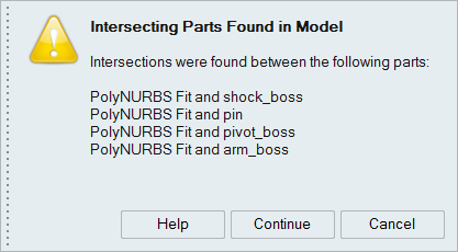

Depending on how well the cleanup went in the previous step, you may get
a warning message similar to the one below:
Click Continue.

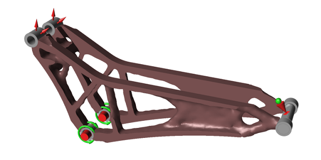

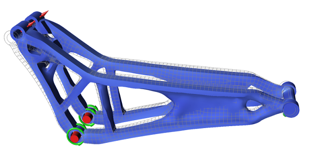

Double-click on the name of the run to view the results, which are displayed in
the Analysis Explorer.
View the Analysis Results

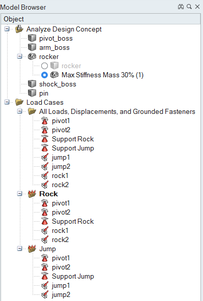

In the Analysis Explorer under Load Case, select the
Jump load case and the Displacement result
type.
The maximum displacement shown in the legend should be approximately .5 mm, but
your results will vary depending on where you positioned the topology slider and
how you modified the geometry near the non-design spaces.
Click the button under Animation to
view the displacement. Click the button again to stop the animation.
With the Jump load case still selected, switch to von Mises
Stress for the result type.
Click the icon and select Hide all loads and
supports.
Orbit the model to check that there are no hidden red areas.
