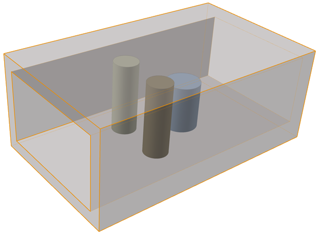

Import Geometry
First, download and unzip this file: CHT_Tutorial.zip.
- On the File menu, select Import.
Browse to the CHT_Tutorial.x_b file.

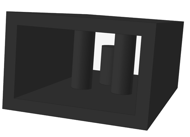

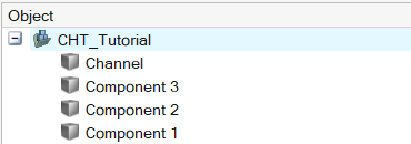

The model is loaded.Note: The model is comprised of the following parts:
- Channel
- Component 1
- Component 2
- Component 3You can view these parts in the Object Browser:

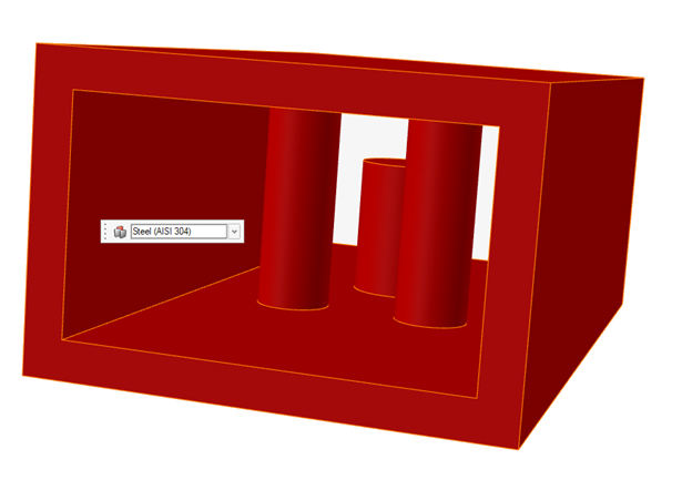

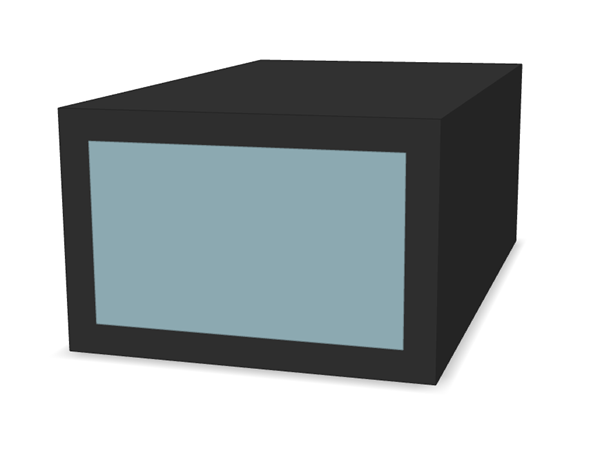

Designate the Static Solid Domain
Click the Static Solid icon.
Box select all parts in the model to designate the Static
Solid domain.
Selected parts will turn red.
- In the microdialog, choose Steel (AISI 304) for the static solid domain.
Right-click and mouse through the check mark to exit, or
double-right-click.
The parts designated as Static Solid domains will turn black.

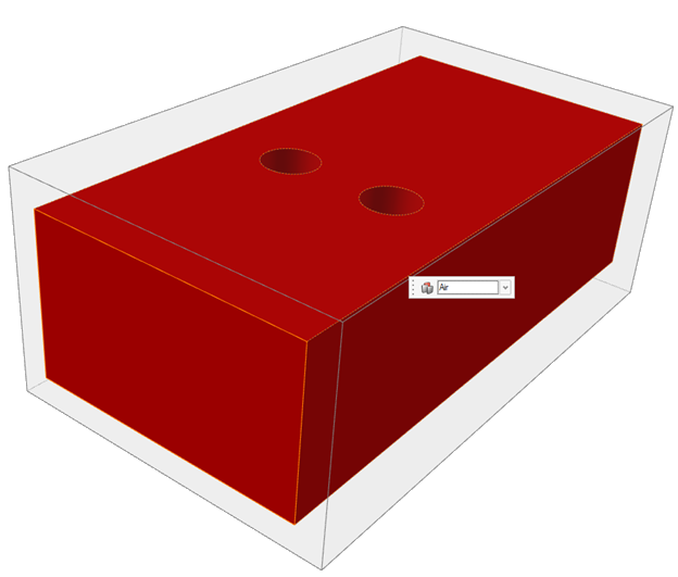

Create the Fluid Domain
Click the Create Fluid Domain icon.
A new fluid domain is detected and created.
- In the microdialog, choose a fluid type.
double-right-click.
The new fluid domain turns blue.

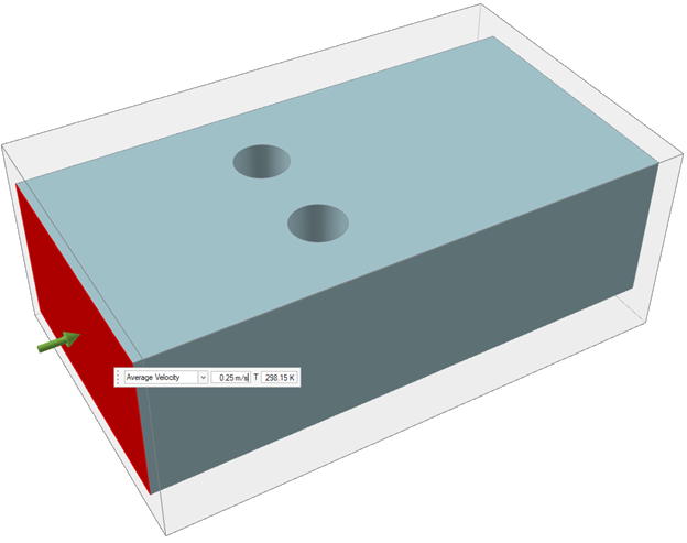

Designate Inlets
Select the Inlet icon.
Select a face in the fluid domain where you would like to define an inlet. An
arrow appears at each defined inlet.
- In the microdialog, enter .25 m/s for the Average Velocity. Use the default value of 298.15 K for the temperature.

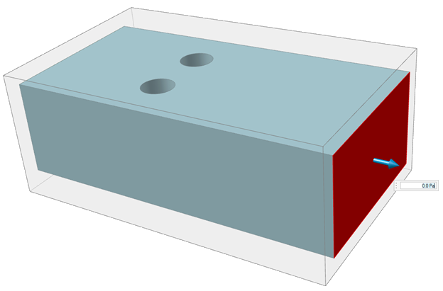

Designate Outlets
Click the Outlet icon.
Select a face in the fluid domain where you would like to define an outlet.
An arrow appears at each defined outlet.
- Enter 0 Pa for static pressure for the outlet face.

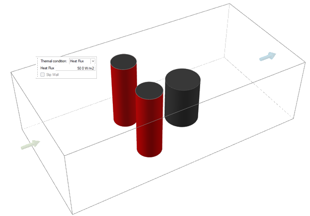

Select Component 1 and
Component
2 in the model.
The microdialog appears with the following options:
- Temperature
- Convection
- Heat Flux
- Select the dropdown menu in the microdialog, then choose Heat Flux.
- Enter 50 W/m2 for the Heat Flux.

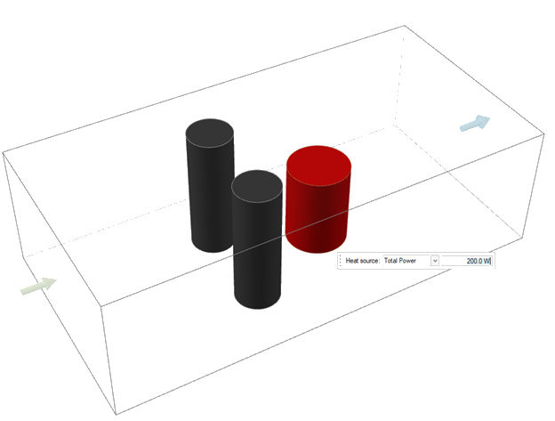

On the Fluids ribbon, select the
Part tool.
- Select Component 3.
- In the microdialog, select Total Power from the dropdown, and then enter 200.0 W.

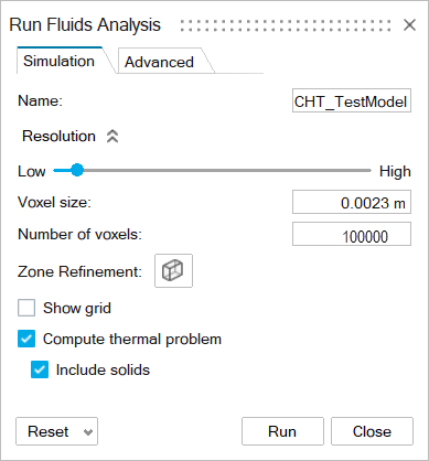

Configure Solver Settings
Click the Custom Fluids Run icon.
- In the Simulation tab, set the Number of voxels to 100,000 and the Voxel size to .0023 m
Enable Compute thermal problem and
Include solids.
- Click Run.

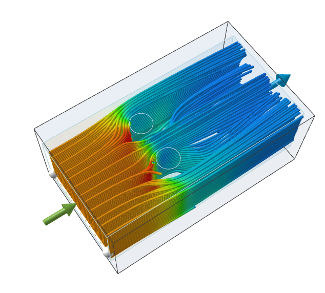

Click
to visualize your results with streamlines.
Click

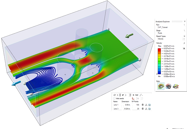

Optionally, you can create local streamlines in the model:
- In the streamlines microdialog, disable Inlet seeds to turn off inlet streamlines.
Click
to create the first linear streamline region.
- Enter a value of 0.09 under Dimension and 100 under No. of Points. Using the move arrows, reposition this linear streamline region closer to the inlet as shown in the image
Click
to create the second linear streamline region.
- Enter a value of 0.024 under Dimension and 20 under No. of Points. Using the move arrows, reposition this linear streamline region closer to the outlet as shown in the image
In the Analysis Explorer, change the Result Type to Velocity.
The model should look similar to the image below:

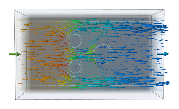

Click
to visualize your results with vectors.
Under Result Types, use the dropdown menu to select
Velocity.
Results visualized as Velocity are displayed.
- Deselect Vectors as the result Style Option.

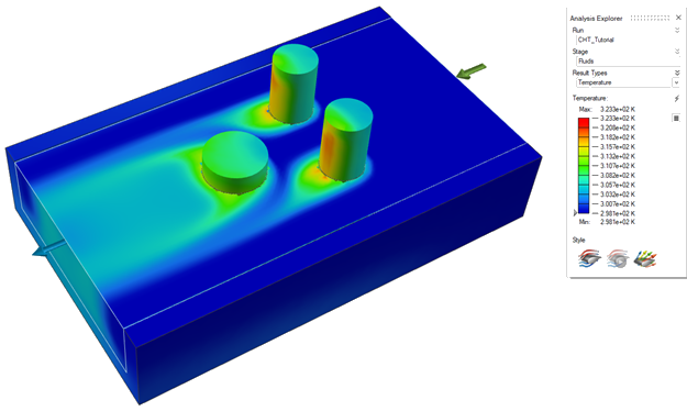

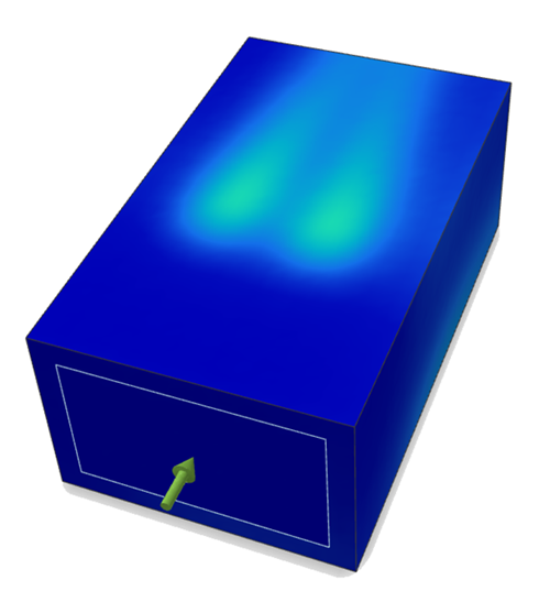

Temperature.
Results visualized as Temperature are displayed.

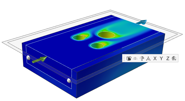

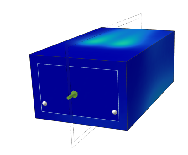

You can make a section cuts of the temperature results.
In the Object Browser, click
to next to the component names to hide Component 1, Component 2, and Component 3.
In the bottom-left of the modeling window, select Section
Cuts
In the microdialog, click
Click the grey section cut pane.
In the microdialog, select Z.
The section cut is applied.
