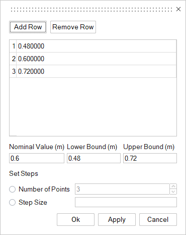

For a Discrete Variable, you can modify the following values:- Nominal Value: Default value of the variable; also serves as the initial value in an Optimization exploration.
- Lower Bound: The minimum value of the variable range to be studied.
- Upper Bound: The maximum value of the variable range to be studied.
- Set Steps: Set the number of steps between the minimum and maximum values based on the Number of Points or Step Size.
