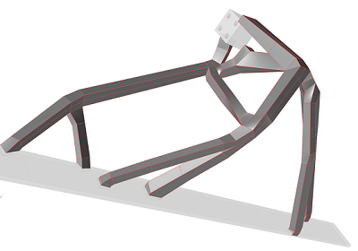

- High sharpening produces perfect creasing. You can add fillets or chamfers to edges with high sharpening.
![](../../../images/figures/inspire/high_sharpening_1.png)
Figure 1. Original PolyNURBS Model
