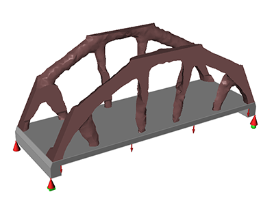

Design Spaces for Topology Optimization
In topology optimization, a design space is the initial part from which material is removed until a final shape is reached during optimization.
![](../../../images/figures/inspire/design_space_optimized.png)
Figure 1. Topology Optimization Design Space

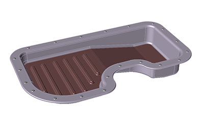

Design Spaces for Topography Optimization
![](../../../images/figures/inspire/design_space_topography.png)
Figure 2. Topography Optimization Design Space
Design and Non-Design Spaces
In general, it is best not to apply loads and supports directly to design spaces, as this often leads to incorrect results. Instead, you should split the part into design and non-design spaces and apply loads and supports to the non-design spaces.
![](../../../images/figures/inspire/Forces_nondesign.png)
Figure 3. Forces Applied to Non-Design Spaces
