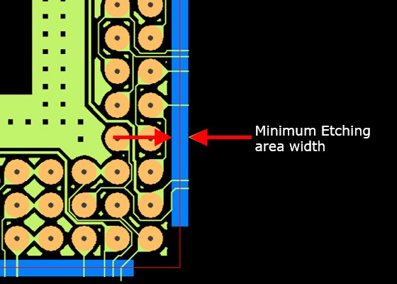

- Checking: Set the checking rules for each Top, Bottom and Inner layers.
- Minimum Etching area width: Minimum width checking of objects drawn
on the etching area.

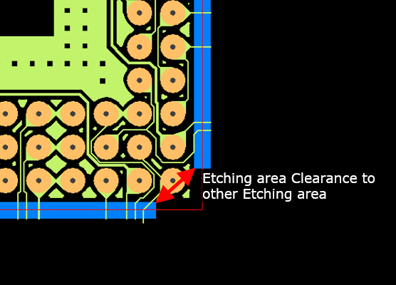

Figure 1. - Etching area Clearance to other Etching area: Minimum clearance
checking between objects drawn on the etching area.

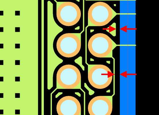

Figure 2. - Etching area Clearance to user Defined Layer Objects: Clearance checking between objects drawn in the etching area and in the user defined layer.

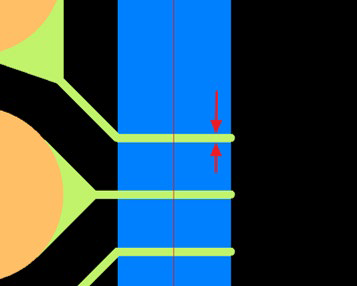

Figure 4. - Check Pattern width in Etching area: Check whether the pattern
overlapped with the etching area is designed within the user defined
width.
