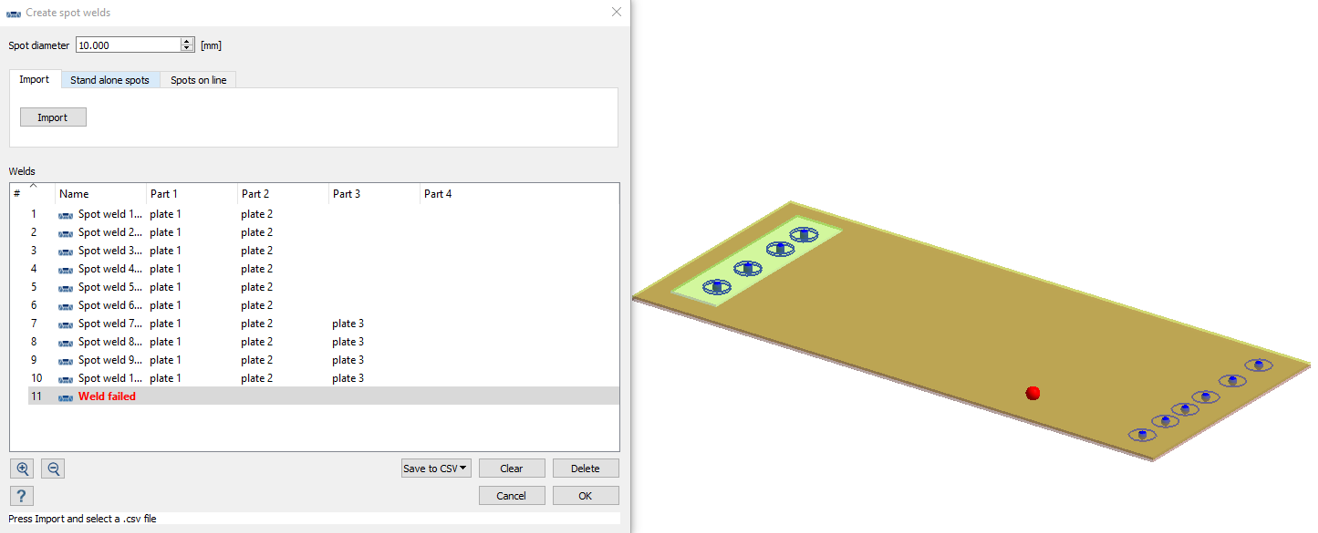

Import Welds from CSV
  1. In the Connections workbench toolbar, click the (Create spot or laser welds) icon.
  2. Activate the Import welds from CSV radio button.
  3. Click the Import button and browse to Spots.csv file.
  4. Click Open.
    Figure 2 shows how the file looks:
    Tip: If more than 2 parts need to be connected, enter alpha numeric value in the "connected part 3" column.
    The imported welds are listed in the dialog. Welds fail if the spot's XYZ values lie outside of the tolerance-spot diameter. Failed welds are listed in red.
    Figure 3.
  5. Select the failed weld and click Delete.
  6. Optional: Click Save to CSV > Save all to save a new CSV file without the failed weld.
  7. Optional: Use the and (Zoom in/out) buttons to review welds.
  8. For Spot diameter, enter 10.000.
  9. Click OK.
    Figure 4.

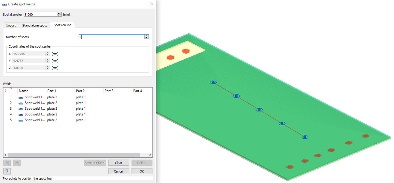

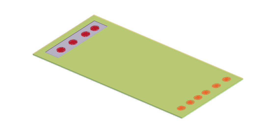

Create Spot Welds on Line
  1. In the Connections workbench toolbar, click create spot weld.
  2. Switch to the Spots on line tab.
  3. In the modeling window, pick 2 points to draw a line.
  4. Use the up/down arrows to define the Number of spots.
    Figure 5.
  5. Increase the spot diameter to 5.000.
  6. Click OK.

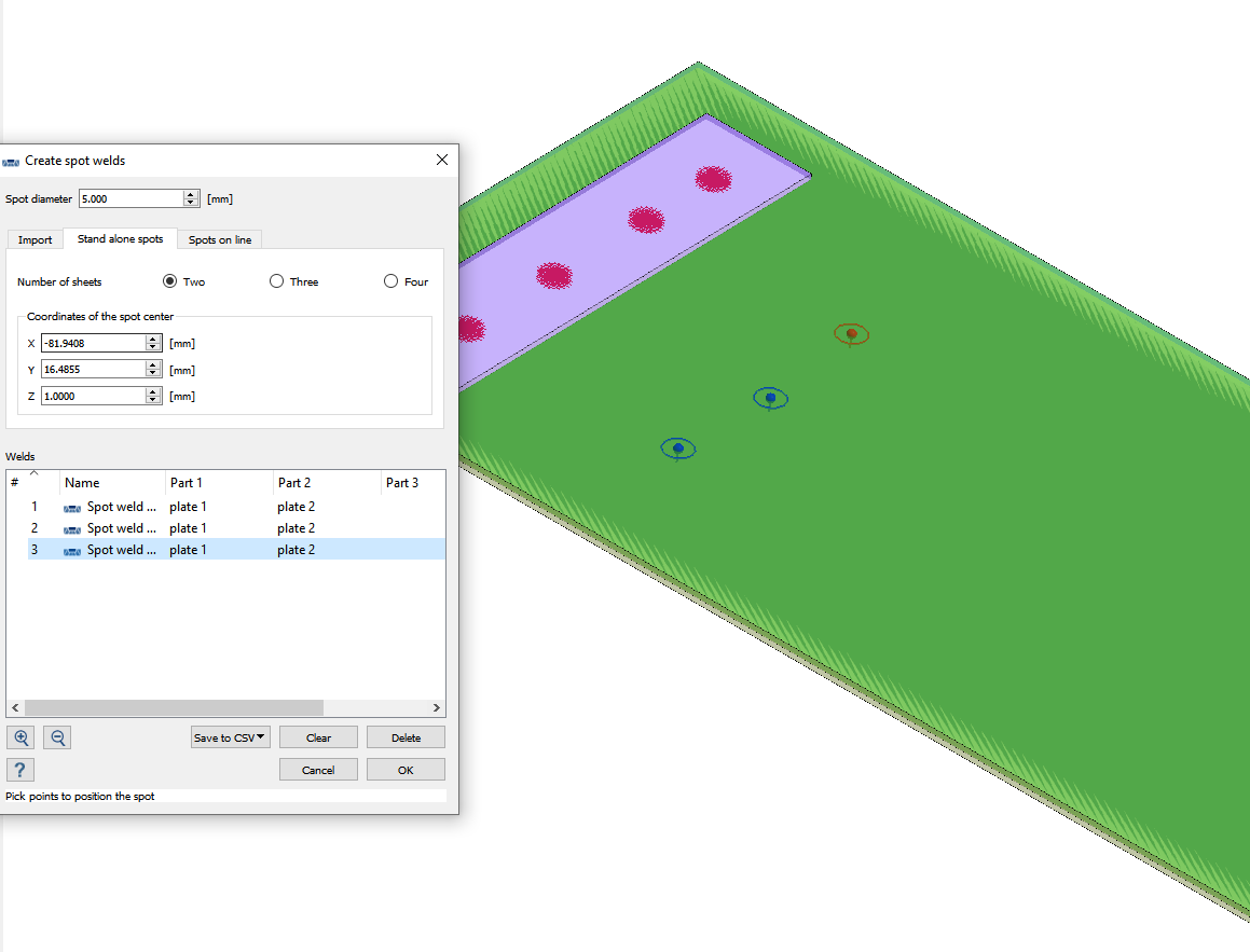

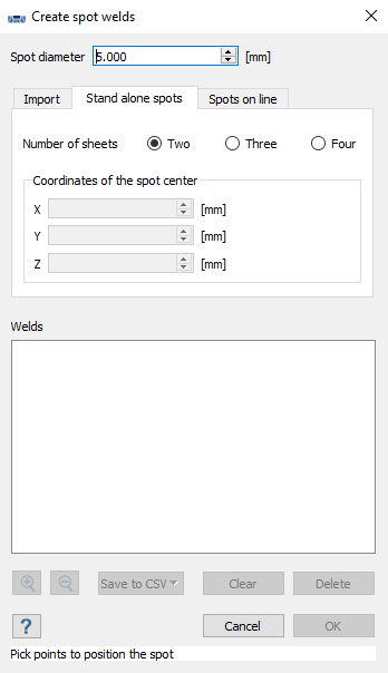

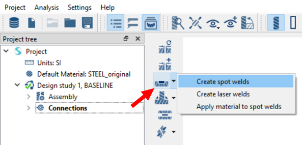

Create Standalone Spot Weld
    Figure 6.
  2. Switch to the Stand alone spots tab.
  3. For Number of sheets, select Two.
  4. Click on the parts shown in Figure 7 to create spots at desired locations.
    Figure 7.
  5. Change the spot diameter to 5.000.
  6. Click OK.

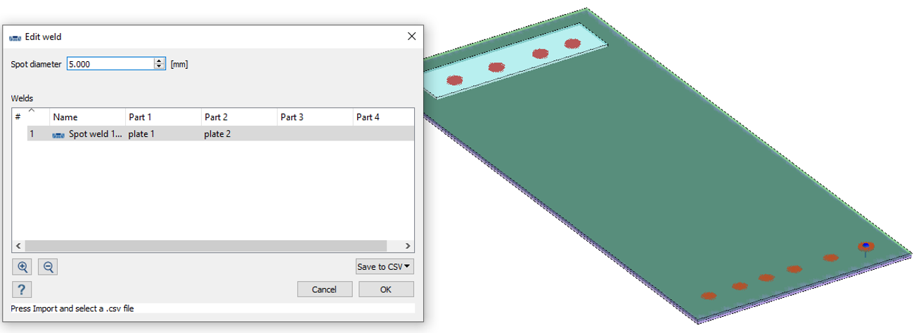

Edit Spot Welds
  1. In the Project Tree, right-click on Spot weld 1 and select Edit connection from the context menu.
  2. Change the diameter to 5.000
    Figure 8.
  3. You can edit multiple spot welds by selecting them in the Project Tree.

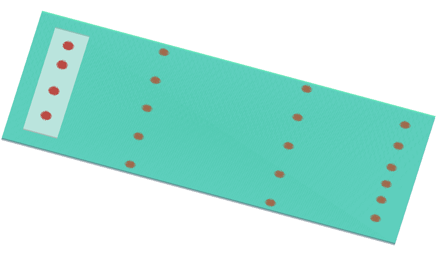

Open Project
  1. Start a new SimSolid session.
  2. On the main window toolbar, click Open Project .
  3. In the Open project file dialog, choose Spots.ssp
  4. Click OK.

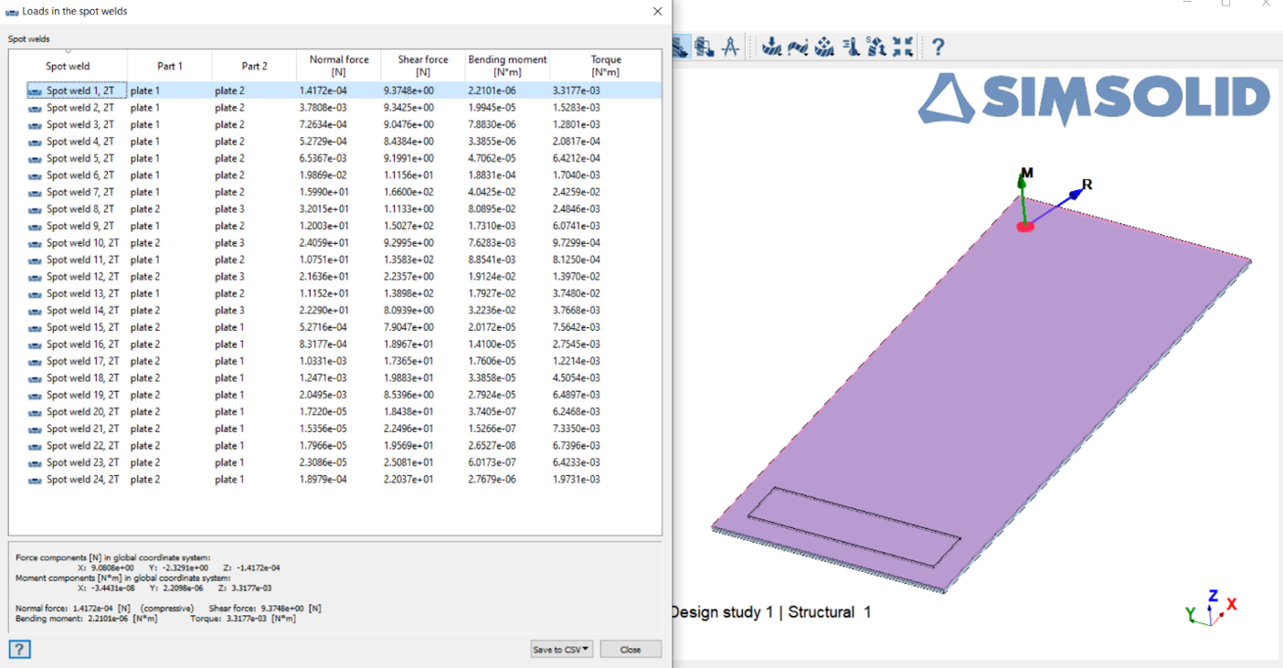

Review Spot Weld Forces
  1. In the Project Tree, select Structural 1.
  2. Click solve.
  3. Review the model and the spot welds created.
    Figure 9.
  4. Review spot weld forces.
    1. On the Analysis Workbench toolbar, select (Weld forces) > Spot weld forces.
      Figure 10.
      Spot weld reaction forces are listed in the dialogue.
      Figure 11.
    2. Select each spot weld in the dialogue to view its corresponding forces and moments.
      Force and moment resultants are drawn graphically for the selected spot weld.
  5. Click Save to CSV > Save all selected to save desired spot weld forces to CSV file.
