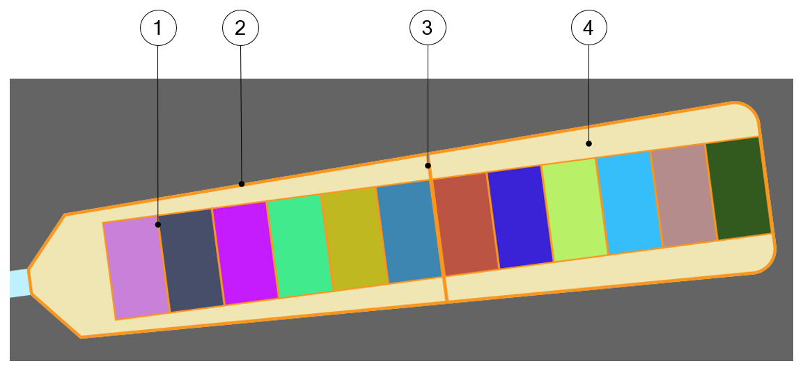

Illustrations for rectangular shape type wire
Illustration of winding insulation for rectangular
shape type wire |
1 |
Insulation thickness of the wire |
2 |
Insulation thickness of the liner |
3 |
Insulation thickness of the phase separator |
4 |
Presence of impregnation |
