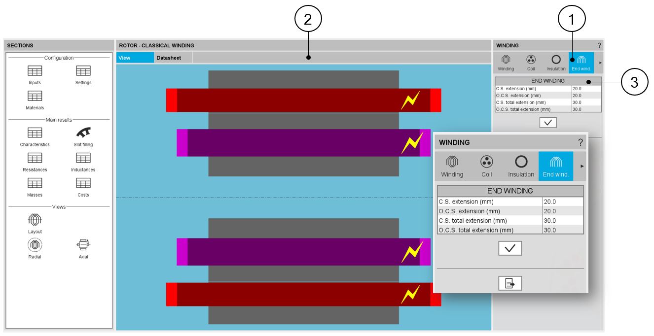

| Definition of the end winding |
| 1 |
End winding settings allow the user to describe the end winding
dimensions. |
| 2 |
The axial view of the machine allows to see each dimension change of
the end winding; the Connection Side (C.S.) is indicated by the yellow
lightning. |
| 3 |
The parameters to adjust the end winding dimensions |
