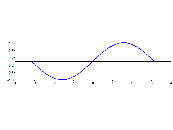

Examples
clf;
x=linspace(-pi,pi, 100);
plot(x,sin(x));
axis ([-4 4 -1.5 1.5])Figure 1. Simple axis example

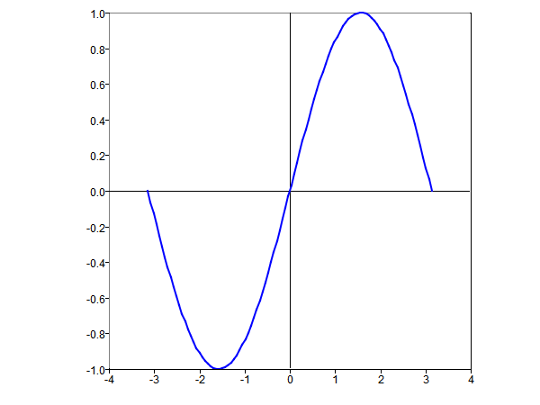

clf;
plot(x,sin(x));
axis('equal');
Figure 2. Uniform aspect ratio

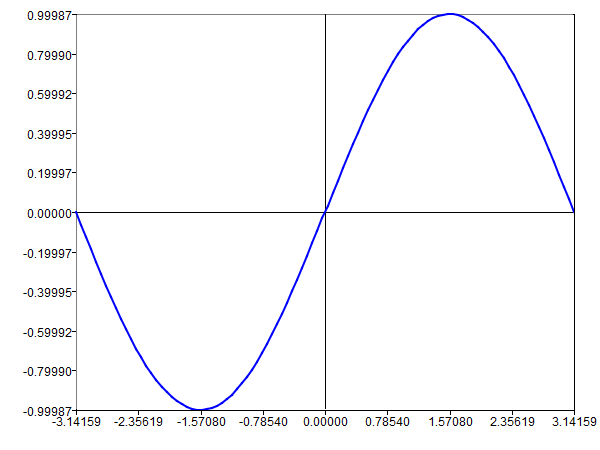

clf;
plot(x,sin(x));
axis('tight');
Figure 4. Tight fit to curve data

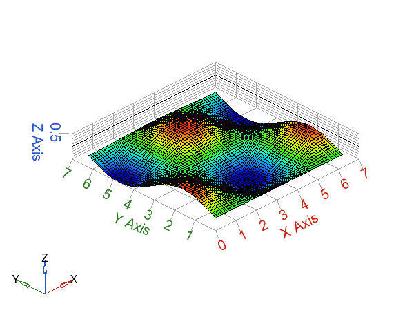

clf;
x=[0:0.1:2*pi];
y=x;
z=sin(x')*cos(y);
s=surf(x, y, z)
axis('bestfit');
Figure 5. Best fit axes

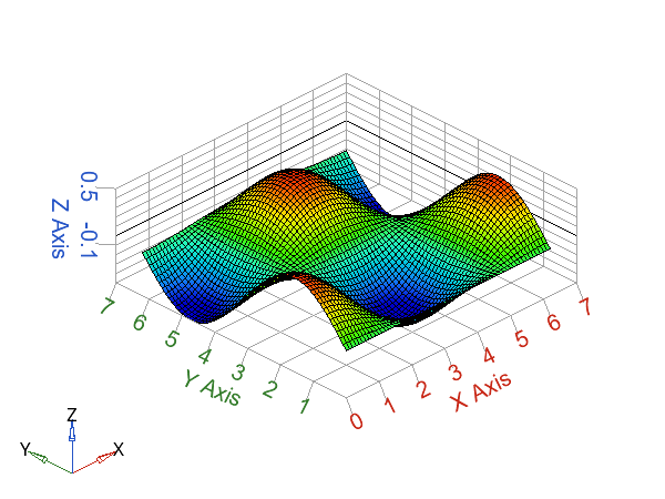

clf;
x=[0:0.1:2*pi];
y=x;
z=sin(x')*cos(y);
s=surf(x, y, z)
axis('unscaled');
Figure 6. Unscaled axes
