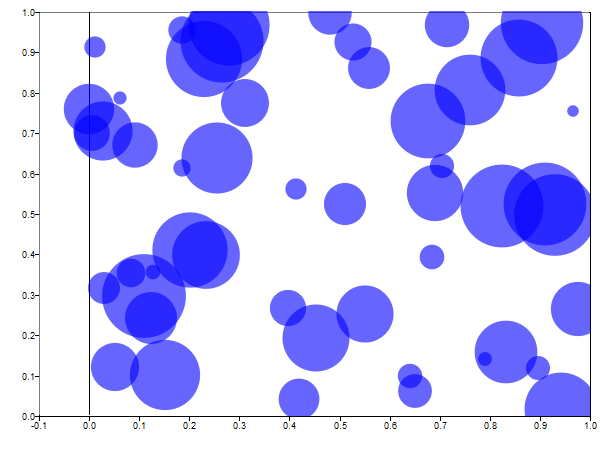

clf;
x = rand(50,1);
y = rand(50,1);
s = 50*rand(50,1);
b = bubblechart(x, y, s);
Figure 1. Bubble chart

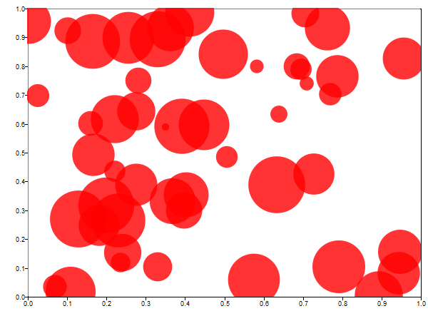

clf;
x = rand(50,1);
y = rand(50,1);
s = 50*rand(50,1);
b = bubblechart(x, y, s, 'markerfacecolor', 'r', 'markerfacealpha', 0.8);
Figure 2. Bubble chart with custom color and opacity

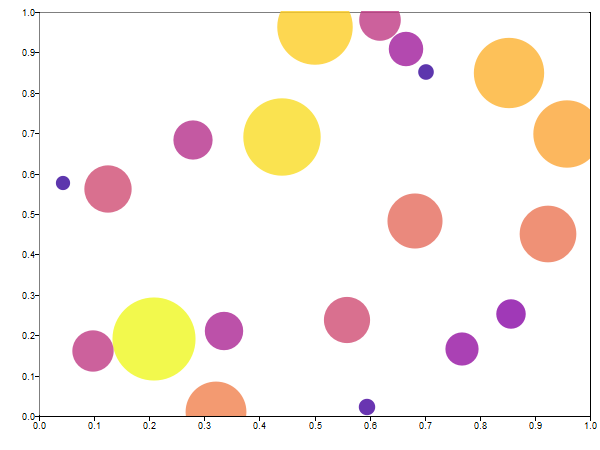

clf;
x = rand(20,1);
y = rand(20,1);
s = 50*rand(20,1);
cmap = plasma(30);
cdata = cmap(ceil(s*30/max(s)), :);
bubblechart(x, y, s, cdata, 'markerfacealpha', 0.8);
Figure 3. Use a colormap with bubble chart
