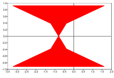

t1 = (1/16:1/8:1) * 2*pi;
t2 = ((1/16:1/8:1) + 1/32) * 2*pi;
x = tan (t1) - 0.8;
y = sin (t1);
h = patch (x',y','r')
Figure 1. 2D patch plot example

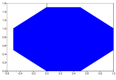

h = patch('vertices',verts,'faces',faces);

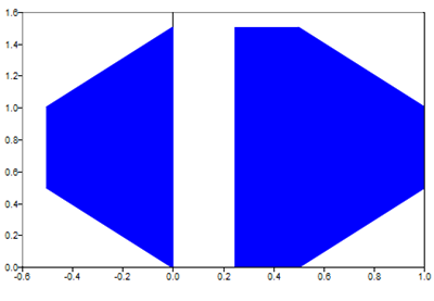

% Create two patches each one consisting of 4 vertices
faces = [3 4 5 6; 8 9 10 1];

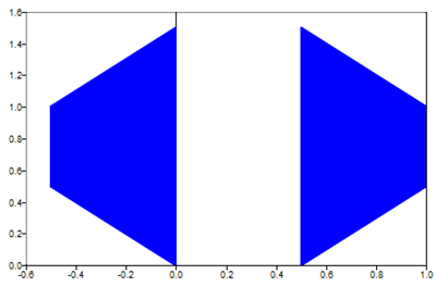

% Create two patches, the first patch consists of 6 vertices,
% the second patch consists of 4 vertices
faces = [2 3 4 5 6 7; 8 9 10 1 NaN NaN];
Figure 2. 2D patch plot defined by vertices and faces matrices
Figure 3. Create two-2D patches defined by vertices and faces matrices
Figure 4. Create two-2D patches that have different number of vertices

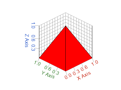

h = patch(x,y,z,'r');
Figure 5. 3D patch plot example - triangles

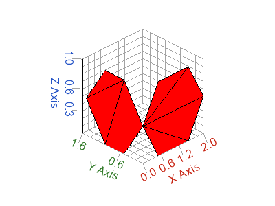

clf;
x = [0.5 0; 1.5 0; 2 0; 1.5, 0; 0.5 0; 0 0];
y = [0 0; 0 0.5; 0 1; 0 1.5; 0 1; 0 0.5];
z = [0 0.5; 0 0; 0.5 0; 1 0.5; 1 1; 0.5 1];
Figure 7. 3D patch plot example - polygons

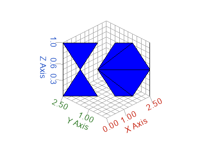

verts = [0 2.5 0; 1 1.5 0; 1.5 1 0; 2 0.5 0; 2.5 0, 0.5; 2 0.5 1;
1.5, 1 1; 1 1.5 0.5; 1 1.5 1; 0 2.5 1; 0.5 2 0.5];
faces = [1 2 11 NaN NaN NaN; 9 10 11 NaN NaN NaN; 3 4 5 6 7 8];

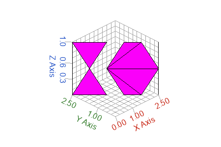

figure;
set(h,'facecolor',[250 0 250]]);
Figure 9. One color to all faces of the 3D patch

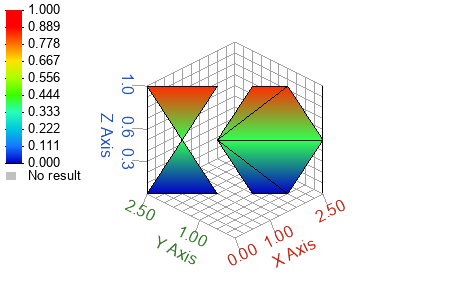

% facecolor = 'interp', the color of each face is defined by interpolating
% the cdata values of its vertices.
% if 'cdata' is not given then the 'zdata' values will be used.
set(h,'facecolor', 'interp');

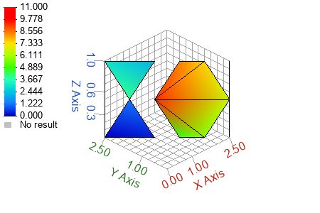

figure;
% set a scalar value for each vertex

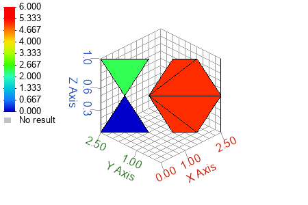

cdata = [0 1 2 NaN NaN NaN; 3 4 5 NaN NaN NaN; 6 7 8 9 10 11]';
set(h,'cdata', cdata)

Figure 10. Patch color defined by the 'zdata' value of each vertex
Figure 11. Patch color defined by the 'cdata' value of each vertex

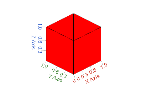

x = [0 1 1 0; 1 1 0 0; 1 1 0 0; 0 1 1 0];
y = [0 0 1 1; 0 1 1 0; 0 1 1 0; 0 0 1 1];
z = [0 0 0 0; 0 0 0 0; 1 1 1 1; 1 1 1 1];
figure;

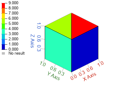

set(h,'cdata',[0 9 6 4])
set(h,'facecolor', 'flat')
set(gca,'contourtype','discrete')

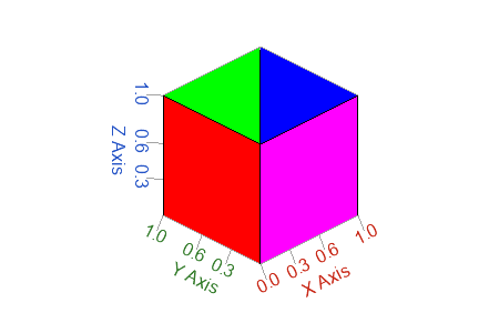

figure;
h = patch(x, y, z, 'r');
% set an rgb color for each face
cdata =[];
cdata(:,:,1) = [255 0 0 255]; % red component
cdata(:,:,2) = [0 0 255 0]; % green component
cdata(:,:,3) = [255 255 0 0]; % blue component
set(h,'cdata',cdata)
Figure 13. Patch color defined by a scalar value per face
Figure 14. RGB color per face
