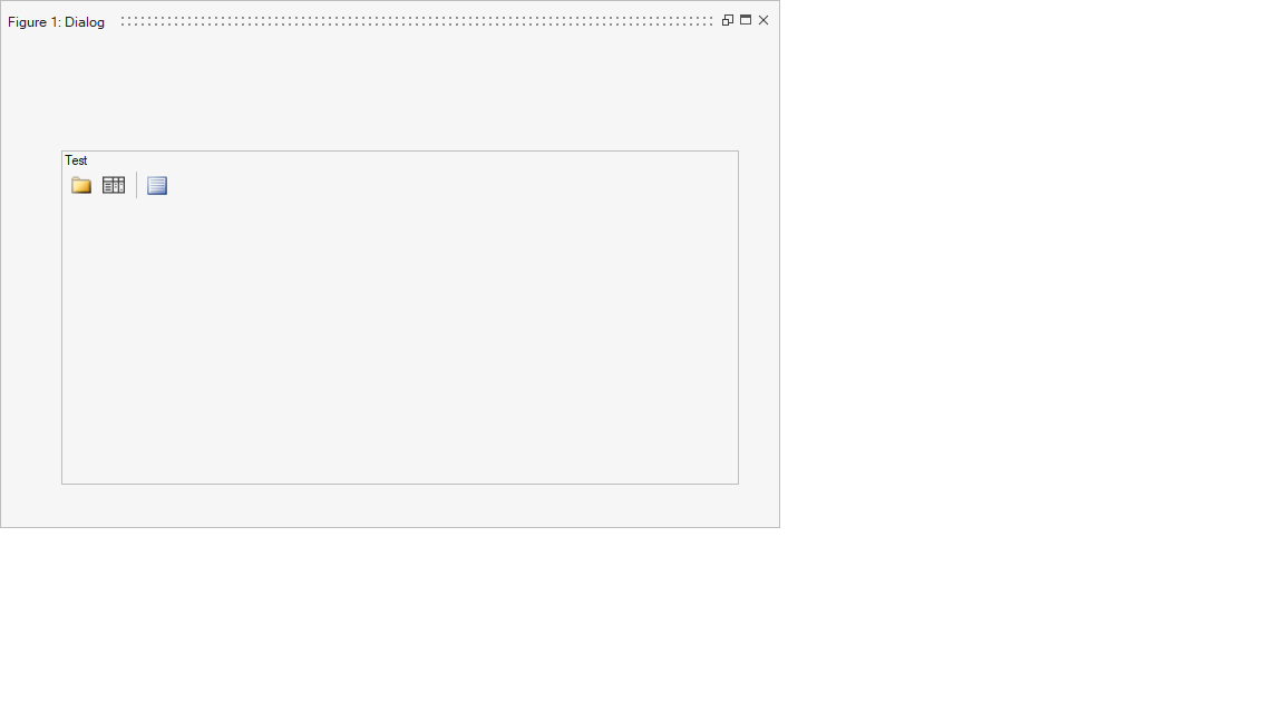

Dialog = figure('units', 'pixels', 'position', [0 0 700 474] ...
, 'name','Dialog', 'windowstyle','undocked');
uiPanel = uipanel('parent', Dialog, 'units','normalized', 'position',[0.07 0.24 0.89 0.69], 'title','Test');
toolbar = uitoolbar(uiPanel);
% uipushtool with an icon
pushtool1 = uipushtool(toolbar, 'iconpath', 'msfolder.png');
% uipushtool with a separator
pushtool2 = uipushtool(toolbar, 'iconpath', 'TableView-16.png', 'separator', 'on');
% uipushtool with a callback
pushtool3 = uipushtool(toolbar, 'iconpath', 'mslist.png', 'clickedcallback','pushtool3_callback');
Figure 1. Toolbar with toolbuttons in a uipanel
