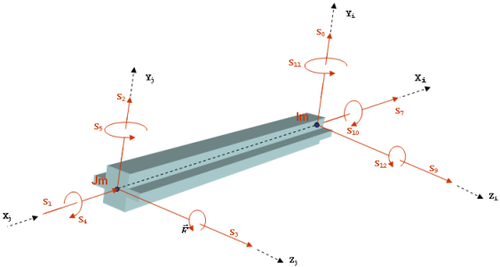

  1. The Timoshenko beam includes the effect of the shear stresses on transverse deformation; the Euler-Bernoulli beam does not. A constant shear over the beam height is assumed.
    Figure 1 shows the definitions associated with a Force_Beam element.
  2. The x-axis of the J_Reference_Marker defines the neutral axis of the beam. The y- and z-axes of the J_Reference_Marker define the principal axes of the cross section. In other words, those directions along which the products of inertia Iyz = 0.
  3. At zero deformation, the I_Reference_Marker is offset along the x-axis of J_Reference_Marker by a distance equal to the free length of the beam. It has the same orientation as J_Reference_Marker.
    The following forces act on the beam.
  4. Axial forces S1 and S7.
    • Shear forces S2, S3, S8 and S9.
    • Bending moments S5, S6, S11 and S12.
    • Twisting moments S4 and S10.
    Figure 1. The definition of Force_Beam

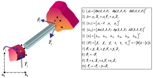

  12. Figure 2 shows an exploded view of a Force_Beam acting between two bodies. The exploded view is used to explain the implementation details of a Force_Beam.
    • Equations 1-4 show how the deformations are calculated.
    • Equations 5-6 defines the force implementation.
    • The last four equations, 7-10, show the forces and torques generated by the Force_Beam element are applied to the two bodies.
    Figure 2. Implementation of a Force_Beam
