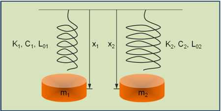

The concept of numerical stiffness is explained using the simple example shown below.
The figure below depicts two unconnected spring-mass systems. The first system has a mass M1 supported by a spring with properties K1, C1 and L01. The second system has a mass M2 supported by a spring with properties K2, C2 and L02. The displacement of mass M1, measured with respect to a global coordinate system, is denoted as x1. The displacement of mass M2, measured with respect to a global coordinate system, is denoted as x2.
Assume:- M1=1Kg, C1=2 N sec/m and K1=104 N/m
- M2=1Kg, C2=2x104 N sec/m and K2=108 N/m
Figure 1. Two Unconnected, Simple Spring-mass SystemsFor each system, i, the following are easily ascertained:- The equation of motion for system-i is:
(1) - The eigenvalues for system-i are:
(2) - The eigenvalues and response for the first system is:
(3) - The eigenvalues and response for the second system is:
(4)
System 1 is under-damped. It will display decaying oscillations in response to an initial disturbance. After 0.01 seconds, the initial disturbance is reduced by a factor = e-0.01 = 0.99 of the original value. System 1 oscillates at a frequency of 99.995 radians/sec.
In contrast, system 2 is over-damped. After 0.01 seconds, the initial disturbance is reduced by a factor = e-100 = 3.72 x 10-44 of the original value. For any initial disturbance, system response is almost instantaneously damped out. System 2 does not oscillate at all.
A system exhibiting these characteristics is called numerically stiff. One component of the solution exhibits slow decay to an initial excitation whereas another component rapidly dies almost instantaneously.

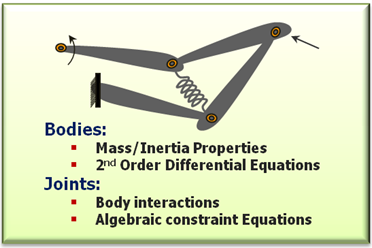

- Differential Algebraic EquationsA system of equations, which is a combination of ordinary differential equations (ODE), and algebraic constraint equations are called differential algebraic equations (DAE).
Figure 2. A Multibody system.For example, in a multibody system (MBS), Newton's second law manifests itself in the form of second order, ordinary differential equations (ODE) while constraints in the system (joints, for example) manifest themselves as algebraic equations (AE). Hence, the mathematical representation of a typical multibody system is a system of differential algebraic equations (DAE). The mechanism shown in the figure above is usually characterized by differential algebraic equations.

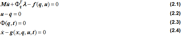

Under these assumptions, the equations of motion for the system can be represented
as:
The above equations are called the Euler-Lagrange representation of the equations of motion. In matrix form, equation (1) can be written as:
Equations (2.1) represent the force balance equations. The first term represents the inertia force, the second term represents the constraint forces and the third term the generalized external forces. Equations (2.1) are thus a restatement of Newton's Second Law of Motion. Equations (2.1) are a differential equation that relates the time derivative of velocity (acceleration) to the external and internal forces acting on the system.
Equations (2.2) represent the kinematic differential equations in the system. These equations represent the equations of motion in first order form. To accomplish this, a new set of variables, u, the velocities are created. Velocities are defined as first-time derivatives of displacements. Equations (2.2) are also differential equations.
Equations (2.3) represent the algebraic constraints in the system. These come into existence because the equations were not formulated in terms of an independent coordinate set. The system has p=N-M degrees of freedom. The N coordinates therefore can be related to each other through M algebraic constraint equations.
Equations (2.4) represent the user-defined differential equations, specified using Control_Diff, Control_SISO, and Control_StateEqn elements. The user-defined states are denoted by x.
Equations (2) are a set of implicit, differential-algebraic equations (DAE). Let Z = [u, q, λ, x]T. Equations (2) can be represented in compressed notation as:

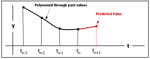

- PredictThe purpose of the predictor is to provide a good initial guess for the corrector. The predictor fits a polynomial through the previously calculated solution points. It then extrapolates the polynomial to the new value of time to "predict" the solution, as shown below.
Figure 4. The Predictor - Correct
The purpose of the corrector is to refine the prediction iteratively until it satisfies the equations of motion. This iterative refinement process often involves the use of methods such as the Newton-Raphson method.

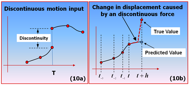

- My model fails due to integrator failures. How can I diagnose
this issue and fix it?
Multi-step integrators, like DSTIFF and others, estimate the local error at each step by computing the difference between the predicted and the corrected value of the solution, and scaling it by an "error coefficient" that is calculated by the integrator. A bad prediction can therefore cause an integration error.
Predictions can be inaccurate for two reasons:- There is a discontinuous motion input in the system.
- There is an almost discontinuous force in the system.
The effect of such modeling is shown below.
Figure 5. Discontinuities are the root cause of integration failures.Discontinuities such as those shown above can be caused by function expressions or user subroutines that use IF-THEN-ELSE logic carelessly. Modeling elements that should be examined for discontinuities or sharp changes include:- Forces
