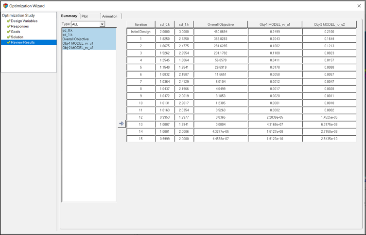

In this step, you will post-process the results of optimization.
