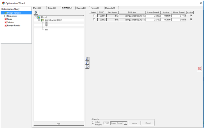

Under the Design Variables page, click on the
Springs tab.
Make the k and c of SpringDamper
0 design variables. Select k and c
datamembers from the Model Tree under the spring damper
and click Add.
Modify the upper and lower bounds of the design variables according to Table 1.
Table 1.
DV
Lower Bounds
Upper Bounds
sd_0.k
0.2
1.0
sd_0.c
0.2
1.0
