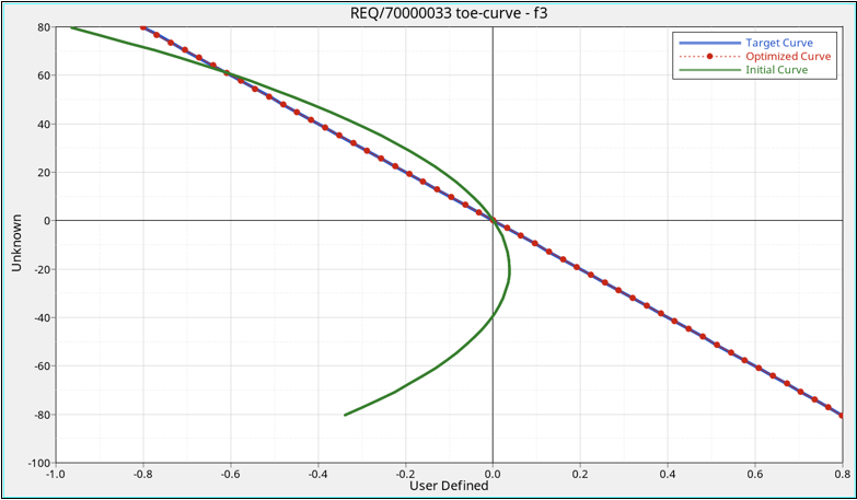

- In this tutorial, you will reproduce the suspension optimization problem in MV-3010 (Optimization using MotionView - HyperStudy). The location (y and z coordinates) of both inner tie-rod ball joint and outer tie-rod ball joint are changed so that the toe vs. ride height curve matches a given desired target curve.
Figure 1. Suspension Topology to Optimize
Figure 2. ‘Toe-ride height’ curve of initial design, optimized design and target design
