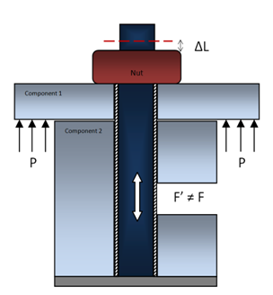

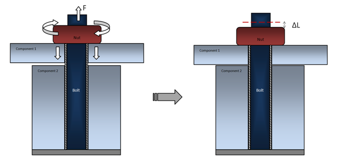

Many engineering assemblies are put together using bolts, which are usually pretensioned before application of working loads. A typical sequence is described below. For further detailed information, refer to Pretensioned Bolt Analysis in the User Guide.
In Step 1, upon preliminary assembly of the structure, the nuts on respective bolts are tightened, usually by applying prescribed torque (which translates into prescribed tension force according to the pitch of the thread).
As a result, the working part of the bolt becomes shorter by a distance ΔL MathType@MTEF@5@5@+=feaagKart1ev2aaatCvAUfeBSjuyZL2yd9gzLbvyNv2CaerbuLwBLnhiov2DGi1BTfMBaeXatLxBI9gBaerbd9wDYLwzYbItLDharqqtubsr4rNCHbGeaGqiVu0Je9sqqrpepC0xbbL8F4rqqrFfpeea0xe9Lq=Jc9vqaqpepm0xbba9pwe9Q8fs0=yqaqpepae9pg0FirpepeKkFr0xfr=xfr=xb9adbaqaaeGaciGaaiaabeqaamaabaabaaGcbaGaaeiLdiaadYeaaaa@37E1@ . This distance depends upon the applied force, the compliance of the bolt and of the assembly being pretensioned.
Figure 2. Step 1 of Pretensioned Assembly. Application of Pretensioning Loads
From the perspective of FEA analysis, it is important to recognize that:
  • Pretensioning actually shortens the working part of the bolt by removing a certain length of the bolt from the active structure (in reality this segment slides through the nut, yet the net effect is the shortening of the working length of the bolt). At the same time the bolt stretches, since now the smaller effective length of the bolt material has to span the distance from the bolt mount to the nut.
  • Calculation of each bolt's shortening ΔL MathType@MTEF@5@5@+=feaagKart1ev2aaatCvAUfeBSjuyZL2yd9gzLbvyNv2CaerbuLwBLnhiov2DGi1BTfMBaeXatLxBI9gBaerbd9wDYLwzYbItLDharqqtubsr4rNCHbGeaGqiVu0Je9sqqrpepC0xbbL8F4rqqrFfpeea0xe9Lq=Jc9vqaqpepm0xbba9pwe9Q8fs0=yqaqpepae9pg0FirpepeKkFr0xfr=xfr=xb9adbaqaaeGaciGaaiaabeqaamaabaabaaGcbaGaaeiLdiaadYeaaaa@37E1@ , due to applied forces F, requires FEA solution of the entire model with the pretensioning forces applied. This is because the amount of nut movement, due to given force depends on the compliance of the bolts, of the assembly being bolted and is also affected by cross-interaction between multiple bolts being pretensioned.
At the end of Step 1, the amount of shortening ΔL MathType@MTEF@5@5@+=feaagKart1ev2aaatCvAUfeBSjuyZL2yd9gzLbvyNv2CaerbuLwBLnhiov2DGi1BTfMBaeXatLxBI9gBaerbd9wDYLwzYbItLDharqqtubsr4rNCHbGeaGqiVu0Je9sqqrpepC0xbbL8F4rqqrFfpeea0xe9Lq=Jc9vqaqpepm0xbba9pwe9Q8fs0=yqaqpepae9pg0FirpepeKkFr0xfr=xfr=xb9adbaqaaeGaciGaaiaabeqaamaabaabaaGcbaGaaeiLdiaadYeaaaa@37E1@ for each bolt is established and "locked", simply by leaving the nuts at the position that they reached during the pretensioning step.
In Step 2, with the shortening ΔL MathType@MTEF@5@5@+=feaagKart1ev2aaatCvAUfeBSjuyZL2yd9gzLbvyNv2CaerbuLwBLnhiov2DGi1BTfMBaeXatLxBI9gBaerbd9wDYLwzYbItLDharqqtubsr4rNCHbGeaGqiVu0Je9sqqrpepC0xbbL8F4rqqrFfpeea0xe9Lq=Jc9vqaqpepm0xbba9pwe9Q8fs0=yqaqpepae9pg0FirpepeKkFr0xfr=xfr=xb9adbaqaaeGaciGaaiaabeqaamaabaabaaGcbaGaaeiLdiaadYeaaaa@37E1@ of all the bolts "locked", other loads are applied to the assembly. At this stage the stresses and strains in the bolts will usually change, while the length of material removed ΔL MathType@MTEF@5@5@+=feaagKart1ev2aaatCvAUfeBSjuyZL2yd9gzLbvyNv2CaerbuLwBLnhiov2DGi1BTfMBaeXatLxBI9gBaerbd9wDYLwzYbItLDharqqtubsr4rNCHbGeaGqiVu0Je9sqqrpepC0xbbL8F4rqqrFfpeea0xe9Lq=Jc9vqaqpepm0xbba9pwe9Q8fs0=yqaqpepae9pg0FirpepeKkFr0xfr=xfr=xb9adbaqaaeGaciGaaiaabeqaamaabaabaaGcbaGaaeiLdiaadYeaaaa@37E1@ remains constant for each bolt.
Figure 3. Step 2 of Pretensioned Assembly. Application of Working Loads with 'Locked' Bolt Shortening

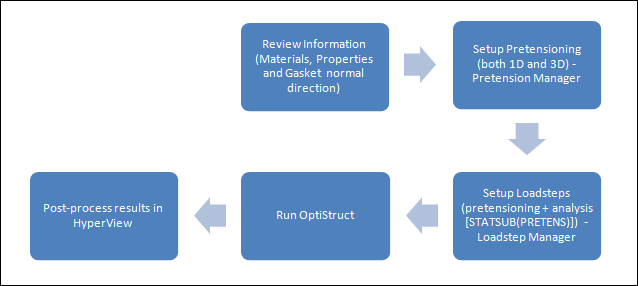

flowchart_tutorials
Figure 4. Tutorial Process Flow

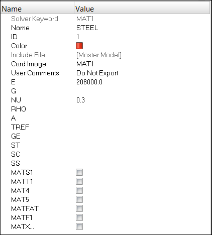

  1. In the Model Browser, right-click and select Expand All.
  2. Click on STEEL in the Model Browser under Material.
    The MAT1 entry is displayed in the Entity Editor with pre-populated field values.
  3. Make sure that the values on the MAT1 Bulk Data Entry for the material properties of steel are input as shown below.
    OS_1390_01
    Figure 5. Reviewing the Material - Steel

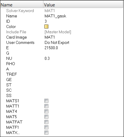

  4. Select MAT1_gask in the Model Browser.
  5. Make sure that the values on the MAT1 Bulk Data Entry for the material properties of the gasket are input as shown below.
    OS_1390_02
    Figure 6. Reviewing the Material - Gasket

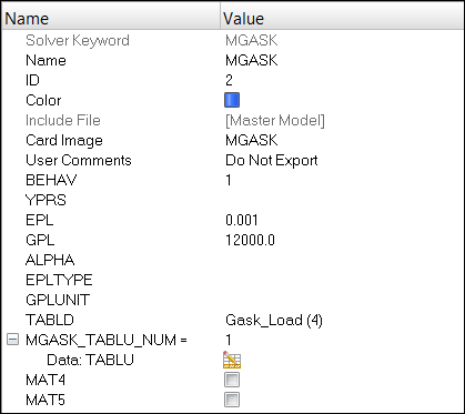

  6. Click on MGASK.
  7. Make sure that the values on the MGASK Bulk Data Entry for the material properties of the gasket are input as shown below.
    OS_1390_03
    Figure 7. Reviewing the Nonlinear Gasket Material Properties - MGASK
    Tip: The TABLD and TABLU(1) fields (Gasket loading and unloading paths) in Figure 7 are defined by TABLES1 Bulk Data Entries in separate curves named Gask_Load and Gask_Unload1, respectively.

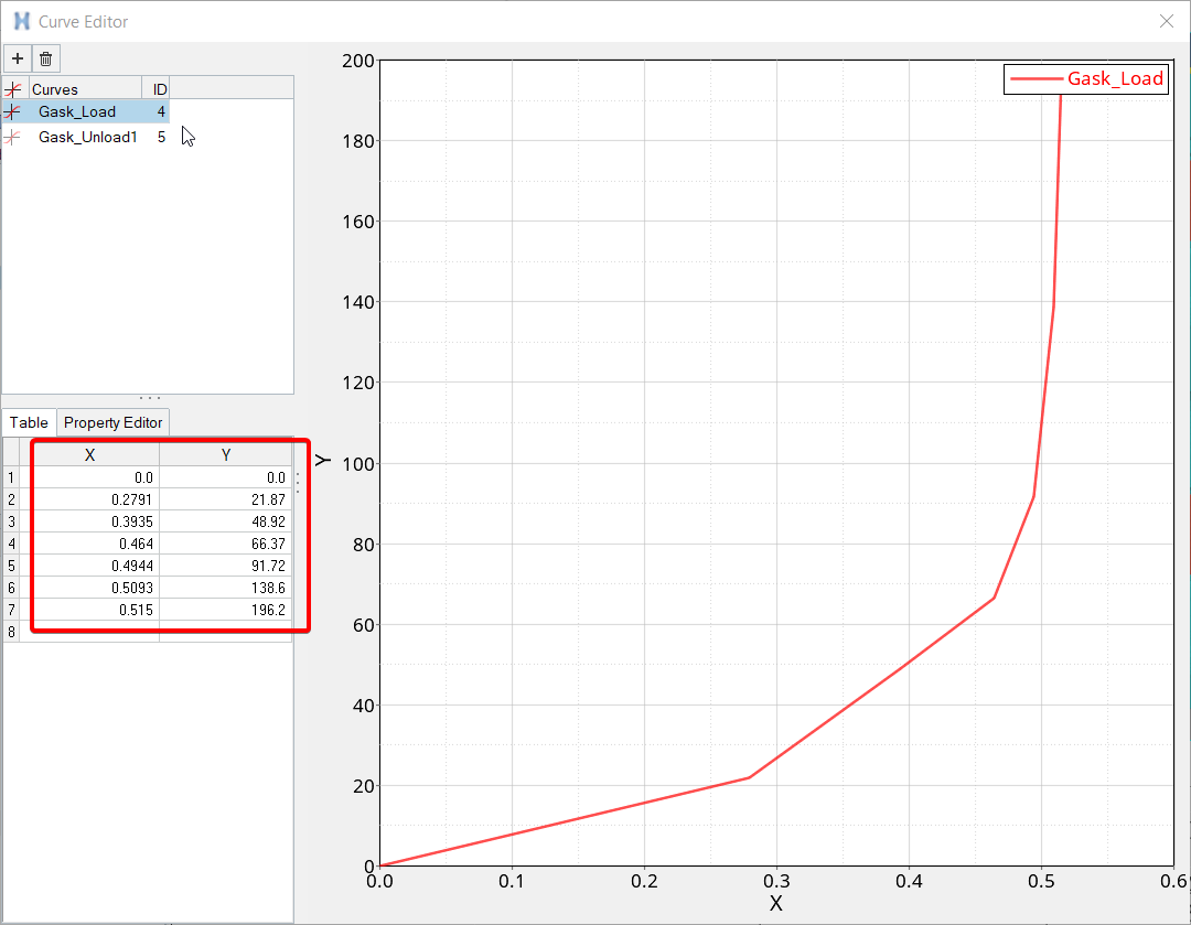

  8. Click on Gask_Load in the Curves folder and then right-click and select Edit to view the data.
  9. Make sure that the values on the TABLES1 Bulk Data Entry defining the gasket loading paths are input as shown below.
    OS_1390_04
    Figure 8. Reviewing the Gasket Loading Paths - TABLES1

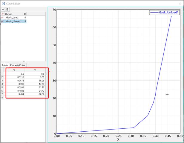

  10. Similarly, make sure that the values on the TABLES1 Bulk Data Entry defining the gasket unloading paths (curves Gask_Unload1) are input as shown below.
    OS_1390_05
    Figure 9. Reviewing the Gasket Unloading Paths - TABLES1

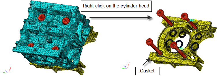

  13. Click on the Show/Hide icon, and right-click on the cylinder head to hide it from view.
    The gasket should now be visible.

  14. In a similar fashion, hide (right-click) the engine block from view to be able to better visualize the gasket normals.
  15. Click the Show/Hide icon again to deselect it and select the gasket directly from the modeling window and click display normals.

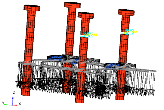

Apply 1D and 3D Bolt Pretensioning
Bolt pretensioning analysis determines the response of a system which contains bolts holding two or more components together as a result of pretensioning. In OptiStruct, pretensioning is applied in an earlier subcase and it is subsequently referenced to in the subcase where its effect is sought (STATSUB(PRETENS)).

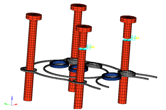

  1. In the Model Browser, right-click on Component and select Show from the context menu.
  2. Hide the CYLINDER_HEAD component by clicking the Elements icon next to it in the Model Browser.
    Tip: View1, A predefined visualization option, is included with this model under View in the Model Browser. Click on the monitor shaped icon next to View1; this loads a predefined view in the Model Browser allowing you to view all four bolts in the Y-Z plane. Two bolts have disc-shaped sections cut-off along its length. These bolts are then reconnected using 1D beam elements (CBEAM) and two rigid spiders (RBE2) per bolt. 1D pretensioning can now be applied to these two bolts. 3D pretensioning requires the creation of a surface at which pretensioning forces can be applied.
    view1
    Figure 14. Using the predefined visualization option View1
    A surface PT_Surf has been predefined to demonstrate 3D pretensioning on existing surfaces. To additionally demonstrate 3D pretensioning by creating a new surface, the fourth bolt is left unchanged.
    flowchart_bolt
    Figure 15. Bolt Pretensioning for this Tutorial Model

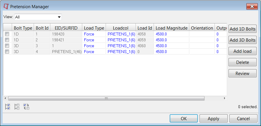

  3. From the menu bar, click Tools > Pretension Manager to access the Pretension Manager.

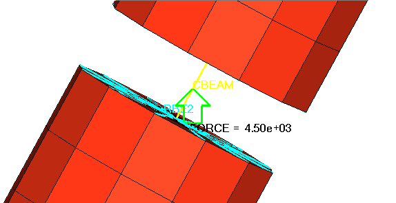

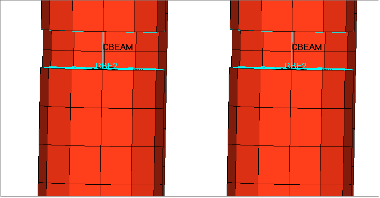

  4. Click on Add 1D Bolts and select the two 1D beam elements in bolts 1 and 2 (Figure 18).
    Tip: Care must be taken not to use Ctrl+left mouse click while zooming in and positioning the elements in the graphics area for selection. Using Ctrl+left mouse click can lead to the model being rotated about an axis and thus disengaging from the Y-Z plane of View1. It is recommended to only use Ctrl+right mouse click (dragging action) while working in View1.
    predefined_1d_element
    Figure 16. Selecting the Predefined 1D Elements for Pretensioning

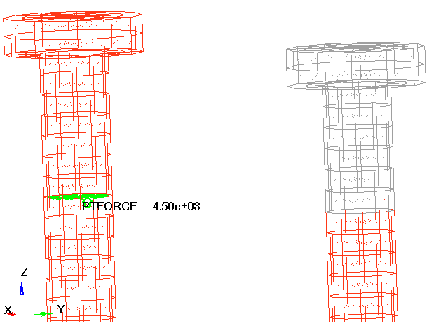

  5. Select both fields under the Load Type column in the Pretension Manager window (Click on the first field and then while holding down the Ctrl key, click on the second field). Click on the downward facing arrow next to the second field and select Force from the drop-down menu.
  6. In a similar fashion, enter 4500.0 for both bolts in the Load Magnitude column.
  7. Click Apply.

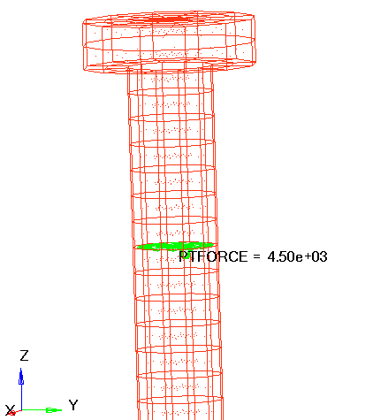

    A pretensioning force of 4500.0 N is applied to both 1D bolts, as shown in Figure 19.
    ptforce
    Figure 17. Pretensioning Force is Applied to 1D Elements (PTFORCE=4500 N)

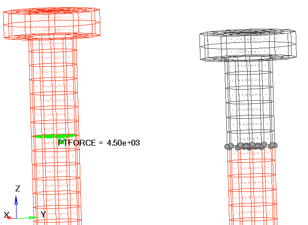

  8. Click on Add 3D Bolts and select Select Existing Surface from the drop-down menu.
  9. Click on the Wireframe elements skin only icon visualizationElementsWireframeSkinOnly-24 to view the predefined contact surface PT_Surf on the third bolt.
    Tip: If the predefined surface is not visible, then switch on (show) the PT_Surf entry in the Model Browser by clicking on the entityContactSurfaces-24icon next to it.
  10. Click on the displayed predefined surface in the bolt, as shown in Figure 20 and click proceed.
    predefined_pt_surf
    Figure 18. Selecting the Predefined PT_Surf Surface
  11. Select Force under the Load Type column and enter 4500.0N for the Load Magnitude column and click Apply.
    A pretensioning force of 4500.0 N is applied normal to the PT_Surf surface, as shown in Figure 21.
    pt_surf
    Figure 19. Applying a pretensioning force of 4500 N to the predefined surface PT_Surf on the third bolt

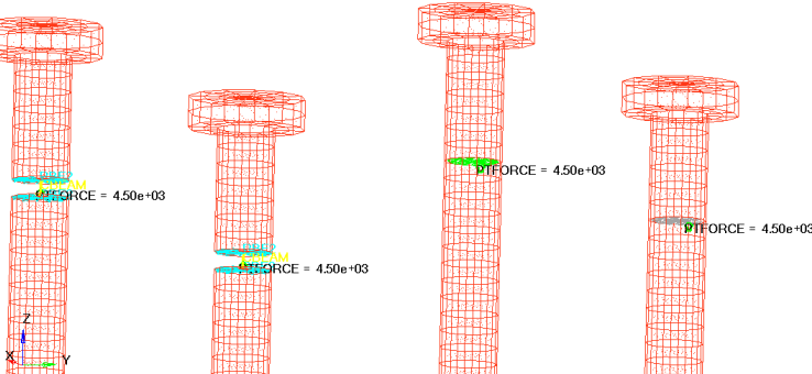

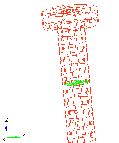

  12. Click on Add 3D Bolts and select Create New Surface from the drop-down menu.
  13. Toggle 3d faces into elems in the panel below the graphics area.
    Tip: Utilize the click and drag technique (while holding down the Shift key) described previously to select the top of the fourth bolt, as shown in Figure 22.
    surface_create
    Figure 20. Creating a New Surface for Pretensioning
  14. Click on nodes in the panel below the graphics area and select all the nodes in the surface perpendicular to the Y-Z plane, as shown in Figure 23.
    Tip: The same click and drag technique can be used to select these nodes (draw a window encompassing the line as the perpendicular surface is a line in the Y-Z plane).
    nodes_selecting
    Figure 21. Selecting the nodes necessary to create a pretensioning surface
  15. Click create > return to return to the Pretension Manager.
  16. Select Force under the Load Type column and enter 4500.0 N for the Load Magnitude and click Apply.
    pretension_mgr
    Figure 22. Pretension Manager with all Four Pretensioned Bolts

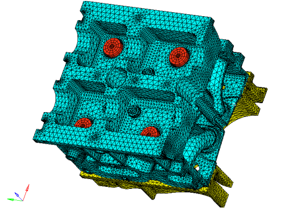

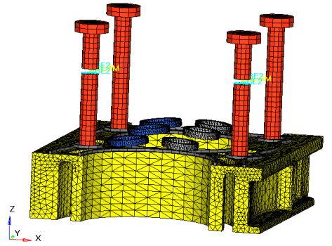

  17. Click OK in the Pretension Manager to view all four bolts with their respective pretensioning forces, as shown in Figure 25.
    reviewing_bolts
    Figure 23. Reviewing the Four Pretensioned Bolts

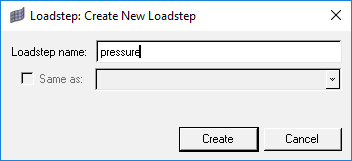

  11. Right-click on Loadsteps in the Loadsteps Browser and select New loadstep.
  12. In the Loadstep name: field, enter Pressure and click Create.
    Figure 25. Creating the Pressure Loadstep

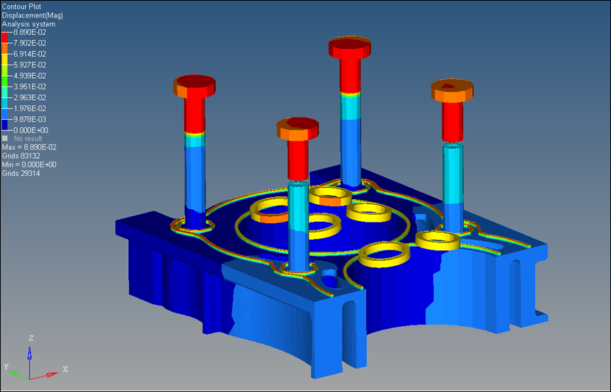

View the Results
  1. When the message Process completed successfully is received in the command window, click HyperView. HyperView is launched and the results are loaded.
    A message window appears to inform of the successful model and result files loading into HyperView.
  2. Click Close to close the message window, if one appears.

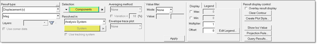

  3. Click the Contour toolbar icon resultsContour-16.

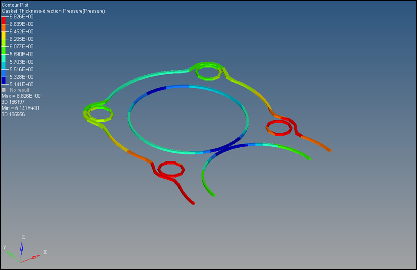

  4. Select the first pull-down menu below Result type: and select Displacement(v).
    hv_contour_plot
    Figure 27. Contour plot panel in HyperView
  5. Click Apply, select Subcase 2 (Pressure) from the Results Browser.
    A contour plot of displacements is created, as shown in Figure 29. The cylinder head is hidden to view the displacement plots for the head bolts.
    displacement_pressure
    Figure 28. Displacement Contour for the Pressure Subcase after Pretensioning
    In Figure 29, the displacement plot after running the pressure subcases can be seen. The maximum displacement is around 0.089 mm and it occurs in the region near the pretensioned bolt heads.
  6. Select Gasket Thickness-direction Pressure in the Contour panel and click Apply.
    A contour plot of gasket pressure in the thickness direction is created, as shown in Figure 30. The other components are hidden to be able to better view the pressure variation on the gasket.
    gasket_pressure
    Figure 29. Gasket pressure in the thickness direction for the Pressure subcase
    Checkpoint
    The maximum pressure on the Gasket in the thickness direction is equal to 0.21 MPa.
