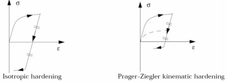

Chard Plasticity Iso-kinematic hardening factor.
= 0
Hardening is full isotropic model.
= 1
Hardening uses the kinematic Prager-Ziegler model.
= between 0 and 1
Hardening is interpolated between the two models.
Default = 0.0 (Real)

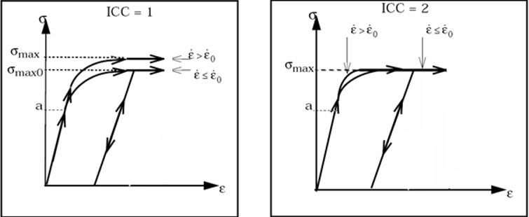

  6. ICC is a flag of the strain rate effect on material maximum stress σmax :
    law_plaszeril
    σ=σy(1+(ε˙c)1/p) σ=σy(1+(ε˙c)1/p)
    σmax=σmax0(1+(ε˙c)1/p) σmax=σmax0
