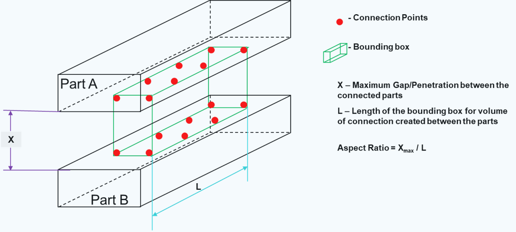

 - Resolution
 - This is the user specified resolution level used in the gap search algorithm. Possible values are Normal, Increased and High. Note that Increased is 4X and High is 16X the resolution of Normal search.
 - # of points
 - This is a relative measure of the accuracy of the connection representation. Higher numbers are better. Connections with thin cross sections and low # of points may cause hinges and numeric instability.
Aspect Ratio
