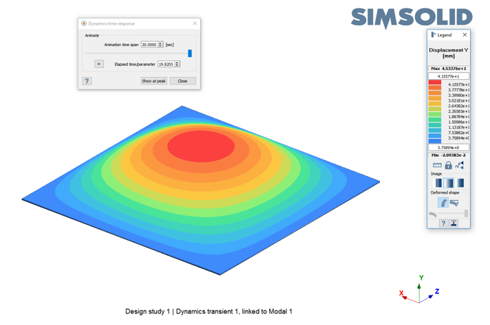

The plate is simulated as a 3D solid body. Spot-lines were created at the mid-plane of the plate in order to apply hinge supports (Figure 1).
Peak response is reached when excitation frequency becomes equal to first natural frequency of the plate. It occurs 19.82 seconds after the beginning of the excitation.
The following table contains peak response comparison.
Deflection Y, mm Surface Stress, MPa
45.34 31.86 SimSolid, solid model
45.42 35.08 Reference, thin plate model
