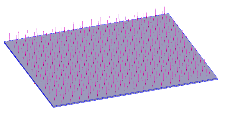

A simply supported thin square plate 10 x 10 x 0.05 m is subject to uniform pressure P=100 Pa which changes in time as the following function.(1)
P=100sin(ωt)

The plate is simulated as a 3D solid body. Spot-lines were created at the mid-plane of the plate in order to apply hinge supports (Figure 1).
