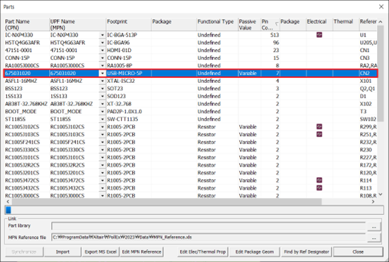

Assign SerDes Model to Connector
In the Parts dialog, double-click
675031020.

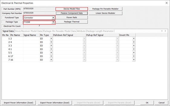

The Electrical & Thermal Properties dialog displays.
Figure 1. - Select Connector as a Functional Type.
- Select TO268 as a Package Type.
Click Device Model Files.

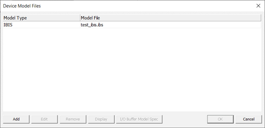

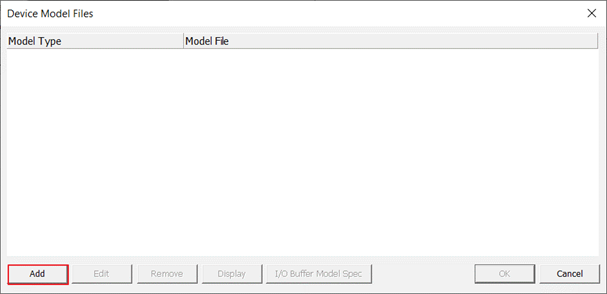

The Device Model Files dialog displays.
Figure 2. -
Click Add.
Figure 3. -

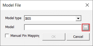

Click
to search and select the IBIS file (C:\ProgramData\altair\PollEx\<version>\Examples\Solver\SI\Simulation_Model\test_ibis.ibs) for the receiver device (RX) and click Open to open this file and close this Explorer window.
Figure 4. -
Click OK to close the Model Files
dialog.
Figure 5. -
To close the Device Model Files dialog, click
OK.

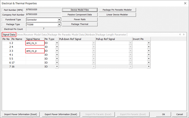

Please note that the signal name in the Signal Data tab is optional. If the user desires to write, they can fill in the Signal name. Below are some examples of Signal names for reference.

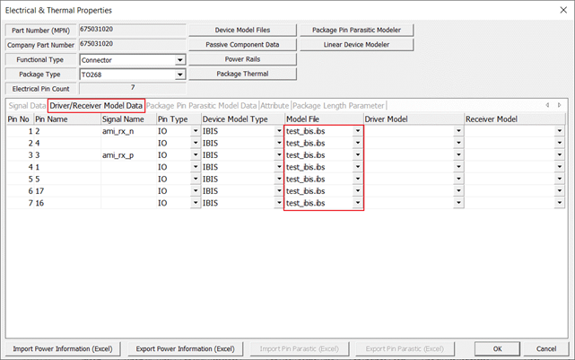

Figure 7.This is the tab of the Driver/Receiver Model Data.

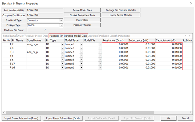

Figure 8.This is the tab of the Package Pin Parasitic Model Data.
