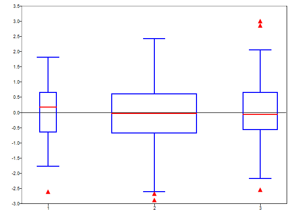

clf;
mat = randn(400,1);
groups = [ones(1, 50), 2*ones(1, 250), 3*ones(1, 100)];
[s, h] = boxplot(mat, groups, 'capwidths', 2, 'symbol', '^');
Figure 2. Dataset groups

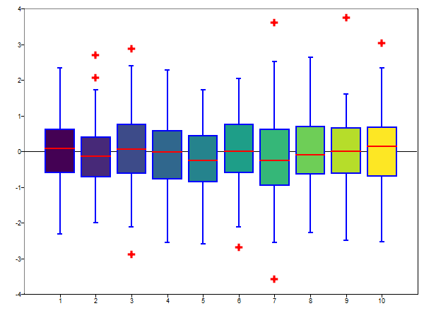

mat = randn(100,10);
[s, h] = boxplot(mat, 'boxstyle', 'filled', 'colors', viridis(10));
Figure 4. Box plot colors

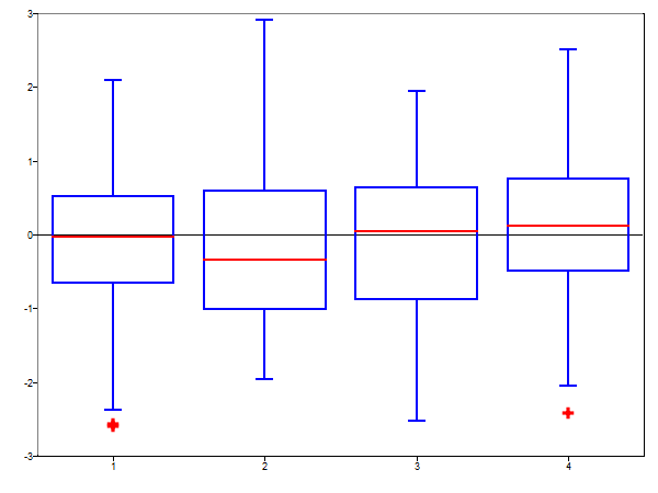

mat = randn(100,4);
[s, h] = boxplot(mat, 'labels', {'A', 'B', 'C', 'D'}, 'outliertags', 'on');
Figure 5. Custom x labels, display outlier tags

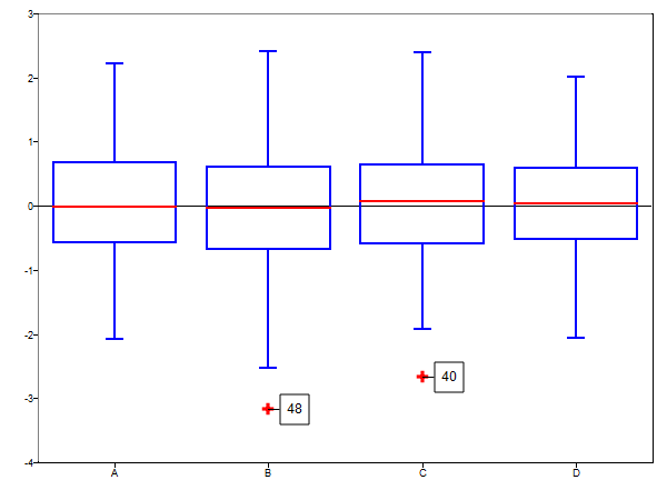

clf;
mat = randn(100,4);
[s, h] = boxplot(mat);
set(h.whisker,'linestyle','--');
Figure 6. Change the whisker line style
