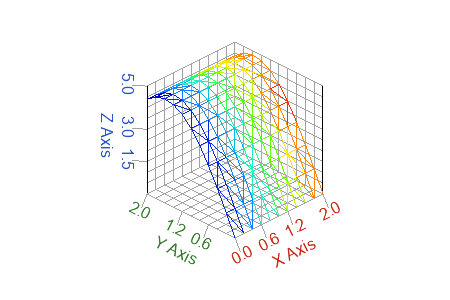

Examples
[x, y] = meshgrid([0:0.2:2]);
z = sin(x)'*cos(y);
tri = delaunay (x(:), y(:));
figure;
h = trimesh(tri, x, y, z);
Figure 1. Simple trimesh example

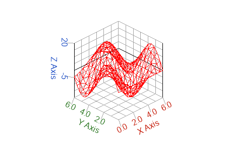

[x, y] = meshgrid([0:0.4:2*pi]);
z=sin(x')*cos(x);
figure;
set(h,'edgecolor','r')
Figure 2. trimesh color

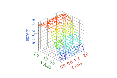

z = sin(x)'*cos(y);
figure;
% cdata is a scalar per vertex
cdata = x(:);
h = trimesh(tri, x, y, z, cdata);

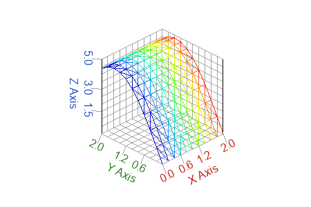

figure;
% the edge color is interpolated
set(h, 'edgecolor','interp');
Figure 3. cdata per vertex
Figure 4. cdata per vertex, color is interpolated

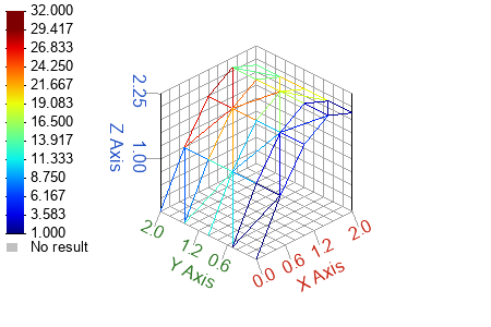

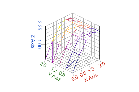

[x, y] = meshgrid([0:0.5:2]);
z = cos(y)'*sin(x);
figure;
% cdata is a scalar per triangle
cdata = 1:size(tri)(1);
colormap(jet(12))
colorbar;
figure;
% cdata is an rgb color per triangle
cdata = plasma(size(tri)(1));
Figure 5. Scalar cdata per triangle
Figure 6. RGB color per triangle
