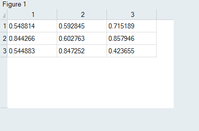

Display matrix data in a table:
uitable('data', rand(3, 3));

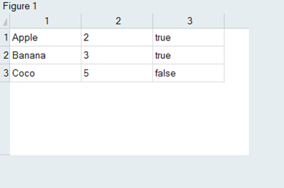

Display cell array data in a table:
uitable('data', {'Apple',2,true;'Banana',3,true;'Coco',5,false});
