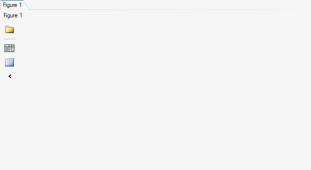

Examples
handle = uitoolbar ('orient', 'vertical'); % Toolbar
pushtool1 = uipushtool(handle, 'iconpath', 'msfolder.png', 'separator', 'on');
pushtool2 = uipushtool('iconpath', 'TableView-16.png'); % Adds to current toolbar
pushtool3 = uipushtool(handle, 'iconpath', 'mslist.png');
pushtool4 = uipushtool(handle, 'iconpath', 'left.png');
Figure 1. Vertical uitoolbar in the current figure

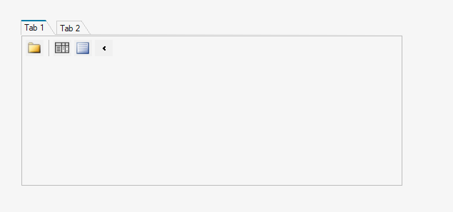

% Figure
Dialog = figure('units', 'pixels', 'position', [0 0 734 459], 'name','Dialog');
% Tab group
tabWidget = uitabgroup('parent', Dialog, 'units','normalized', 'position',[0.07 0.33 0.75 0.56]);
% Tab 1
tab = uitab('parent', tabWidget, 'title','Tab 1');
% Tab 2
tab_2 = uitab('parent', tabWidget, 'title','Tab 2');
set(tabWidget, 'selectedtab', tab);
toolbar = uitoolbar(tab);
pushtool1 = uipushtool(toolbar, 'iconpath', 'msfolder.png', 'separator', 'on');
pushtool2 = uipushtool(toolbar, 'iconpath', 'TableView-16.png'); % Adds to current toolbar
pushtool3 = uipushtool(toolbar, 'iconpath', 'mslist.png', 'clickedcallback','pushtool3_callback');
toggletool1 = uipushtool(toolbar, 'iconpath', 'left.png');
Figure 2. Horizontal toolbar in a tab
