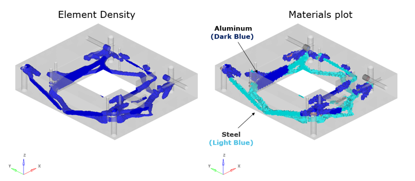

  • Case 1:
    Objective: Topology optimization to minimize the mass considering multiple materials (steel + aluminum)
    The optimization result includes both materials, steel, and aluminum, placed at the optimal locations.

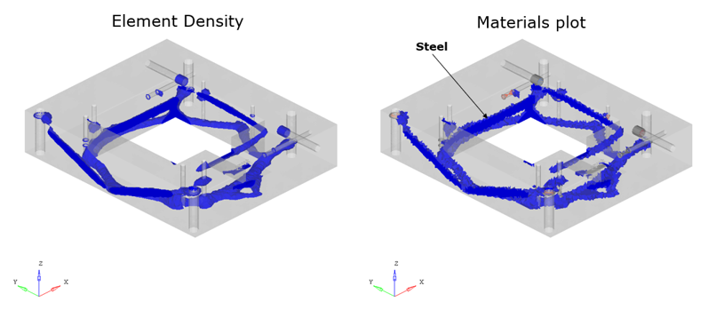

  • Case 2:
    Objective: Topology optimization to minimize the relative maximum between mass and cost considering multiple materials.
    It is considered that aluminum is 1.5 times more expensive per mass than steel using the function f(x,y)=x+1.5y MathType@MTEF@5@5@+=feaagKart1ev2aaatCvAUfeBSjuyZL2yd9gzLbvyNv2CaerbuLwBLnhiov2DGi1BTfMBaeXatLxBI9gBaerbd9wDYLwzYbItLDharqqtubsr4rNCHbGeaGqiVu0Je9sqqrpepC0xbbL8F4rqqrFfpeea0xe9Lq=Jc9vqaqpepm0xbba9pwe9Q8fs0=yqaqpepae9pg0FirpepeKkFr0xfr=xfr=xb9adbaqaaeGaciGaaiaabeqaamaabaabaaGcbaGaamOzamaabmaabaGaamiEaiaacYcacaWG5baacaGLOaGaayzkaaGaeyypa0JaamiEaiabgUcaRiaaigdacaGGUaGaaGynaiabgEHiQiaadMhaaaa@4213@ .
    The optimization result favors the cheaper material, in this case, steel, no aluminum is used, due to cost.

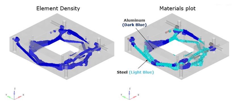

  • Case 3:
    Objective: Topology optimization to minimize the relative maximum between mass and cost considering multiple materials, as well as retaining a certain amount of steel.
    It is considered that aluminum is 1.5 times more expensive than steel using the function f(x,y)=x+1.5y MathType@MTEF@5@5@+=feaagKart1ev2aaatCvAUfeBSjuyZL2yd9gzLbvyNv2CaerbuLwBLnhiov2DGi1BTfMBaeXatLxBI9gBaerbd9wDYLwzYbItLDharqqtubsr4rNCHbGeaGqiVu0Je9sqqrpepC0xbbL8F4rqqrFfpeea0xe9Lq=Jc9vqaqpepm0xbba9pwe9Q8fs0=yqaqpepae9pg0FirpepeKkFr0xfr=xfr=xb9adbaqaaeGaciGaaiaabeqaamaabaabaaGcbaGaamOzamaabmaabaGaamiEaiaacYcacaWG5baacaGLOaGaayzkaaGaeyypa0JaamiEaiabgUcaRiaaigdacaGGUaGaaGynaiabgEHiQiaadMhaaaa@4213@ .
    Optimization gives both steel and aluminum, since the mass of steel is limited to 80% of the total mass.

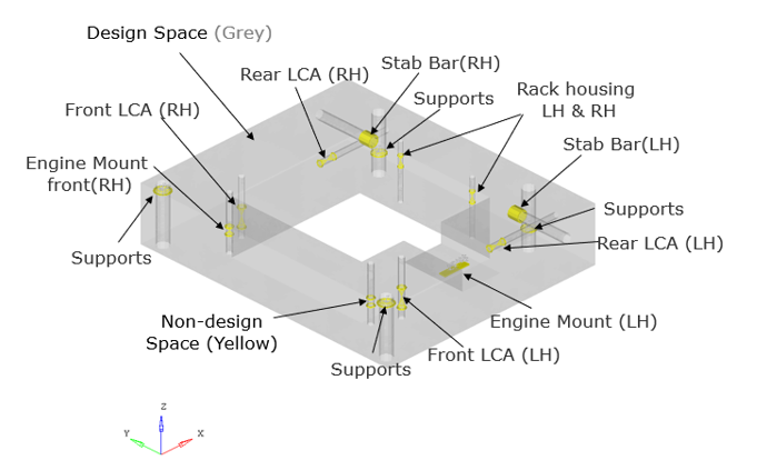

In this example, Multi-Material Topology Optimization is performed on the automotive cradle (aluminum + steel) model with 3 different objectives to fulfill.
Figure 1. Cradle Model with Constraints and Loading Conditions
  • Unit loads are applied at 10 locations in X, Y, and Z directions
  • Displacement constraints are applied at all the loading conditions, measured from the existing design

Figure 2. Case 1 Topology Optimization Results
Figure 3. Case 2 Topology Optimization Results
Figure 4. Case 3 Topology Optimization Results
