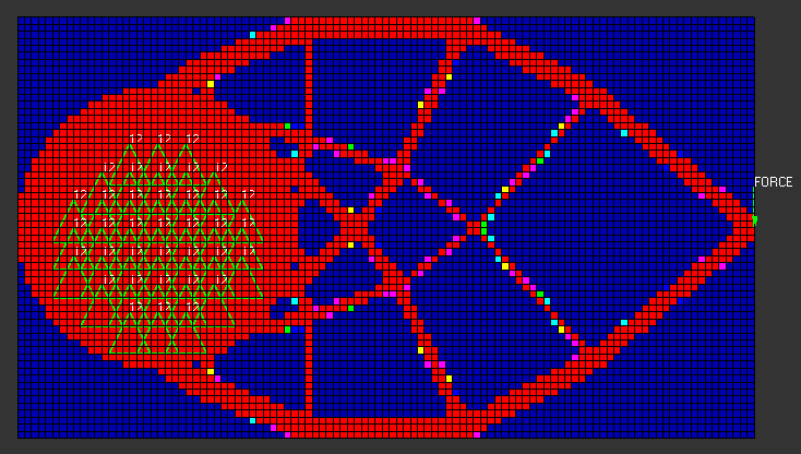

The two-dimensional Michell-truss is an optimal topology structure generated under bending.

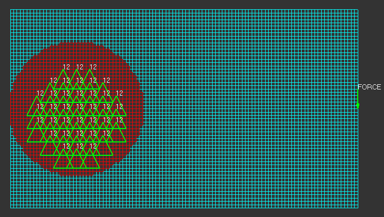

The design space for this problem consists of a rectangle with a single vertical load at the free end. A circular cut-out is constrained in all translational degrees-of-freedom on the inside free edge.
This is a compliance minimization problem with a material volume fraction constraint of 20%. CQUAD4 (4-noded isoparametric) elements are used in a design space defined by a rectangular region with an aspect ratio approximately equal to one quarter of the short edge located closer to the edge away from the load.
