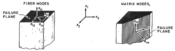

/FAIL/HASHIN
In HASHIN failure, two primary failure modes are considered.
  • Fiber Mode:
    Composite fails, due to fiber rupture in tension or fiber buckling in compression. So, in /FAIL/HASHIN, tensile/shear fiber mode, compression fiber mode and crush mode are the fiber modes. If direction 1 is the fiber direction, then plane 23 is the predominant failure plane for fiber mode.
  • Matrix Mode:
    Composite fails, due to matrix cracking from the fiber. Failure matrix mode (or shear failure matrix mode) and delamination mode are both matrix modes. The failure plane for matrix mode is parallel to the fiber, and stress σ11 will not be considered in this mode.
Figure 1. Fiber modes and matrix modes for uni-directional lamina model
Fibers in uni-directional lamina model 1 are only in one direction and in fabric lamina model are in two directions.

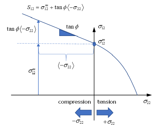

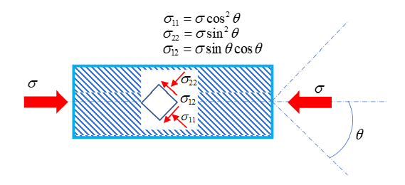

ϕ is the Coulomb friction angle. It is observed that composite shear strength is higher if the composite is also under compression (rather than under tension). This is due to the friction between matrix and fiber.
The shear strength is assumed to be proportional to compression stress and is computed as:(1) S12=σm12+σ22tanϕ
Friction angle ϕ may be fitted with an Off-Axis compression test with different angles θ (for example, 30,45,60, …).
Figure 3.

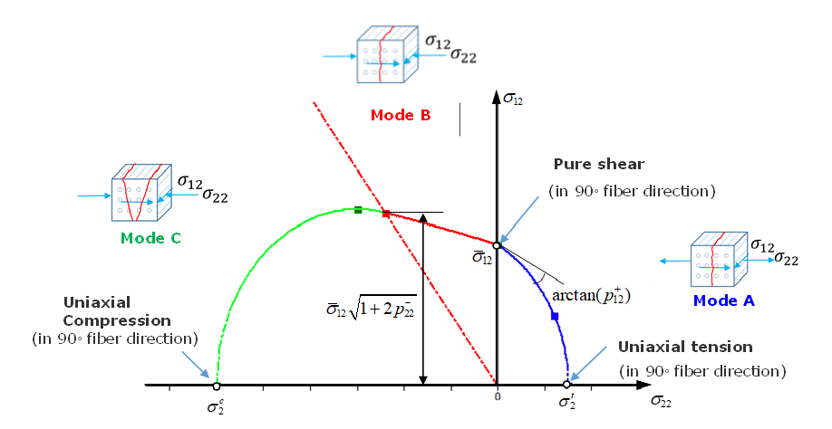

/FAIL/PUCK
In Puck failure, two types of failure are considered.
  • Fiber fracture: composite fails, due to the fiber reaching the tensile or compression strength limit.
  • Inter fiber failure (IFF): composite fails, due to the fiber matrix cracking.
Damage criteria If D=1, then failure.
If 0D<1 D, then no failure.
With D=Max(ef(tensile),ef(compression),ef(ModeA),ef(ModeB),ef(ModeC))
Fiber fraction failure Tensile fiber failure mode: σ11>0
ef(tensile)=σ11σt1
Compressive fiber failure mode: σ11<0
ef(compression)=|σ11|σc1
Inter fiber failure (IFF) 2 Mode A, if σ22>0:
fail_puck_modeA
Figure 4.
ef(ModeA)=1ˉσ12[(ˉσ12σt2p+12)2σ222+σ122+p+12σ22]
Mode C, if σ22<0:
fail_puck_modeC
Figure 5.
ef(ModeC)=[(σ122(1+p22)ˉσ12)2+(σ22σc2)2](σc2σ22)
Mode B:
fail_puck_modeB
Figure 6.
ef(ModeB)=1ˉσ12(σ212+(p12σ22)2+p12σ22)
In inter fiber failure, Mode A shows failure under tension in transverse fiber direction (90 degrees to fiber direction), and in this case, shear loading could reduce the failure limit.
If under compression in transverse fiber direction, at first increasing compression will increase composite shear loading (Mode B). If compression continues to increase, then shear loading will decrease (Mode C).
Input Parameters
For fiber fracture failure, you could obtain fiber strengths σt1,σc1 from tension and compression composite tests in the fiber direction.
For inter fiber failure, you could obtain strengths σt2,σc2 from tension and compression composite tests in the transverse fiber direction.
You could obtain shear strength ˉσ12 with a pure shear test (σ2=σ1=0).
With σt2,σc2,ˉσ12, then p22 and p12 for Mode C and Mode B may be determined.
With σt2,ˉσ12 and additional tension-shear tests in the transverse fiber direction, p+12 may be determined. The additional tension-shear test in transverse fiber direction could take equal tension-shear (by σ22=σ12) loading.
Then you may derive the fracture curve in σ22σ12 plane, as shown below.
Figure 7. IFF fracture curve in σ22σ12 plane
For p+12,p12,p22 parameters 3. For carbon fiber composite, use p+12=0.35,p12=0.3,p22=0.2 and for glass fiber composite, use p+12=0.3,p12=0.25,p22=0.2.

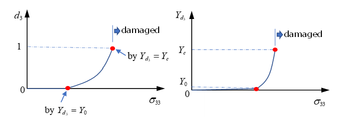

di
(with i=1,2,3), the damage variable.

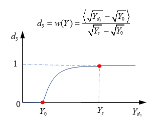

It has a range from 0~1. It starts to accumulate once the composite reaches Y0.
An example of Mode I, during traction in direction 3, at the beginning d3 always remains 0 until thermodynamic force Yd3 reaches Y0 (left figure).
Figure 11.
After Y0 is reached, the damage variable starts to increase and when it reaches 1, d3=1 (thermodynamic force Yd3 at this point then becomes the critical damage Yc). The composite could be considered as fully delaminated and may be deleted immediately or the stress may be reduced. In Radioss, the option τmax is used to simulate exponential function stress reduction nd the stress at Yc is σd(tr) (Stress Decrease in Damage).

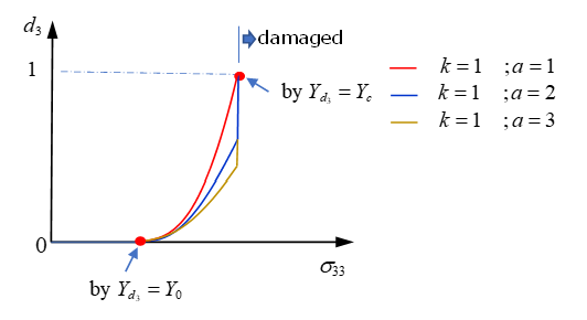

How quickly will the damage variable increase? The damage velocity ˙d (also called damage evaluation law) is computed as:
  • If d=1, then ˙d=const.
  • If d<1, then ˙d=ka[1exp(aw(Y)d)]
ka is the maximum damage rate, which means minimum duration of the failure phenomenon. Its reciprocal, ak is called the characteristic time, which may be obtained with a one-dimension tensile test. 7
Figure 13.
Through tensile sample with different stress to find the minimum time of composite damage Δt, the σΔt curve is vertical asymptote corresponding to the characteristic time ak.
Figure 14.
Parameters a and k govern the damage evaluation law. For example, with constant parameter a (here a=1), decreasing values of k leads to more brittle failure of the composite.
Figure 15.
With constant parameter k (here k=1), increasing values of a leads to more brittle failure of the composite.
Figure 16.

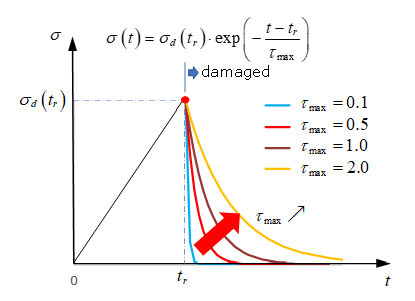

After reaching the damage criteria:
  • HASHIN:
    D=Max(F1,F2,F3,F4)1
  • PUCK:
    D=Max(ef(tensile),ef(compression),ef(ModeA),ef(ModeB),ef(ModeC))1
  • LAD_DAMA:
    d1
  • CHANG:
    D=Max(ef2,ec2,em2,ed2)1
Stresses start decreasing and decrease gradually by using an exponential function to avoid numerical instabilities.(5) σ(t)=σd(tr)f(t)       =σd(tr)exp(ttrτmax)
with, ttr
The option τmax controls how gradually the stress is decreased in damage.
Figure 17.
Where,
σd(tr)
Stress components when damage is reached D1.
tr
Time of σd(tr).
τmax
Time of dynamic relaxation.
The higher the value of τmax, the slower stress decreases during damage. Normally, it takes 10~20 time step.
