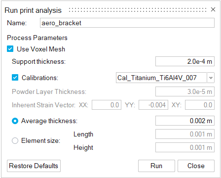

Process Parameters
Process parameters impact what result types are available at the end of the simulation, as well as the processing time and accuracy of results.
Inherent Strain
- Analysis Type
- The analysis type determines what result types will be available at the end of the simulation. Selecting Inherent Strain will generate results for displacement, Von Mises stress, collision distance, layer shifting, and failure index.
- Use Voxel Mesh
- Enable this option to use a voxel mesh instead of a tetrahedral mesh for a faster analysis with a less detailed result.
- Support thickness
- The thickness of a printed support's outer shell. The number will depend on the printer being used.
- Activation layer thickness
- The height which the solver simulates in each step. Usually, the real powder thickness is very small. You can define this parameter as the actual thickness of a single powder layer for accuracy, or choose a larger value (up to 20 times the single layer's thickness) to simulate more than one layer at once and reduce simulation time.
- Calibrations
- Enable this option to select available calibrations from the dropdown menu.
- Powder layer thickness
- For powder-based 3D printing processes, this indicates the thickness of the powder layer that is spread across the printing bed. This information is unique to the printer model and should be available from your 3D printer.
- Inherent Strain Vector
- This represents a symmetric tensor written in vector form, with components
[XX, YY, XY]. The values in these fields represent the material's shrinkage
in all directions as it cools. Note: These parameters are only available for Inherent Strain analyses in which the Calibrations option is not selected.
- Average thickness
- The simulation's results are shown as a tetrahedral mesh by default, or a voxel mesh if Use Voxel Mesh is enabled. You can enter either an average thickness or an element size for the mesh.
- Element size
- If you choose to define the mesh in terms of element size, enter a length and height. A good starting point is generally 1 x 1 mm. Reducing the element size improves accuracy, but increases the time of the analysis.
- Support element size
- Define the element size of the voxelized supports.
