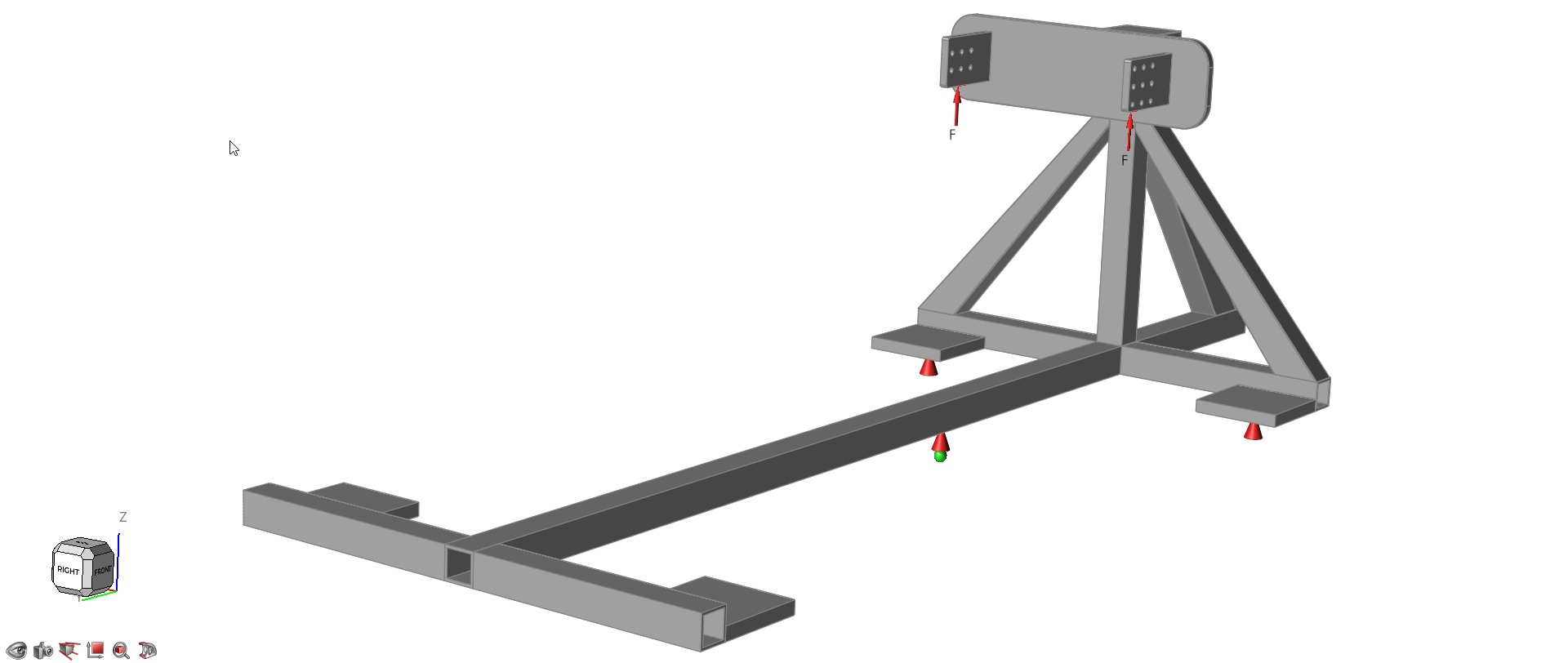

Open the DOE Model
- Press F7 to open the Demo Browser.
In the Structures folder, double-click the
Design_Explorer_DOE_Fixture.stmod file to load it in
the modeling window.
The model is loaded.

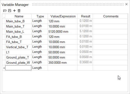

On the Geometry ribbon, select the Variables tool.
The Variable Manager is displayed.
These variables were generated when sketching. It is best practice to make sure that all parts are fully constrained in the model when creating geometric variables. For details on how to create variables, see Video Tutorial: Creating a Parametric Part.
- For Main_tube_L, confirm that the Length is 5120 mm.
- Close the Variable Manager.

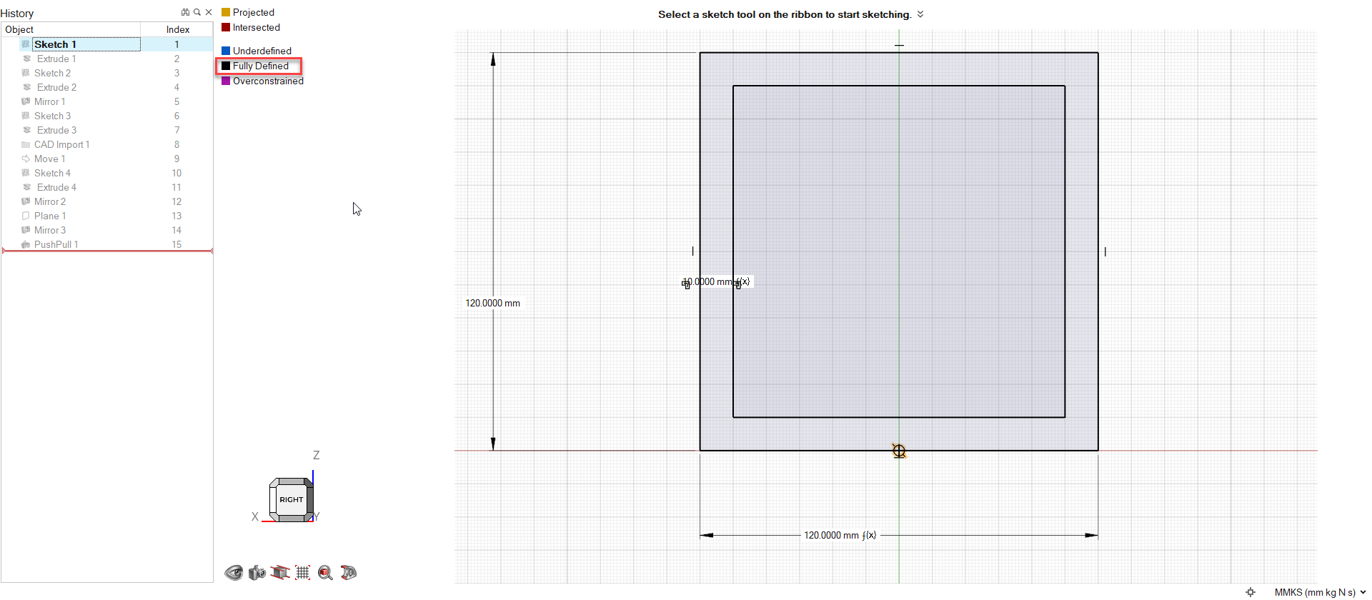

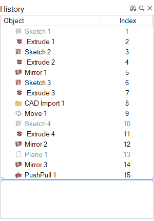

Press F6 to open the Construction History Browser.
Double-click Sketch 1. The sketch is black, indicating
that it is Fully Defined.

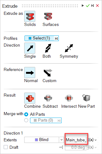

Double-click Extrude 1. This is where the
Main_tube_L variable was defined. To see the full
entry, in the guide panel, click in the Extents field and
scroll all the way to the left Main_tube_L=5120.0000 mm.
This portion of the model is fully defined.
- Close the Extrude tool.

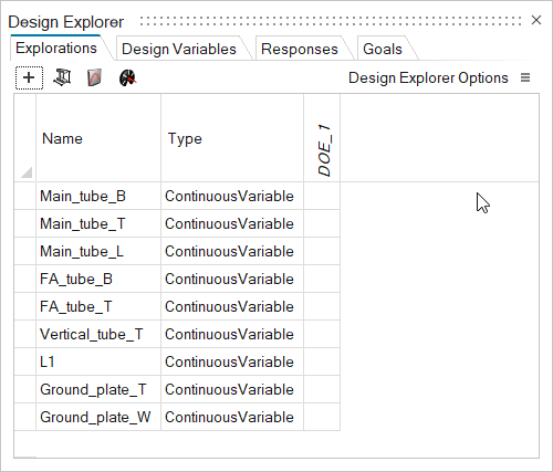

Create a DOE and Activate the Variables

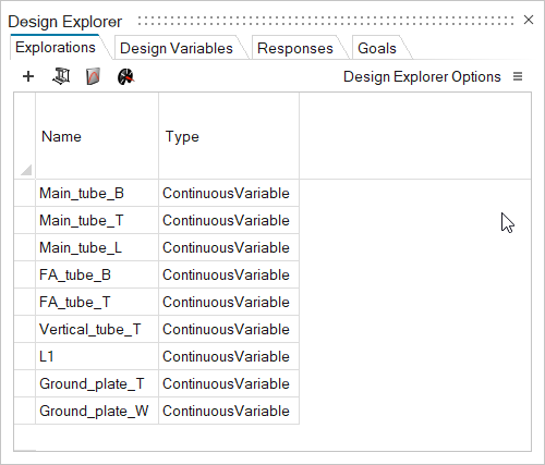

From the Design Explorer ribbon, select the Explorations
tool.
All geometric variables that are not linked to other variables are automatically converted to Design Variables.
On the Explorations tab, click + Add Exploration, and
then select DOE.
An active DOE is created.

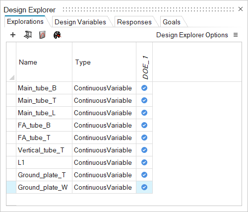

Under DOE_1, select the empty cells to activate all
variables.
- Close the Design Explorer dialog.

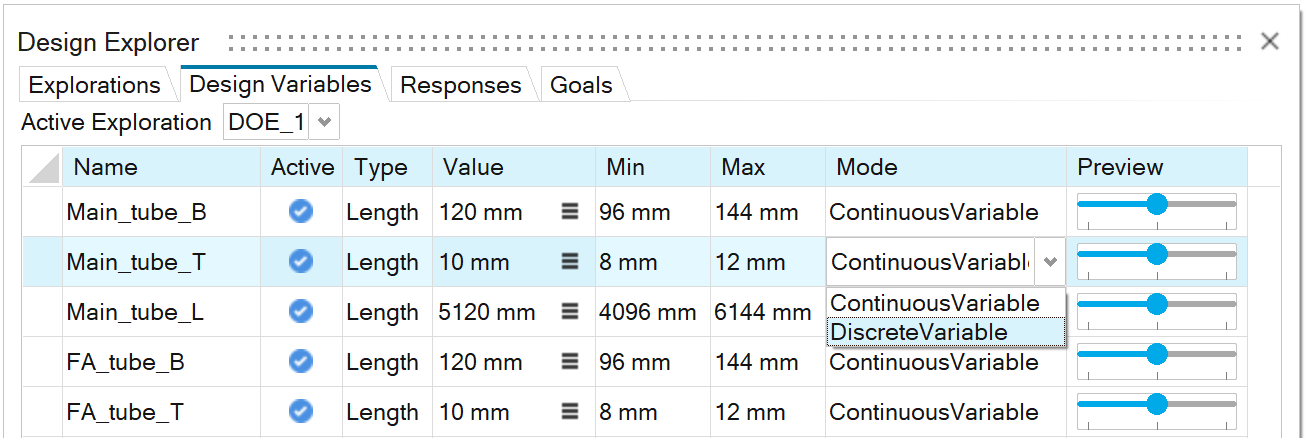

Expand the Design Explorer dialog so that the Mode and Preview columns are
visible. For Main_tube_T , change the
Mode to Discrete
Variable.

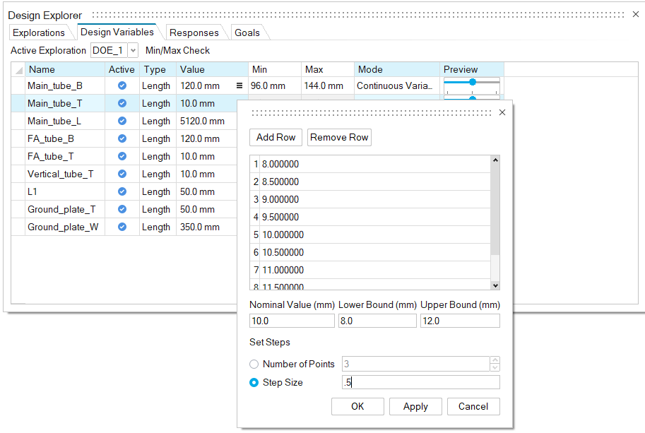

In the Main_tube_T row, Value
cell, select
for more options.
Turn on Step Size, and then enter
.5.
You have now set the Length of Main_tube_T to discrete increments of 0.5 mm between 8 and 12 mm. - Click OK.
.5.

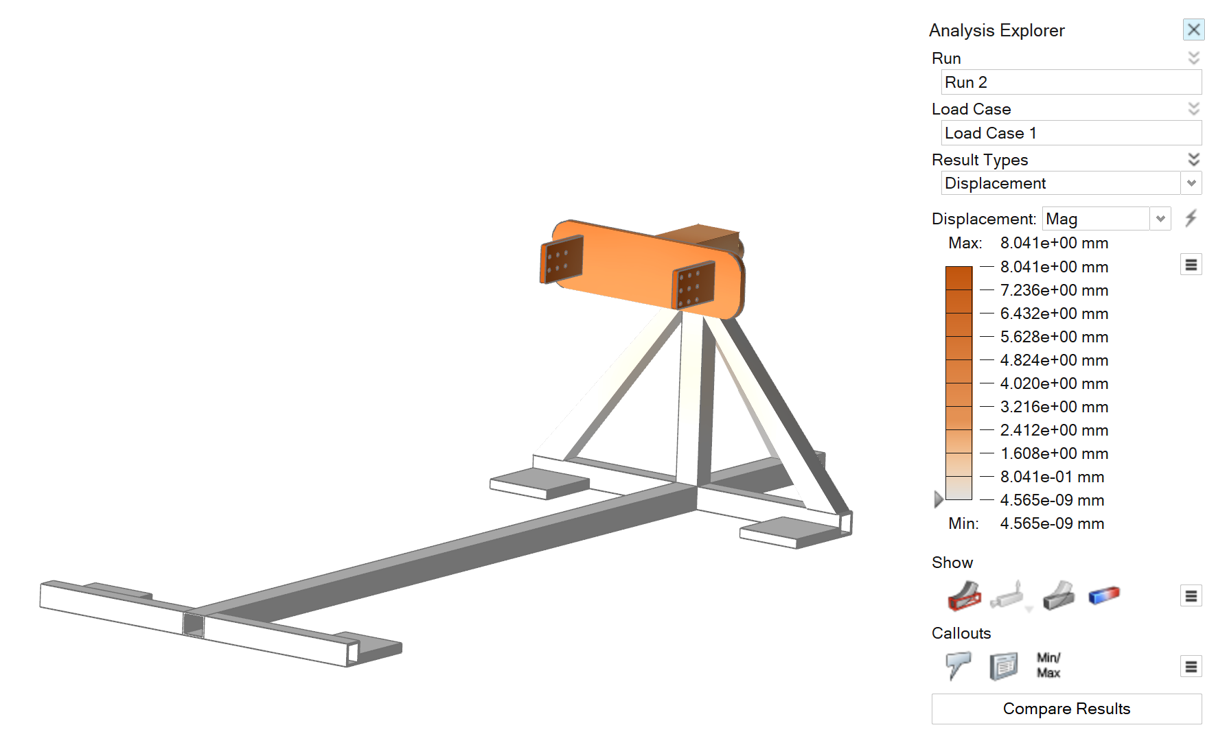

Review Completed Runs While the DOE Is in Progress
You can do the following:
To Do this Review run results In the Status column of the Run Status dialog, double-click a completed run. Display run errors In the Status column of the Run Status dialog, mouse over a failed run to display a possible error message. Review error logs In the Run Status dialog, right-click a failed run, and then select Open Run Folder.

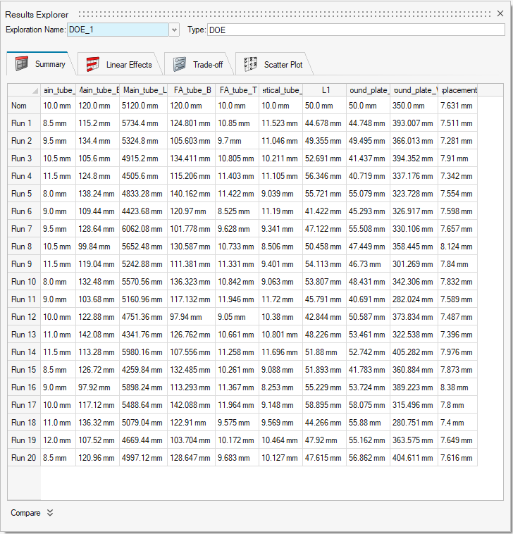

Select the Summary Table
tab.
The Summary Table shows a run-by-run summary of the exploration. The columns show the input design variable values for each run and the corresponding response values. For more information, see Summary Table. -

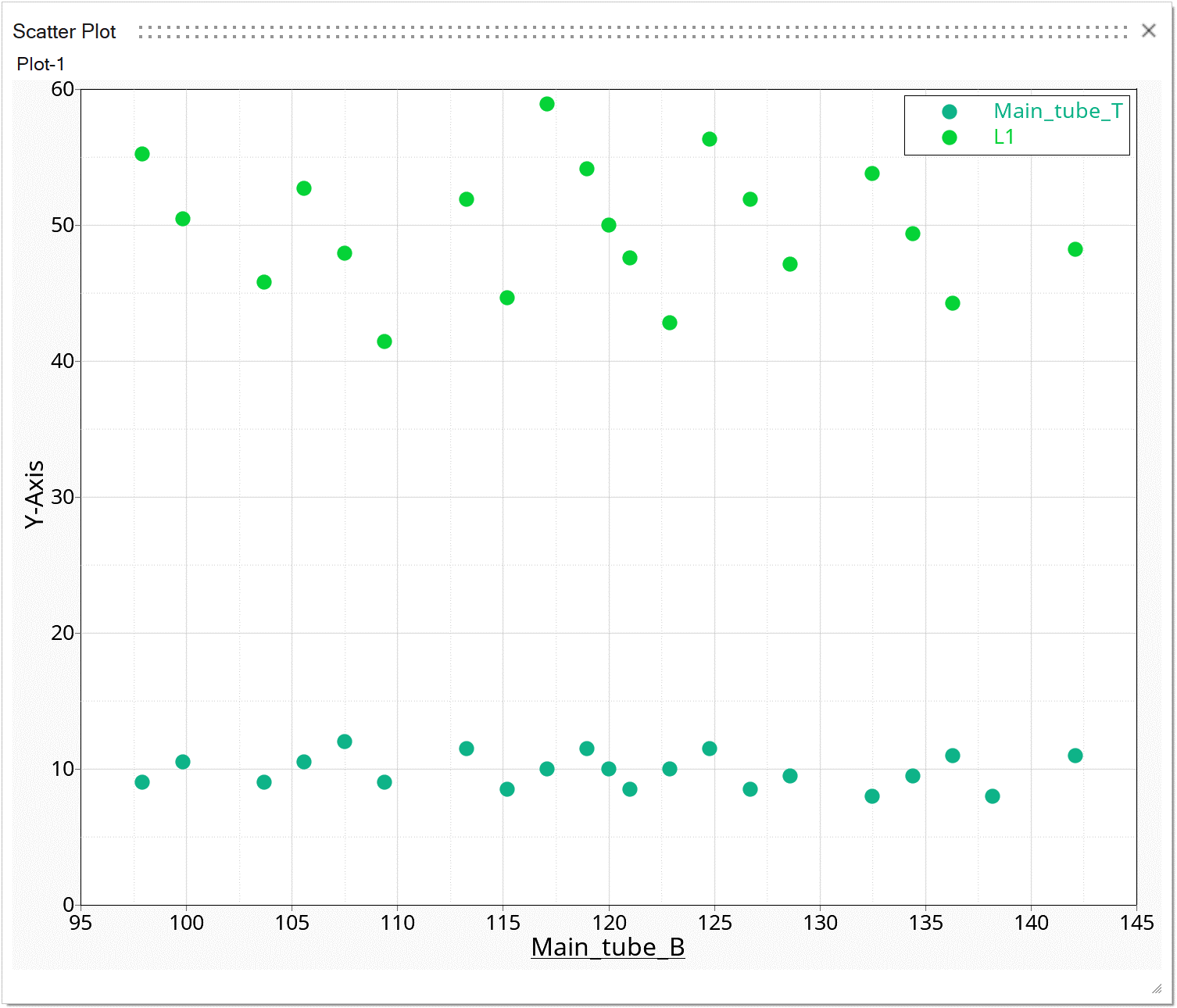

Select the Scatter Plot
tab.
A scatter plot is a 2-dimensional plot showing trends or relationships between variables. For more information, see Scatter Plots.
