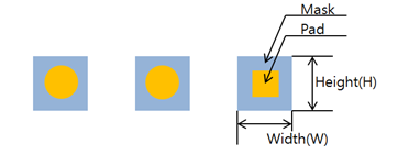

- PCB Mark definition: Define the PCB marks in the design.
- Component Group Selection: If the PCB mark is designed with a
component, specify the component group.
- Mask(S/R) Size (SS): Set the PCB mark with the outer mask size.
- PAD Size (PS): Set the PCB mark with the inner pad size.
- Recognize conductive figure shape as Pad: Recognize an object that is drawn with the figure shape in the conductive layer as a Pad.
- Board Figure Geometries: If the PCB mark is defined with board
figure geometries, specify the size of the pad and mask sizes.
- Mask1(S/R) Size (SS): Set the PCB mark with the outer mask size.
- PAD1 Size (PS): Set the PCB mark with the inner pad size.
- Mask2(S/R) Size (SS): Set the PCB mark with the outer mask size.
- PAD2 Size (SS): Set the PCB mark with the inner pad
size.

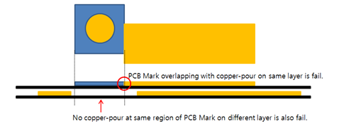

- Copper Existence Check: Use PollEx DFM to
check copper-pours at the same region of the PCB mark. On the same
layer, copper-pour cannot be overlapped with the PCB mark, but on
other layers, there should be copper-pour around the PCB mark.
Figure 2. - Placement: Check the placement status of the PCB mark.

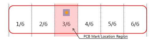

- PCB Mark Existence:
- Normal Checking:
- Number of PCB Region: Give the number of regions to divide the PCB.
- PCB Mark Existing Region: Set the region where the
PCB mark is located..
Figure 3.
- Detail Checking:
- The Long Size of PCB: Input the value of a long size range of the PCB.
- Criteria for Count: Select an inequality sign for checking the PCB mark count.
- Minimum Count per Area: Input the minimum number of PCB Marks that should exist in the checking area.
PCB Mark is placed.
Figure 4. - Number of PCB Region: Set the number of regions to divide the PCB.
- PCB Mark Existing Region: Set the region where the PCB mark is located.
