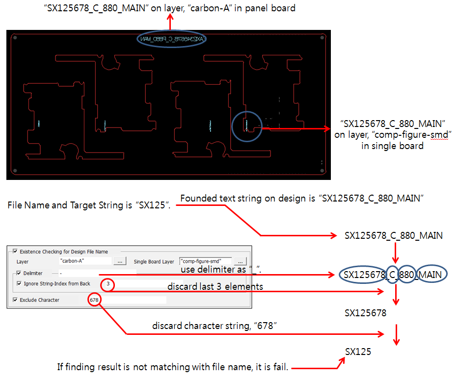

- Existence Checking for Design File Name
Figure 1.- Layer Selection: Select the panel layer in which the file name should be located.
- Single Board Layer: Select the single layer in which the file name should be located.
- Delimiter: Specify the delimiter, dividing file name containing
string into several parts.
- Number of strings excluded from right: Set the number of strings to exclude from the right side of the design file name.
- Number of strings excluded from left: Set the number of strings to exclude from the left side of the design file name.
- Exclude Character: At target text string, you can discard another character string. Target text string will be changed here, also.
- Except Checking for Empty Sub Board: Option to exclude the empty Sub Board on the design file name existence checking.
