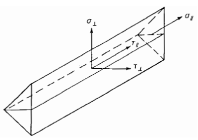

    相当応力は以下の式に基づいて計算されます。(1) σ 2 + 3 ( τ 2 + τ 2 ) 0.5 MathType@MTEF@5@5@+= feaahqart1ev3aaatCvAUfeBSjuyZL2yd9gzLbvyNv2CaerbuLwBLn hiov2DGi1BTfMBaeXatLxBI9gBaerbd9wDYLwzYbItLDharqqtubsr 4rNCHbGeaGqiVu0Je9sqqrpepC0xbbL8F4rqqrFfpeea0xe9Lq=Jc9 vqaqpepm0xbba9pwe9Q8fs0=yqaqpepae9pg0FirpepeKkFr0xfr=x fr=xb9adbaqaaeGaciGaaiaabeqaamaabaabaaGcbaWaamWaaeaacq aHdpWCdaWgaaWcbaaccaGae8xPI4fabeaakmaaCaaaleqabaGaaGOm aaaakiabgUcaRiaaiodacaGGOaGaeqiXdq3aaSbaaSqaaiab=vQiEb qabaGcdaahaaWcbeqaaiaaikdaaaGccqGHRaWkcqaHepaDdaWgaaWc baGaeSyjIafabeaakmaaCaaaleqabaGaaGOmaaaakiaacMcaaiaawU facaGLDbaadaahaaWcbeqaaiaaicdacaGGUaGaaGynaaaaaaa@4B65@ 相当応力は、計算された基準値よりも小さくなければなりません。EN 1993-1-8 Eurocode 3に基づく例では、以下の式が得られます。(2) σ 2 +3( τ 2 + τ 2 ) 0.5 f u /( β w γ M2 ) MathType@MTEF@5@5@+= feaahqart1ev3aaatCvAUfeBSjuyZL2yd9gzLbvyNv2CaerbuLwBLn hiov2DGi1BTfMBaeXatLxBI9gBaerbd9wDYLwzYbItLDharqqtubsr 4rNCHbGeaGqiVu0Je9sqqrpepC0xbbL8F4rqqrFfpeea0xe9Lq=Jc9 vqaqpepm0xbba9pwe9Q8fs0=yqaqpepae9pg0FirpepeKkFr0xfr=x fr=xb9adbaqaaeGaciGaaiaabeqaamaabaabaaGcbaWaamWaaeaacq aHdpWCdaWgaaWcbaaccaGae8xPI4fabeaakmaaCaaaleqabaGaaGOm aaaakiabgUcaRiaaiodacaGGOaGaeqiXdq3aaSbaaSqaaiab=vQiEb qabaGcdaahaaWcbeqaaiaaikdaaaGccqGHRaWkcqaHepaDdaWgaaWc baGaeSyjIafabeaakmaaCaaaleqabaGaaGOmaaaakiaacMcaaiaawU facaGLDbaadaahaaWcbeqaaiaaicdacaGGUaGaaGynaaaakiabgsMi JkaadAgadaWgaaWcbaGaamyDaaqabaGccaGGVaGaaiikaiabek7aIn aaBaaaleaacaWG3baabeaakiabeo7aNnaaBaaaleaacaWGnbGaaGOm aaqabaGccaGGPaaaaa@5789@ ここで、
    σ MathType@MTEF@5@5@+= feaahqart1ev3aaatCvAUfeBSjuyZL2yd9gzLbvyNv2CaerbuLwBLn hiov2DGi1BTfMBaeXatLxBI9gBaerbd9wDYLwzYbItLDharqqtubsr 4rNCHbGeaGqiVu0Je9sqqrpepC0xbbL8F4rqqrFfpeea0xe9Lq=Jc9 vqaqpepm0xbba9pwe9Q8fs0=yqaqpepae9pg0FirpepeKkFr0xfr=x fr=xb9adbaqaaeGaciGaaiaabeqaamaabaabaaGcbaGaeq4Wdm3aaS baaSqaaiabgwQiEbqabaaaaa@3993@
    スロートに垂直な法線応力
    τ MathType@MTEF@5@5@+= feaahqart1ev3aaatCvAUfeBSjuyZL2yd9gzLbvyNv2CaerbuLwBLn hiov2DGi1BTfMBaeXatLxBI9gBaerbd9wDYLwzYbItLDharqqtubsr 4rNCHbGeaGqiVu0Je9sqqrpepC0xbbL8F4rqqrFfpeea0xe9Lq=Jc9 vqaqpepm0xbba9pwe9Q8fs0=yqaqpepae9pg0FirpepeKkFr0xfr=x fr=xb9adbaqaaeGaciGaaiaabeqaamaabaabaaGcbaGaeqiXdq3aaS baaSqaaiabgwQiEbqabaaaaa@3995@
    溶接軸に垂直なせん断応力(スロート面内)
    τ MathType@MTEF@5@5@+= feaahqart1ev3aaatCvAUfeBSjuyZL2yd9gzLbvyNv2CaerbuLwBLn hiov2DGi1BTfMBaeXatLxBI9gBaerbd9wDYLwzYbItLDharqqtubsr 4rNCHbGeaGqiVu0Je9sqqrpepC0xbbL8F4rqqrFfpeea0xe9Lq=Jc9 vqaqpepm0xbba9pwe9Q8fs0=yqaqpepae9pg0FirpepeKkFr0xfr=x fr=xb9adbaqaaeGaciGaaiaabeqaamaabaabaaGcbaGaeqiXdq3aaS baaSqaaiablwIiqbqabaaaaa@390C@
    溶接軸に平行なせん断応力(スロート面内)。
    Eurocodeの例に基づいて計算された基準値については、以下の用語が使用されています、
    f u MathType@MTEF@5@5@+= feaahqart1ev3aaatCvAUfeBSjuyZL2yd9gzLbvyNv2CaerbuLwBLn hiov2DGi1BTfMBaeXatLxBI9gBaerbd9wDYLwzYbItLDharqqtubsr 4rNCHbGeaGqiVu0Je9sqqrpepC0xbbL8F4rqqrFfpeea0xe9Lq=Jc9 vqaqpepm0xbba9pwe9Q8fs0=yqaqpepae9pg0FirpepeKkFr0xfr=x fr=xb9adbaqaaeGaciGaaiaabeqaamaabaabaaGcbaGaamOzamaaBa aaleaacaWG1baabeaaaaa@3804@
    弱い方の接合部の公称引張強度
    β w MathType@MTEF@5@5@+= feaahqart1ev3aaatCvAUfeBSjuyZL2yd9gzLbvyNv2CaerbuLwBLn hiov2DGi1BTfMBaeXatLxBI9gBaerbd9wDYLwzYbItLDharqqtubsr 4rNCHbGeaGqiVu0Je9sqqrpepC0xbbL8F4rqqrFfpeea0xe9Lq=Jc9 vqaqpepm0xbba9pwe9Q8fs0=yqaqpepae9pg0FirpepeKkFr0xfr=x fr=xb9adbaqaaeGaciGaaiaabeqaamaabaabaaGcbaGaeqOSdi2aaS baaSqaaiaadEhaaeqaaaaa@38BC@
    適切な相関係数
    図 1.
