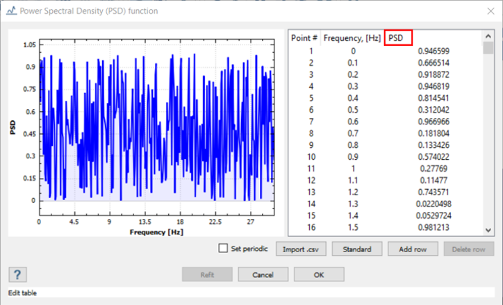

  8. For a random response analysis, the Power Spectral Density (PSD) of the response S x o ( f ) MathType@MTEF@5@5@+= feaahqart1ev3aaatCvAUfeBSjuyZL2yd9gzLbvyNv2CaerbuLwBLn hiov2DGi1BTfMBaeXatLxBI9gBaerbd9wDYLwzYbItLDharqqtubsr 4rNCHbGeaGqiVu0Je9sqqrpepC0xbbL8F4rqqrFfpeea0xe9Lq=Jc9 vqaqpepm0xbba9pwe9Q8fs0=yqaqpepae9pg0FirpepeKkFr0xfr=x fr=xb9adbaqaaeGaciGaaiaabeqaamaabaabaaGcbaGaam4uamaaBa aaleaacaWG4bGaam4BaaqabaGccaGGOaGaamOzaiaacMcaaaa@3B36@ , is related to the power spectral density of the source, S a ( f ) MathType@MTEF@5@5@+= feaahqart1ev3aaatCvAUfeBSjuyZL2yd9gzLbvyNv2CaerbuLwBLn hiov2DGi1BTfMBaeXatLxBI9gBaerbd9wDYLwzYbItLDharqqtubsr 4rNCHbGeaGqiVu0Je9sqqrpepC0xbbL8F4rqqrFfpeea0xe9Lq=Jc9 vqaqpepm0xbba9pwe9Q8fs0=yqaqpepae9pg0FirpepeKkFr0xfr=x fr=xb9adbaqaaeGaciGaaiaabeqaamaabaabaaGcbaGaam4uamaaBa aaleaacaWGHbaabeaakiaacIcacaWGMbGaaiykaaaa@3A2B@ , by:(11)
    S x o ( f ) = H x a ( f ) 2 S a ( f ) MathType@MTEF@5@5@+= feaahqart1ev3aaatCvAUfeBSjuyZL2yd9gzLbvyNv2CaerbuLwBLn hiov2DGi1BTfMBaeXatLxBI9gBaerbd9wDYLwzYbItLDharqqtubsr 4rNCHbGeaGqiVu0Je9sqqrpepC0xbbL8F4rqqrFfpeea0xe9Lq=Jc9 vqaqpepm0xbba9pwe9Q8fs0=yqaqpepae9pg0FirpepeKkFr0xfr=x fr=xb9adbaqaaeGaciGaaiaabeqaamaabaabaaGcbaGaam4uamaaBa aaleaacaWG4bGaam4BaaqabaGccaGGOaGaamOzaiaacMcacqGH9aqp daabdaqaaiaadIeadaWgaaWcbaGaamiEaiaadggaaeqaaOGaaiikai aadAgacaGGPaaacaGLhWUaayjcSdWaaWbaaSqabeaacaaIYaaaaOGa am4uamaaBaaaleaacaWGHbaabeaakiaacIcacaWGMbGaaiykaaaa@49B3@
    Where, H x a ( f ) MathType@MTEF@5@5@+= feaahqart1ev3aaatCvAUfeBSjuyZL2yd9gzLbvyNv2CaerbuLwBLn hiov2DGi1BTfMBaeXatLxBI9gBaerbd9wDYLwzYbItLDharqqtubsr 4rNCHbGeaGqiVu0Je9sqqrpepC0xbbL8F4rqqrFfpeea0xe9Lq=Jc9 vqaqpepm0xbba9pwe9Q8fs0=yqaqpepae9pg0FirpepeKkFr0xfr=x fr=xb9adbaqaaeGaciGaaiaabeqaamaabaabaaGcbaGaamisamaaBa aaleaacaWG4bGaamyyaaqabaGccaGGOaGaamOzaiaacMcaaaa@3B1D@ is the frequency response function.
    For better understanding, let us take an example of base excitation with acceleration as the excitation type as an input to a random response analysis.
    The base excitation with amplitude is used to define the input for frequency response analysis, so the units of the acceleration excitation type would be either of below highlighted units, m/sec2; mm/sec2; cm/sec2; G; in/sec2
    Units for the PSD function depend on the boundary condition. In this example, as base excitation is given as acceleration, the unit for PSD will be (mm/s2)2/Hz.
