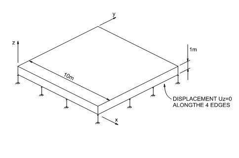

Test No. VM06 Determine the first twelve modes and frequencies for a simply supported thick square plate.

The plate has three rigid body modes with zero frequencies. Vertical constraints are applied not at the middle plane of the plate, but to the lower edges. This does not allow for clear separation of out-of-plane and in-plane vibration modes. Also, in full 3D formulation constrained edges introduce stress singularity into the solution.
- The reference solution has a very rough FEA mesh with just a few elements. Mesh lines orientation and incompleteness of basis functions of iso-parametric elements results in artificial “anisotropy” of the approximation.
 - Vertical constraints are applied not at the middle plane of the plate, but to the lower edges. This does not allow for clear separation of out-of-plane and in-plane vibration modes. This separation in NAFEMS results is because a very crude approximation is used. Also, in full 3D formulation the constrained edges are the source of a strong singularity in the solution.
 - The High Order Element (HOE) solution has only one layer of elements across thickness with quadratic basic functions. Quadratic functions do not capture bending (you need 3rd order functions). The Low Order Element (LOE) solution has three layers of bricks across the thickness, but the basis functions are linear incomplete polynomials which also do not capture bending.
